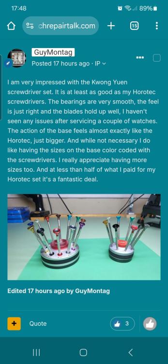

Hey, thanks for pointing out these "European-style blades"!
How about these?
Hi, I have done some research on these and the problem is the following:
Shipping is almost as expensive as a screwdriver set to my country. And If I'm gonna pay that much I can also go with Bergeon ones.
