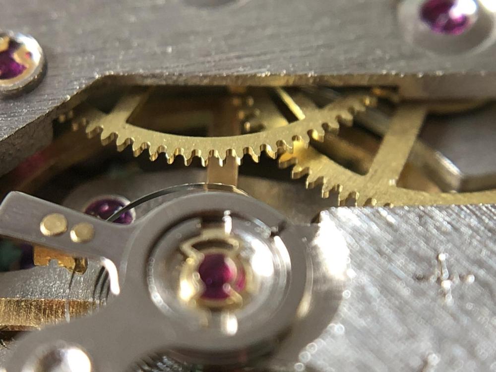

I recently serviced this Raketa 2609.HA, and overall, I’m very happy with the results. The timing machine shows a straight graph, and the amplitude is strong in all positions—both fully wound and after 24 hours.
However, I’ve noticed an unusual issue. When the mainspring is wound to about 2/3 or more, the movement starts behaving erratically in the dial-up and dial-down positions—but only when the amplitude reaches 295 degrees and above. In contrast:
  • In all four vertical positions, it runs perfectly, regardless of the power reserve.
  • In horizontal positions, it also runs fine as long as the amplitude is below 295 degrees (i.e., when it’s not fully wound).
I encountered a similar issue with another Raketa 2609.HA, where too much shellac on the entry pallet stone collided with the centre wheel when fully wound. However, that doesn’t seem to be the problem here.
At first, I suspected re-banking, but after listening carefully, I didn’t hear the characteristic galloping sound. The only visible anomaly is the hairspring—the coils appear to be slightly bundled on one side. Could this be causing coil-to-coil contact and how bad is that?
Additional Observations
In this video, the mainspring is only 2/3 wound, and the timing graph looks perfect.
In this video, the mainspring is fully wound (I really can't see any difference from the previous video, which is a bit concerning).
If the hairspring is the issue, I’d appreciate any hands-on guidance. I know you experienced watch repairers often adjust it in situ, whereas enthusiasts like me tend to overthink and remove it before making adjustments. I’m open to either approach—whatever it takes!

While I am by no means a hairspring master like Neven, I don't see anything wrong with your hairspring. The terminal coil does seem to be closer (or even touching) the outer regulating pin, though. Hence, Neven's suggestion, no ? But I would not expect it to be the source of the behaviour you show on the TG.
Before bending anything, maybe check two things:
1. Verify amplitude visually with super slow-mo video when the strange behaviour is occurring. Maybe the lift angle is somehow wrong (I can see that you put the usual 42° that it should be, but maybe it has been altered be a previous watch destroyer). I would still see rebanking as the No1 suspect. Everything seems to point there.
2. How did you clean the hairspring? Any chance that the coils are sticking a bit when they touch at high amplitude? I've seen the coils come extremely close in my recent Vostok, but it didn't impact the rate/timegrapher readings. I've also had cases (particularly with Russian watches) where old/contaminated degreaser led to sticky coils.
At high amplitude the coils are clearly touching near the end of the terminal curve, which would explain your timegrapher plot. You can see the much narrower gap where I've put the arrows compared to the bottom of the spring.
Pressing where Nev suggests should open the gap. If not, just tweak it until the gap looks even.

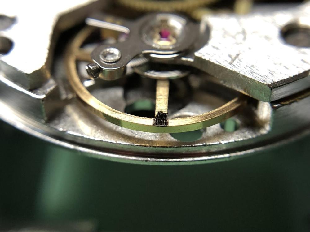

I certainly didn't hear a galloping sound, so I didn't suspect re-banking. Anyway, to make sure, I decided to make a mark on the balance rim at 180 degrees opposite its resting position to manually determine the lift angle, and it would seem it is closer to 46 than 42 degrees. BTW, apologies for the background noise in the videos!
After this, I made another mark 180 degrees opposite the first mark (balance in its resting position). I then wound the mainspring fully and recorded the video. I don't think it is re-banking. Then again, the fork horns are quite wide. I find it very difficult to tell. What do you think? Remember, I can't hear a galloping sound 🤔
Does the tweaking of the hairspring look good enough now, or does it need more tweaking? I'm sure I'm using the original mainspring (T-shaped bridle). Perhaps move the pallets out a bit? Then why should I if it's not re-banking?
I'm out of ideas of where to go from here.

 The amplitude looks to be about 320 degr.  If You need to know if it is rebanking, then force it by adding torque winding by the crown and holding after the full wind, if the amplitude can rise more than what it is on the video, then still not rebanking.

As I actually don't expect this to be real rebanking, will try to say what else it can be. The hairspring of 2609HA has small gaps between coils. This brings to danger when the spring is wound (shrank) to the maximum balance amplitude the coils to touch or get very close to touching. More, the spring can vibrate (ring) and this will cause coils to touch when they are close. Now, What we can do is to try to better center the spring but not in rest position - in the max shrank position. AND, decrease the ability (the main reason) for ringing  by closing the distance between regulator pins as much as possible so no free play to be at all and still the spring not to get stuck when moving regulator. On the video, there is hairspring ringing, this is well seen when the playback speed is reduced
Thanks for your insight and advice! Much appreciated! 👍
I’m having trouble seeing the vibration (ringing), probably because I don’t know what to look for. In which video is the vibration most visible? Does the vibration occur sideways or vertically, or maybe both? In short, what should I be looking for?
How do you do that in practice? I assume that by "max shrank position," you mean when the hairspring is at its most compressed, that is, when the coils are closest to each other, yes?
That’s also something I find unclear in terms of how it should be done. As far as I understand it, the index pin should always be parallel to the boot.
Here is my attempt at illustrating how I interpret your description of what needs to be done. Is this correct?
If so, I’m also wondering how this is done in practice. Do you first bend the regulator pin at its attachment point under the arm and then bend it back slightly lower down, towards the anti-shock setting?
Practical advice on how to proceed would be greatly appreciated!
