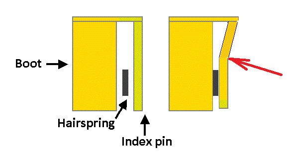

How do you do that in practice? I assume that by "max shrank position," you mean when the hairspring is at its most compressed, that is, when the coils are closest to each other, yes?
That’s also something I find unclear in terms of how it should be done. As far as I understand it, the regulator pin should always be parallel to the boot.
Here is my attempt at illustrating how I interpret your description of what needs to be done. Is this correct?
If so, I’m also wondering how this is done in practice. Do you first bend the regulator pin at its attachment point under the arm and then bend it back slightly lower down, towards the anti-shock setting?
Practical advice on how to proceed would be greatly appreciated!

Yes, I mean centering the spring when it is most compressed. Turn the balance to the end and will see that now the spring is not centered. This is normal, but try to center it better in this position, regardless what it will look like in rest position.
The regulator will rather look like this. Press where the red arrow is in the presence of the spring, this will more or less make it look like on the picture

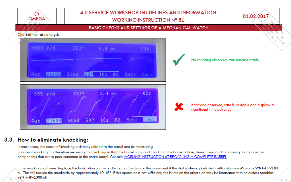

An easier fix, and one that doesn't involve physical changes, is what Omega suggest in a working sheet I have: replace the oil in the balance jewel on the dial side with HP1300. It suggests that will knock about 10-15° off. If that's not sufficient, do the same on the other jewel.
I have always started by oiling the pallet pivots, but that has not usually worked for me.
My first port in a case of rebanking would be a weaker mainspring. It's not always feasible though. Then, I would increase total lock either by moving the pallet stones or the bankings, whichever is easiest to implement. 0.005mm goes a long way here.
This extract is interesting. At first glance, it almost looks like an April Fool’s joke—it’s vague, talks about replacing the lubrication on the bridle, and recommends using colorless oil. The latter won’t be much help for the next person servicing it. Then again, red-colored oil would likely still be difficult to see against the red of the cap jewel. No matter how I look at it, I don’t see the extract explicitly recommending the use of HP-1300 on balance jewels. I’m curious—how did you reach that conclusion? I do understand that “bridle” is a typo and was meant to be “bridge.” Are you sure this extract is really from Omega?

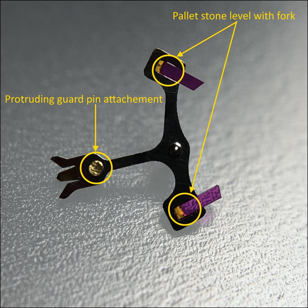

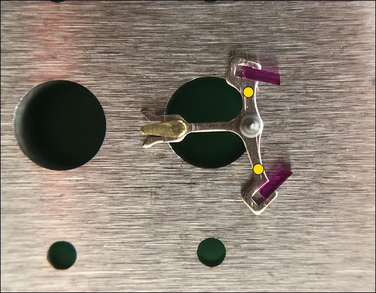

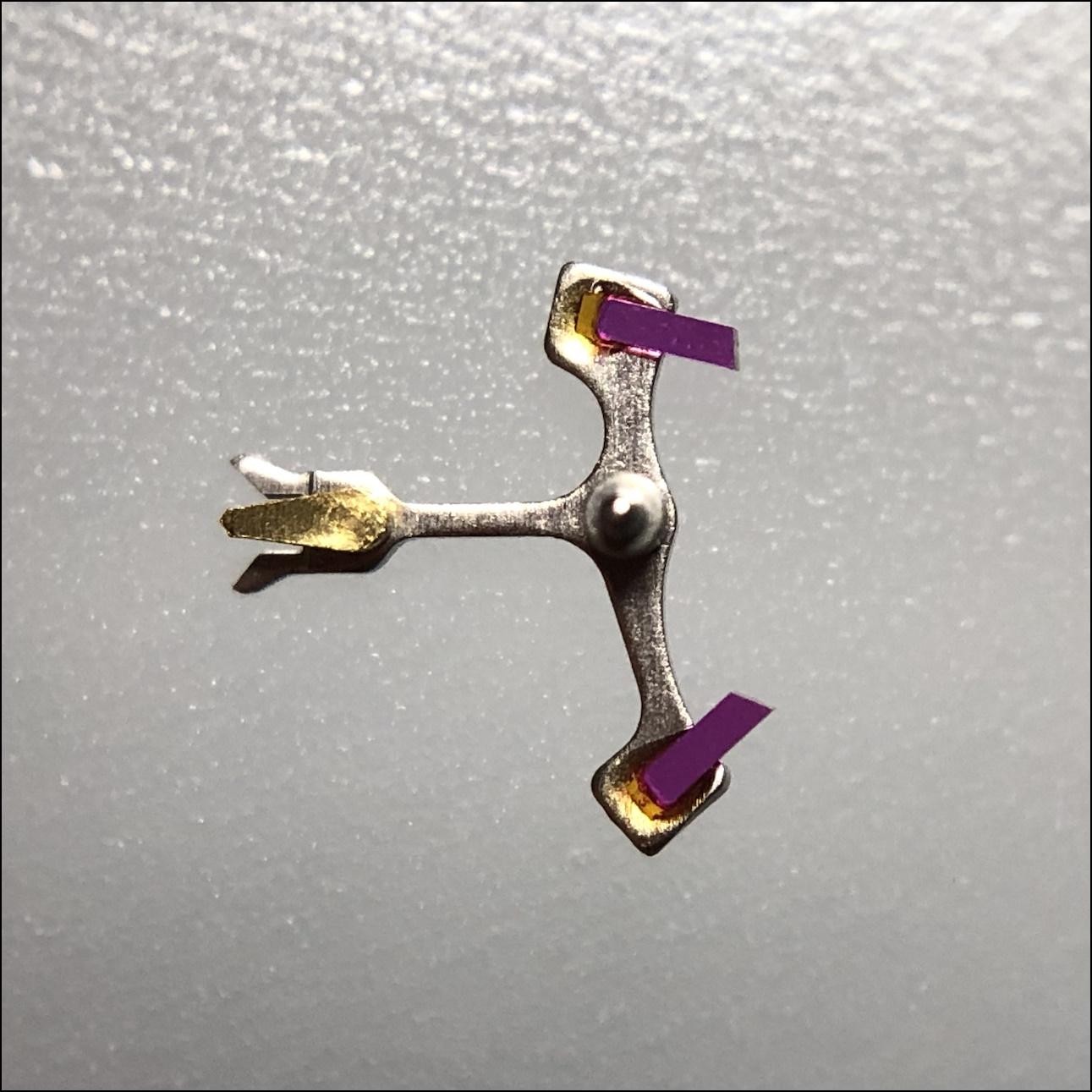

A small but useful trick I discovered this time was how to easily align the pallet stones flush with the top side of the pallet fork, something I’ve always found both fiddly and uncertain. Normally, this isn’t a major issue if the guard pin’s mounting doesn’t protrude above the pallet fork, but unfortunately, it does in this case.
I simply placed the pallet fork upside down in a suitably sized hole in a staking block. Then, it was just a matter of applying light pressure to the yellow points shown in the image. Quick and reliable! I always surprise myself when I come up with tricks like this, as my first instinct, unfortunately, is always to look for a Bergeon tool 😆
One thing to watch out for with this particular movement is not to build up a bump of shellac on top of the pallet stones when re-shellacking them. This mainly applies to the entry stone since it sits just above the perimeter of the center wheel, and the distance between them is extremely small. In other words, if too much shellac is applied to the entry stone, the risk of interference is quite high.
Yes it is from Omega. The language is odd - something lost in translation. After some discussion on this forum, we concluded that it only makes sense if it's the balance jewels that are being mentioned. I never like to alter a movement unless necessary. I see no problem in just changing the oil on the balance jewels if that fixes the problem. It's an easy fix with no change to movement parts necessary. The next time the watch is serviced, someone else may fit a new mainspring and find low amplitude. They've checked everything is correct, and cannot find the cause. Not realising someone has moved the pallet jewels 😲

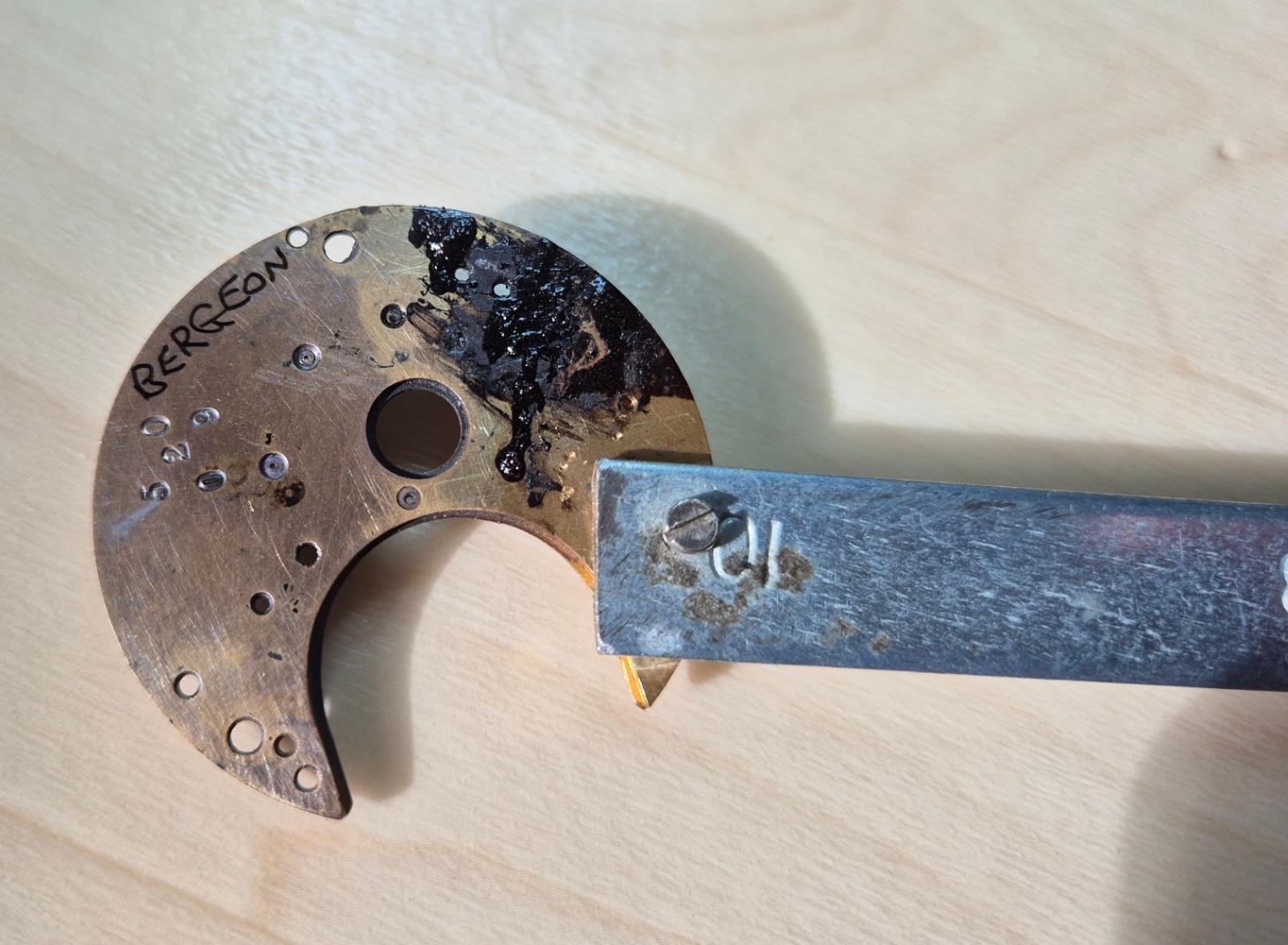

You need a Bergeon tool like mine @VWatchie 🤣 - just $5000 !
The thick brass heats evenly and stays hot whilst you apply shellac, and the holes are ideal for sitting pivots in.
  • Haha 3
