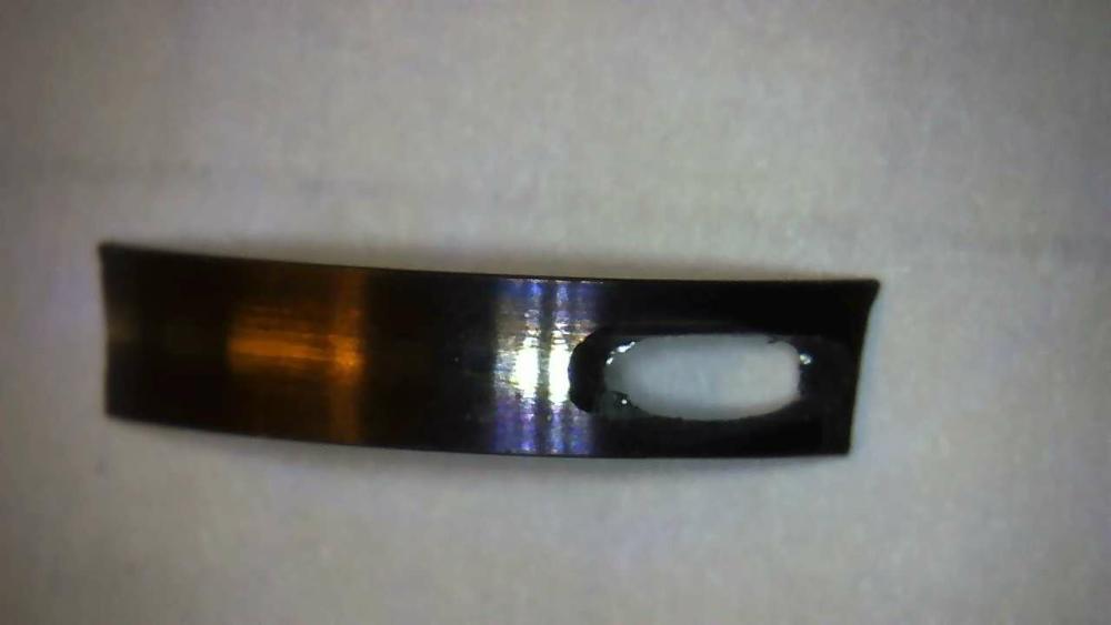

The spring is 2.9 x 0.2 x 611 mm, the barrel inside diameter is 20.8 mm.
The outside of the spring has a "T", spot welded to the main spring, the inside has a hole. The inner 80 mm or so part is broken off.
Failing to find a replacement spring I wonder if I can make a new inner ending for that broken spring. The broken 80 mm is about 13% of the total length of the spring.
One solution would be to grind a hole to the end of that spring with a Dremel tool. I would also need to "tighten up" the inside of the spring so it would catch with the arbor. I wonder if the tightening would lead to eventual spring breakage.
The other solution would be to anneal the inside of the spring and then make the hole and tighten the radius.
Any of these ideas viable? On the other hand I could not loose much by "ruining" this broken spring.

The mainspring repair is with more or less unpredictable result. Many times the result is good and long lasting, but often the spring breaks again with the first attempt for winding. Sometimes it will break after month or week. For sure, annealing of relatively long part when the internal end is broken is needed and annealing in many cases means heating to red and slowly retracting from the flame as just leaving the spring to cool in air may harden it again. Often people think that after shaping the internal end they must harden the spring. This is useless, wrong and it is impossible to harden the annealed part without leaving soft area between the rest of the spring and it.
My experience with Slava springs is not gathered with many cases, may be 2 or 3 and very long time ago. This clocks were produced long time and many changes of technology and materials were made, so can't make general conclusions. Parts for such clocks we have plenty here. But yes, I have tried (with old springs, made in 60-70s, brown temper color like the one on the picture) and came to the conclusion that this springs are wicked and it is bad idea to repair them. Possibly bad luck, but was not able to wind to the end without new breaking happening.

I did try to repair that broken main spring. I did manage to make the hole with a Dremel tool but the end snapped off as soon as I tried to tighten up the radius. I did not anneal the end of the spring though.
I am not surprised that the spring broke, it is quite brittle.
I enclose a picture of the broken off end with the new hole.
