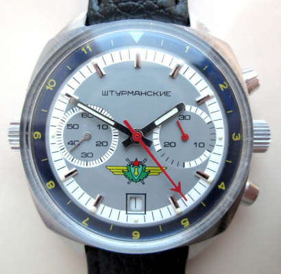

I keep looking for one of these Russian Slava tuning fork watches to be affordable. This one is the least expensive one listed right now . I can't understand the high price for a Russian watch like this , I got my Omega Constellation F300 tuning fork watch for about $360...
I have several with no complaints so far . The mechanical Slavas  have 2 winding barrels and a large balance wheel .  I also have a Sturmanskie Aviator chronograph  I really like .

@ ricardopalomino - I have a Shturmanskie very similar to yours. The dial is identical, but the case is different... And it uses the same Poljot 3133 movement. I've owned it since new, and it's one of my favorite watches.
Stroppy - I guess I like the Russian watches mainly because they're just different, and can be purchased pretty reasonably. I was born and grew up during the Cold War era, and Russia seemed distant and rather mysterious. I enjoy wearing a bit of Soviet history. Also, Russian technology of that era was fascinating; seemingly simple, but beautifully crafted and sturdy.
