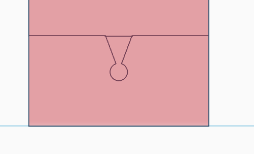

Judging by the picture of the replacement blades, the tip angle looks to be 26 degrees total included.  The goal here is to then create something which limits the length of screwdriver that you can insert into the sharpener, and which results in the screwdriver sitting at 13 degrees to the horizontal.  Without getting into the trigonometry, you need to extend the screwdriver about 30 mm from the sharpeners pivot point in order to reach 13 degrees.
I sketched it up in Tinkercad (attached picture).  The curvature of the sharpener fits onto the top, and the screwdriver points down.  There is a V-notch at the bottom that orients the blade so that you're always resharpening the existing faces of the blade, rather than having the blade rotated slightly, which would cause you to cut a new face.  And I'm happy to report that it worked extremely well, probably within 1 to 2 degrees of what I calculated.  The blades were sharpened precisely over the old face, and the end was perfectly perpendicular.
And that 1-2 degree error is not down to a lack of theory, but rather the realities of 3D printing; that you'll always get layer lines, and that corners can never be truly sharp.  I think what was happening is that in the initial version, the blade-orienting slot was designed as a sharp V-notch.  But since 3D printers can't print infinitely sharp slots, the screwdriver didn't fit into it exactly as intended.  So I made a follow up version (haven't tested it yet) that includes a small recess at the bottom of the V to allow the very end of the blade to fit in.
If you would like to try it, the file is available at https://drive.google.com/file/d/1mWjxi0HUs9jL55ysQaSV2xnyMiAOS29Y/view?usp=drive_link.  Just note that this was built to fit the Bergeon screwdriver sharpener.  Other brands might have different geometries which might result in different blade angles, though I don't think this will be so drastically different.

Great idea and will help in most cases, however the blade angle needs to change to fit the screw.  The blade should wedge in and not bottom out on the screw.
Thank you.  For the longest time I was using a set of cheapo Indian screwdrivers, which I had eventually swapped Bergeon blades into.  They never gave me a day of trouble with slotting into screws so I figured I'd just emulate what I already knew worked.
