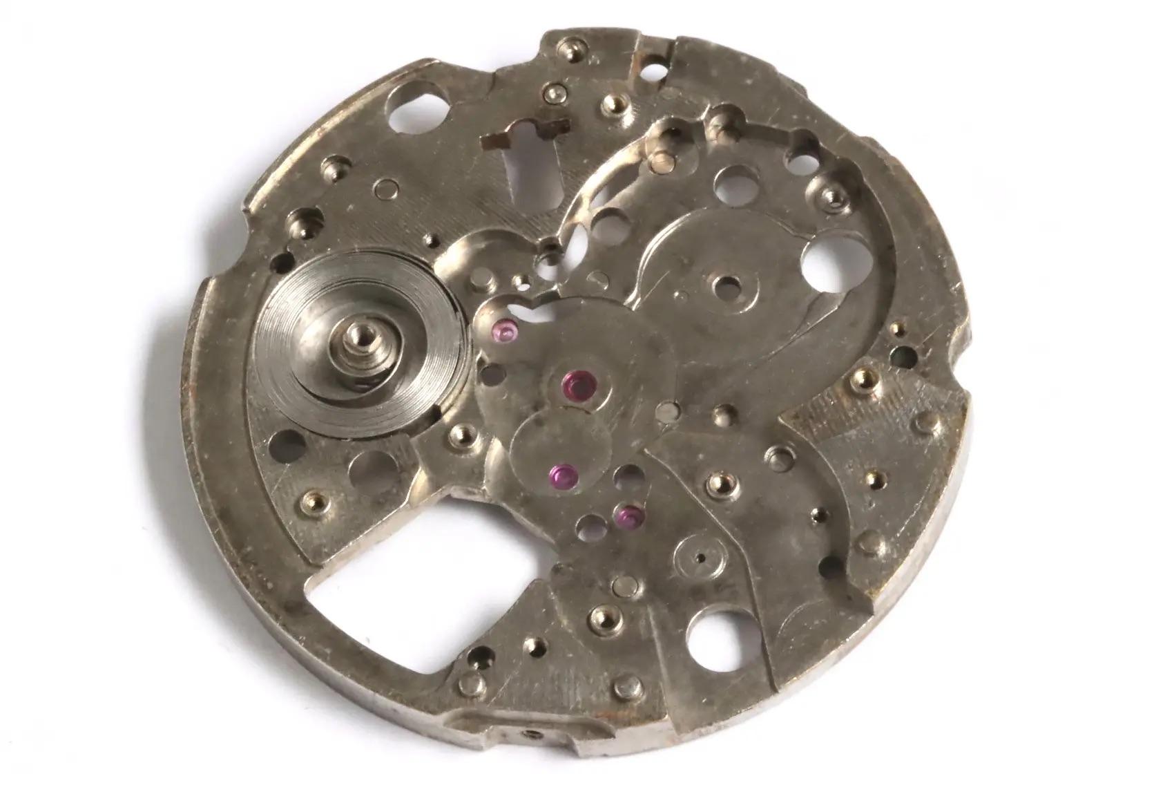

Hello everyone,
I recently started servicing my Seiko Bell-Matic 4006-6050 and, during the process, discovered that the alarm mainspring (part number 416805) is broken. I've searched extensively for a replacement but haven't been able to find one at a reasonable price.

Can you confirm the dimensions from the old one as I've got it as this being an equivalent.
I presume the ones on eBay are more than you want to pay.
Edit
I've also got another note saying anything 1.35 x 0.07/0.08 x 260+ being suitable.

Can you measure the old one to confirm?
54 minutes ago, mikepilk said:
As long as it fits, the dimensions aren't as crucial as the mainspring
Occur with mike , it is not as crucial as the mainspring, as its not a part of time keeping gear. Furthermore, doesn't have to be a new spring.
Then 6050 is refference No for the case, unrelated to the movement's  caliber.
Rgds
Hi,
I restored a Bell-Matic in 2023 and used the spring Andy suggested "GR40187" for the alarm spring which was purchased from Cousins in the UK
I did have an small issue which was overcome, I think it was the arbour was a lot larger than the eyelet in the aftermarket spring.
TIP: don't forget the install the washer part no: 419.805 before installing the spring

Update on Seiko Bell-Matic 4006-6050 Alarm Mainspring Replacement
Hello everyone,
I want to extend a heartfelt thanks to everyone who offered advice and assistance regarding my search for a replacement alarm mainspring (part number 416805) for my project. Your support and insights were incredibly valuable. I managed to acquire a 4006 main base, which includes the alarm spring already installed. This solution will allow me to proceed with my servicing project effectively. I sincerely appreciate your help.
Once again, thank you all for your contributions and support. It's wonderful to be part of such a knowledgeable and supportive community.
