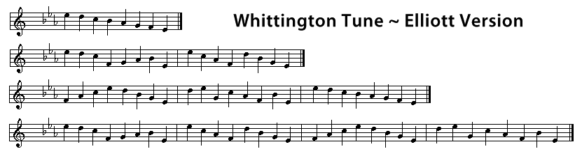

First off the clock in question is a platform escapement Elliot Westminster Whittington,  Ok here goes, so I'm happy with the quarter which is where I'm trying to be ie 87654321 sequence,  so my sequences are as follows ( hammer 8 is the  dial side and hammer 1 is the rear plate one if that makes sense )
87642531
86547321
45687321
78265431
87635241
87642531
86547321
I know Elliot had there own version of the Whittington tune, is anyone able to educate me on whether any of my sequence's above relate to the quarter past signal please?
Am I correct that its the 87642531?  many thanks

Mike, Yes happy to do that, but the chime rods are in the case ( grand daughter clock ) with the customer. As Elliot have their own sequence I was wondering what one is what, as you say 87654321 does appear twice on the list, just need to correspond that to the Westminster side of the notes.

It's 87635241.

Here you can match the chimes to the rods - I make it 87635241. I think the appearance of a sequence twice in the original post is simply repetition since there will only be five sequences on the barrel.

Rixy, huge thanks for your time in posting the video, I have an idea that someone previous to me has had the chime barrel apart maybe and not got the sequence correct, I have another one coming in for a click repair later this week so can compare that to your video and to mine to see what one/ones are running the correct sequence.

Still, if the 87635241 sequence exists on your barrel, you can be fairly sure it's okay and you just have to set it correctly. I think you are already aware that Elliott clocks play a version of Whittington that is slightly different from other makers. I can send you a clip of the whole sequence if you want (now I know how to do it!).

Rixy, if you could send me a video of the whole sequence that would be great, Firstly, whats the sequence of the quarter past for the Westminster? as we know its descending, again as my sequence on the whittington  is 87635241 my Westminster isn't 4321, so if I could see a video of yours that would be helpful before i have to pull apart the barrel.

Hi Transporter,
I will record the chimes for you today but in the meantime, I calculate the first quarter on Westiminster to be 6351.
I don't know why Elliott chime bars are not arranged in a straightforward ascending order- it would be much simpler! Maybe someone out there has the answer.
Here they are:
1. Whittington halfpast
2. Whittington quarter-to
3. Whittington o'clock
4. Westminster quarter-past
Hope it helps. If I have missed anything, give me a shout.
BtW I've worked out why the rods are mixed up. It's because the hour strike hits the last three rods and they need to play a chord (eg C-E-G) - a pleasant sound. If the rods were in order it would hit the first three notes (eg C-D-E) - an unpleasant sound!
