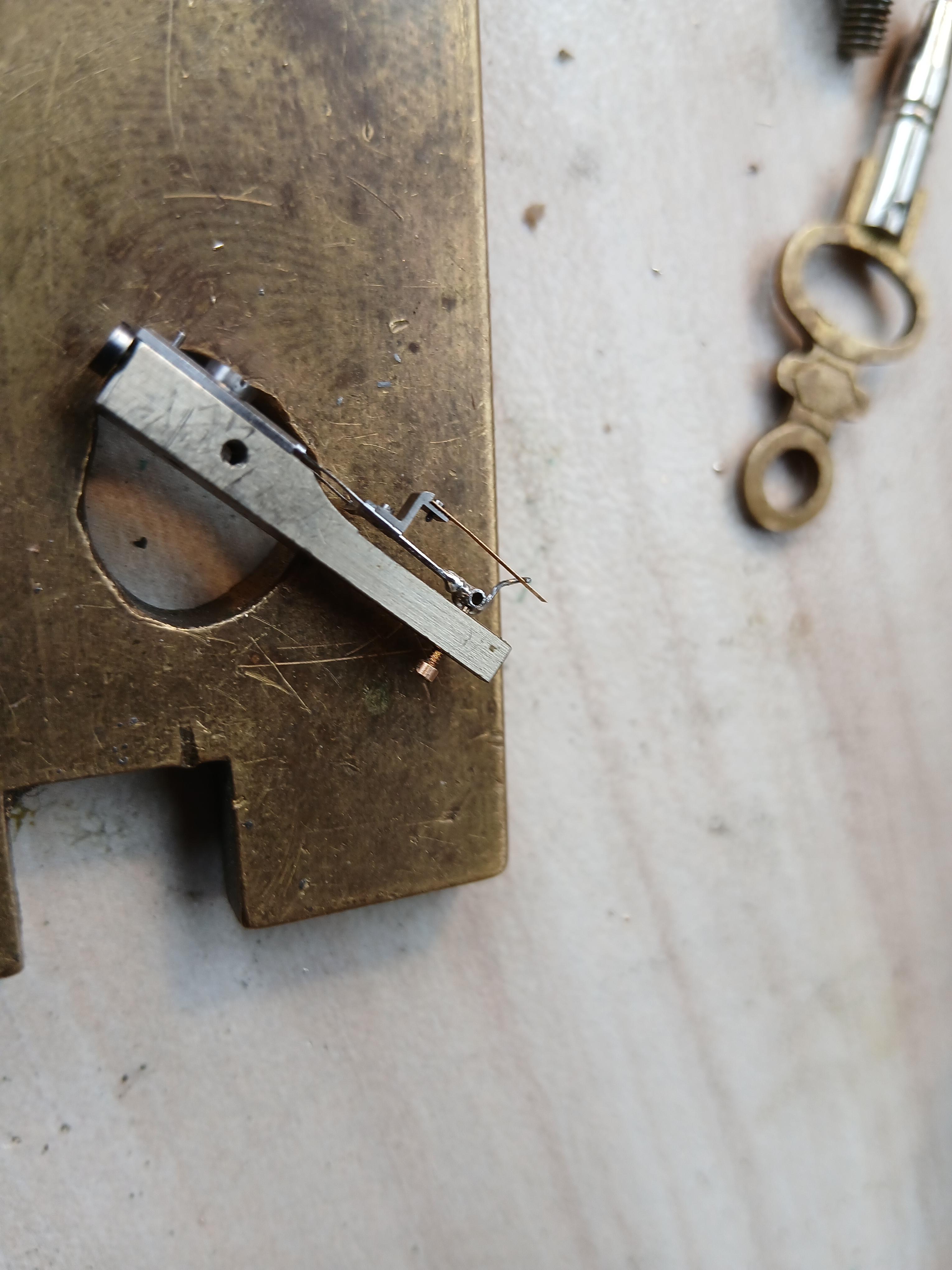

Here is a picture of the detent spring. The stone is missing, that's how I received it. The part that supports the little golden spring is sheared and missing
I have to decide if to make the missing locking stone out of glass or of tungsten carbide. Glass - will look more authentic, but carbide I guess will be firmer... Ideas?

If you have the means to finish carbide to the level necessary for the locking stone then you can make it from ruby/sapphire. Boules and other ruby blanks can be found (Ebay Ali etc.), but if color isn't a concern a good source is a sapphire watch crystal. This works well for hole jewels too, which are impossible to find in sizes to suit marine chronometers. A really quick search on Ali turned up these ruby rods, I'm sure there are other sizes available but for 8 bucks you can't go wrong.
Ali is also a great source for diamond paste and powders for shaping jewels. I was struggling along making a jewel a few years ago and a friend handed me an assortment of cheap Ali diamond paste and it worked great. I think it was mainly just having more options of grit, I had fancy Swiss sourced powder and paste that was just a bit too fine for the roughing operations.

This is great idea about the sapphire glass. Thanks a lot, I have never tried to shape sapphire, but this is what I will try to do. The other stones (on the balance rollers) are white color too.
Today i made several unsuccessful attempts to make glass 'stone', but the glass is too brittle for the way I try to make it. Interesting, I have made many impulse jewels of glass, but here the part that enters the hole in the spring is round and the glass breaks right on the border between the round and flat part when I try to lapp. But anyway, the glass seems to be not firm enough for this place.

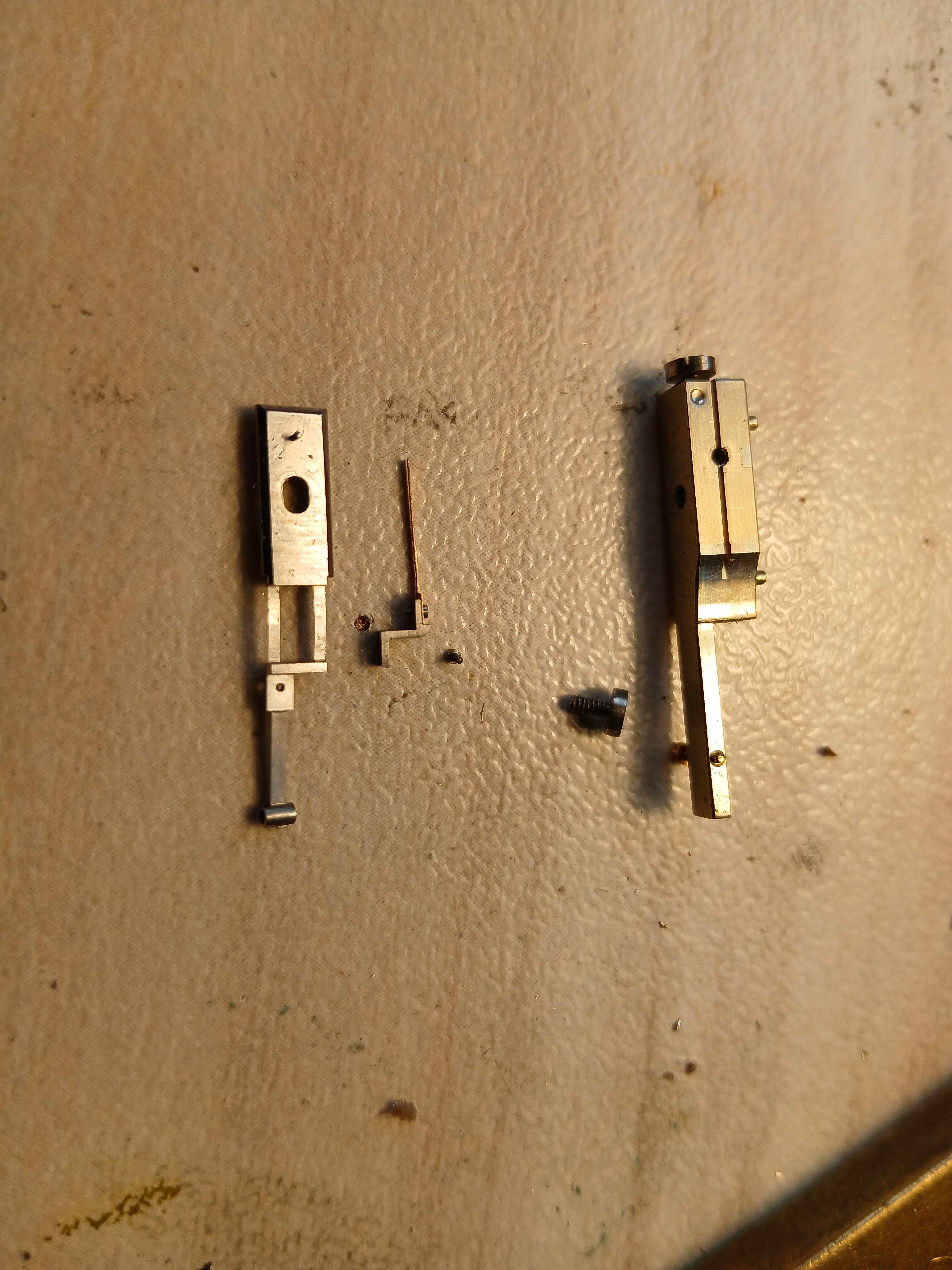

The way I repaired the broken part of the spring is rather ugly, but think it is reliable and I try to avoid making new spring.

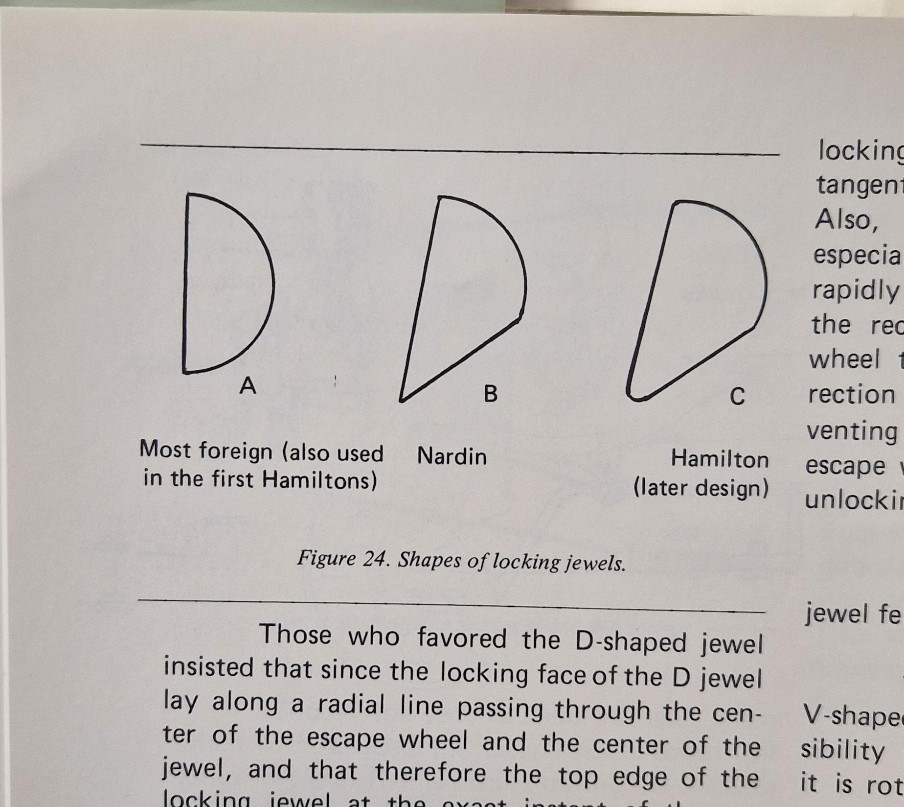

Just some info which you quite likely already know
The locking stone is held in by a brass wedge, which can be undersized on diameter as the locking stone can be too. "Too precise" can be counterproductive here, there's a lot of margin.
Ruby/sapphire does well in compression, the wedge serves well and only needs a small amount of force- a little shellac and all is well.

OK, today I visited a friend who is watchmaker and asked him if he has useless old sapphire crystal. He took out one from an old Seiko Kinetic for parts and gave it to me.
I came home and started work. The first I did was to break the crystal with the hope some small piece will have suitable shape to work on. For my surprise, appears there is thin (0.35mm) sapphire layer on top of a thick glass piece.  I first was disappointed, as the stone I need is with diam 0.65mm (and then ground to half to obtain D cross-section) but then figured that it may be actually better for me. Realized that I can use one of the flat and polished faces as locking face of the jewel and thus there is still enough meat in thickness of the sapphire. So, I ground small rectangle piece and glued it with shellac on the side of a 0.6mm steel plate, then filed it round and lapped  it to form the 'back' of the stone.
20250324_142312.thumb.jpg.5eaf811ffb8eda47ee25abaf52923d40.jpg20250324_143351.thumb.jpg.8f6a973211baf1732c18d7800fded6fb.jpg20250324_143911.thumb.jpg.20a96d76dbd6197db7a54801e0d017d2.jpg20250324_151114.thumb.jpg.2b2922239a88f3f24b996ce9632b1e4d.jpg20250324_162253.thumb.jpg.c6d384dd78de19df84ff0081b24f1f09.jpg20250324_162920.thumb.jpg.fa4d8e45c050667843c69218b1035003.jpg
I think the stone is good enough and will do the job it is meant for.
I cleaned all the parts of the movement as there was gummed oil everywhere. The spring is very strong and it was challenge to get it wound while holding the barrel and collect it in the winder barrel to extract it.
It left for tomorrow to test everything
