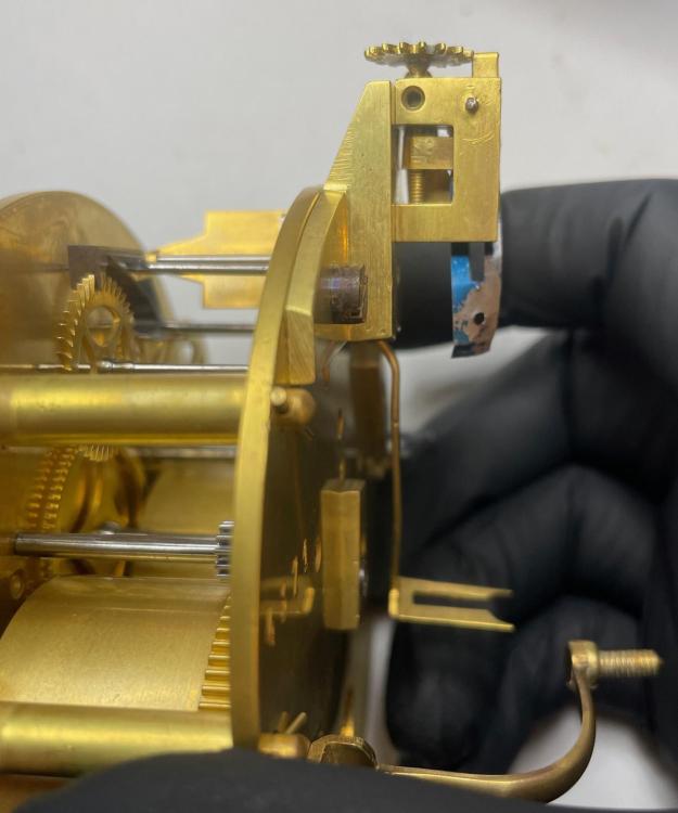

Hi, I'm hoping to learn how this adjustment mechanism works on my 1890s Lenzkirch clock. Plate is stamped with "47" if that helps ID anything. I do tinker a bit with watches and clocks, but am by no means an expert. I just took this particular clock to a local shop for a thorough overhaul. I mentioned at the time that the front adjustment for fast/slow did not seem to work right, in the past I have always had to adjust using the pendulum screw.
Long story short--the clockmaker said he could see it moving the adjustment, but couldn't take it apart further to do any more. He said it seemed to be working correctly. With the clock back home, I'm finding this adjustment is almost useless. When adjust it, there are regions of operation with too much slack, like the gear teeth are broken or slipping, and others where it feels like it's binding. The adjustment itself is not useful. In less than 1/4 turn it goes from gaining 5 seconds per hour to losing 5 seconds per hour (overall there are 2-3 full turns of adjustment before it hit the end stops). I can't get any fine tuning out of this.
My question: does anyone have a drawing or photos of what's going on inside this "black box"? I'd like to understand how it works and then decide if I should try removing it to fix. I can see 2 gears on top, I assume there's something like a worm gear internally that raises the suspension spring? The "box" has a seam and 2 screws into the side, so I presume it must come apart. However it may be that it's not able to be disassembled depending on how the gears are staked to the shafts. If that's the case, probably would be best to leave well enough alone and just adjust with the pendulum.

The gearwheel on top turns what is effectively a tiny leadscrew (just visible in the back) to move the middle block up or down, which changes the effective length of the pendulum in the same way the the pins on the adjustment of a hairspring movement can be moved to change its effective length (and resonant frequency).

Makes a lot more sense that it's a leadscrew down the center to raise/lower the suspension. So on mine, I should be able to measure a difference in the spring length that's exposed out the bottom at slowest vs fastest setting. The more I look at my photos, it appears this sub-assembly comes off pretty easily, it might be worth pulling off just to get a closer look. I'm not sure the spring is sliding up/down inside this block properly. Knowing this key bit of information, it feels like maybe the gear at the top is stripped from the leadscrew shaft.
More digging to do... I'll do some exploratory and post back.

The pendulum length does not change (at least in the ones I have), it's the middle block that restricts the spring from bending that moves.
It's a direct parallel to a hairspring adjustment - the end anchor does not move, the moving block on the support spring is like the pins on the adjusting arm at "B" in the image.

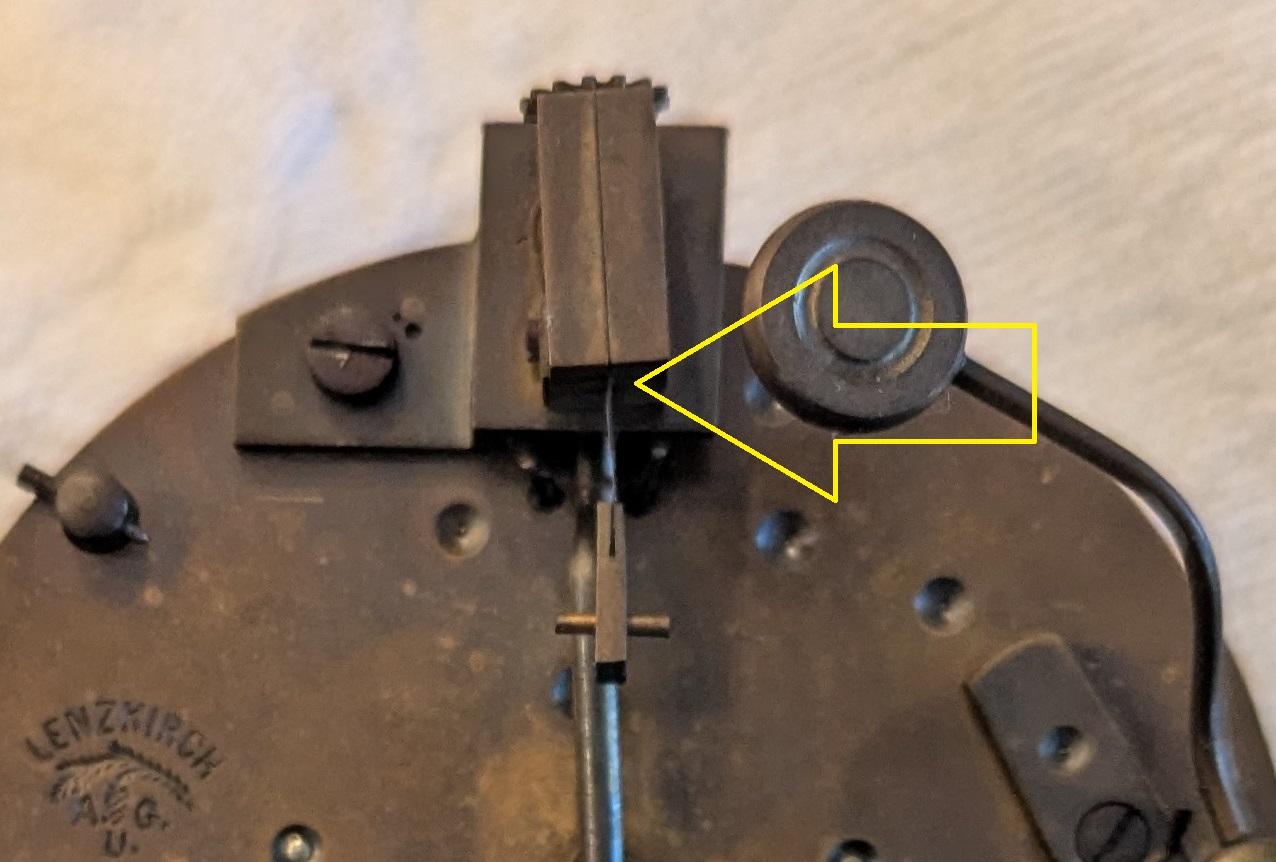

Hmm, I think a closer look at my unit will be necessary. It appears from the outside that the suspension spring is pinched by the lower portion of the block (yellow arrow). My assumption was that more or less of the suspension spring was allowed to protrude here as the leadscrew was adjusted. It's not an "open frame" design like the one in your photo that adjusted the touch point on the spring itself.
Maybe that's incorrect or something else is going on that I can't see. I'm going to try and pull this out and get better photos.

The front adjuster is for very small adjustments, but you can end up chasing your tail. @rjenkinsgb is right, as you turn the dial adjuster, the block moves up or down precisely, driven by the lead screw.  The point at which the suspension spring exits the adjuster is moved, altering the effective length of the pendulum. Each time you make a very small adjustment you need to leave it alone for a couple of hours to settle. I typically start the clock running to its theoretical beat rate using the pendulum adjuster, and then I fine-tune the average rate using the dial adjuster over days or even weeks.

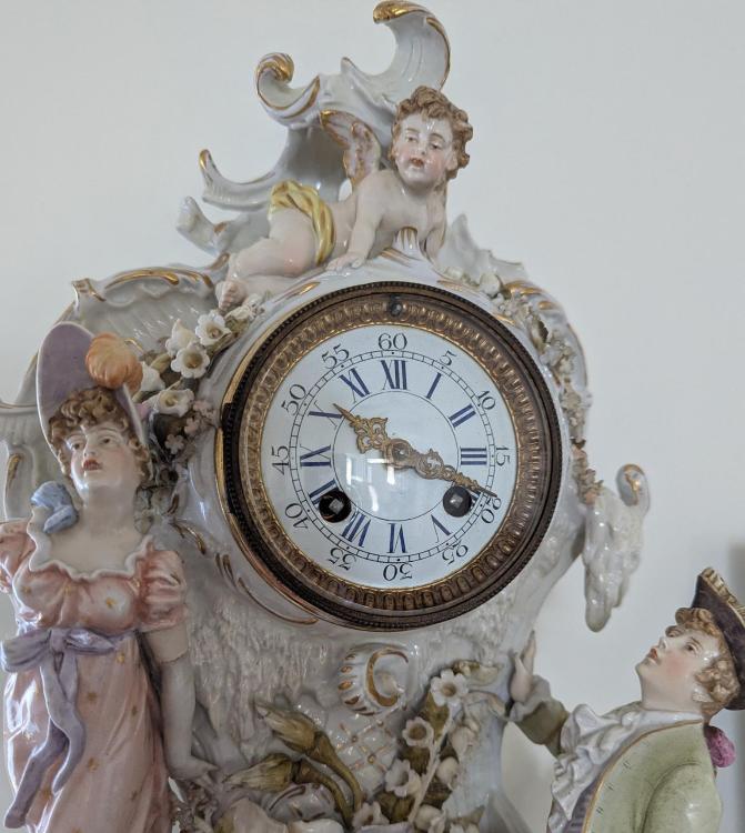

Sorry for the confusion. The clock was just serviced and is not in terrible shape. Please refer to the top 2 photos in post #1. Any of the pictures showing tarnished brass are simply older photos I had of the adjustment block.
As I mentioned, when turning the fine adjustment on the face, the "feel" is not right. It goes from too-tight to too-loose, and the clock rate jumps rapidly from too slow to too fast. I could make finer adjustments with the pendulum screw. I suspect there is something broken or jammed up inside this block, as soon as I get a moment I will remove this and inspect it closer.
With respect to the rate, I'm glad others brought this up. On a French-style clock of this vintage (that was just serviced) what is the expected accuracy? I'm not expecting sub-second accuracy here, but if +/- 20 seconds per day is normal, then I will leave well enough alone.

You will probably find the suspension is cracked or bent, probably due to moving the clock with the pendulum attached, jamming the block or I have had them where the screw is gunged up and had to be dismantled and cleaned and a light oil. (Windles).

Side question--on the topic of the badly tarnished brass, the front and rear bezels are also similarly tarnished and very dark. The innermost bezel around the dial appears to be gold plated? You can see I tried a little cleaning/polishing on the outer bezel but did not go too far. Would this entire bezel have been gold plated originally? Or was it always brass and just needs a proper cleaning?

As @oldhippy said polished and lacquered, yours is going to need a bit of work, brasso fine wire wioll 0000 grade and a bit of elbow grease, but once done will enhance the. Visual impact of the clock no end, don’t forget the rear door will need cleaning , most are just dark metal but the doesn’t mean it’s left dirty.
