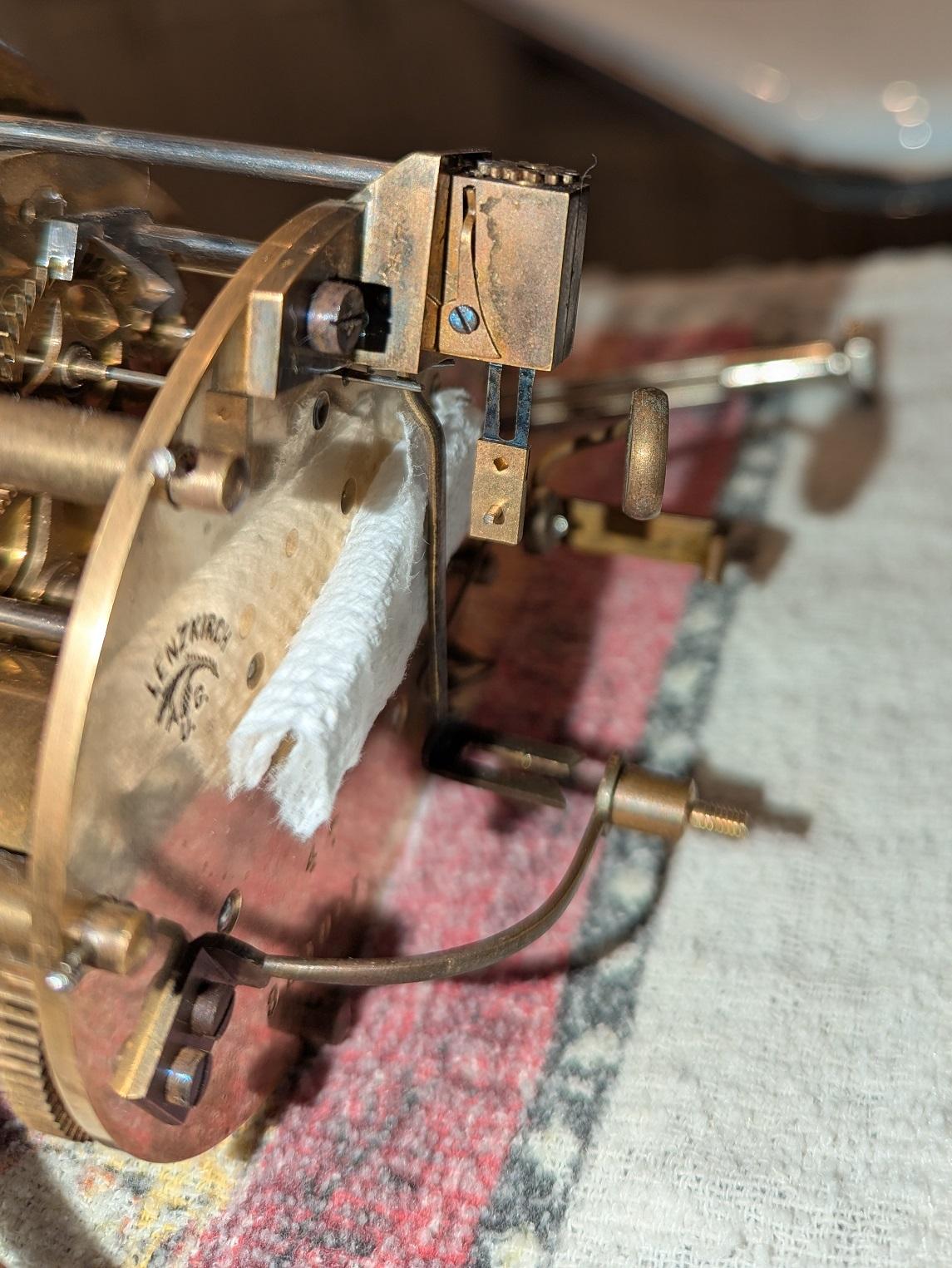

I pulled the clock back out to inspect the adjustment mechanism. I think the previous photos were unjustly harsh on the clock maker. If you see below, the inside of the rear plate is polished to a mirror shine. I suspect the backside of the rear plate was more heavily tarnished and, as discussed above, this was not a museum-quality restoration. I will keep that in mind for the next service, maybe I can put more effort into the cosmetic aspects.
The good news is I think the adjuster is working properly. I was not able to take it off and inspect inside, since the rear pivot for the escapement is held by this part, I didn't want to get into unwinding the clock. It does appear to move the suspension spring up and down when adjusted. In hindsight, I think the issue had more to do with what MikeEll pointed out--these clocks don't beat consistently, but average out to decent timekeeping. With that in mind, my clock is indeed staying within 30 seconds of the correct time throughout the week. I'll leave it for now and observe the timekeeping.

Lots of clockmakers made and sold their movements to third party retailers who had their name on the dial like the one you found with the tiffany. Some make no name on the dial only the movement. But again that’s not to say a third party sold it. I have repaired quite a few French clocks with only the makers name inscribed on the back plate. You will find many 400 day clocks with the name on the dial and the back plate. It is the same with watches there are plenty out there where the movement and dial names dirrer. The word Eubauches means un finished and as such were bought by many finishers who fitted then into their cases with their name on the dial.     Yes i can see the plates are polished as there is a reflection  so apologies to the repairer for that.
