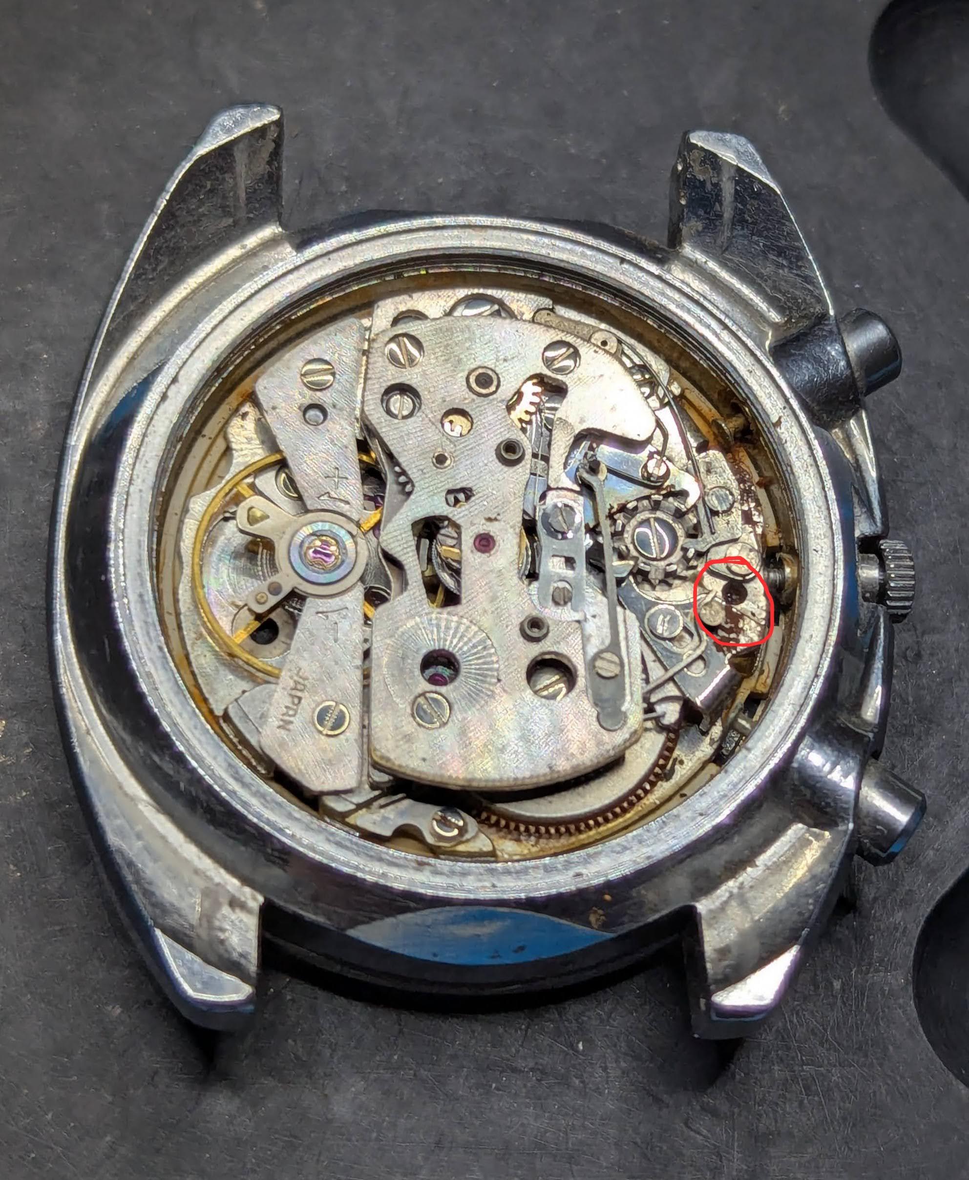

I'm trying to disassemble a Seiko 6139 chronograph. I got it as non-running from Ebay. When I opened it, it became clear that there is some rust in the movement.
The main problem currently is that I cannot remove the winding stem and crown. As far as I understand it should be possible to unlock the stem by pushing into the hole that I marked with a red circle in this phote:
It looks like the button to release the winding stem is corroded. It is hard to see what is inside the hole.
What are my options if the winding stem release mechanism itself is broken? Would I need to saw somehow through the winding stem to get the movement out of the case?

Yes that's the correct hole for the stem release.
You could try some penetrating oil in the hole and see if that frees it up.
Failing that what's the front like? Can you remove the bezel/crystal and access the dial?
 Penetrating oil might do, but be careful not to put to much oil anywhere when you will have the watch face down for hours.  If no joy, you ought to remove parts till you get to the stem. In which case;

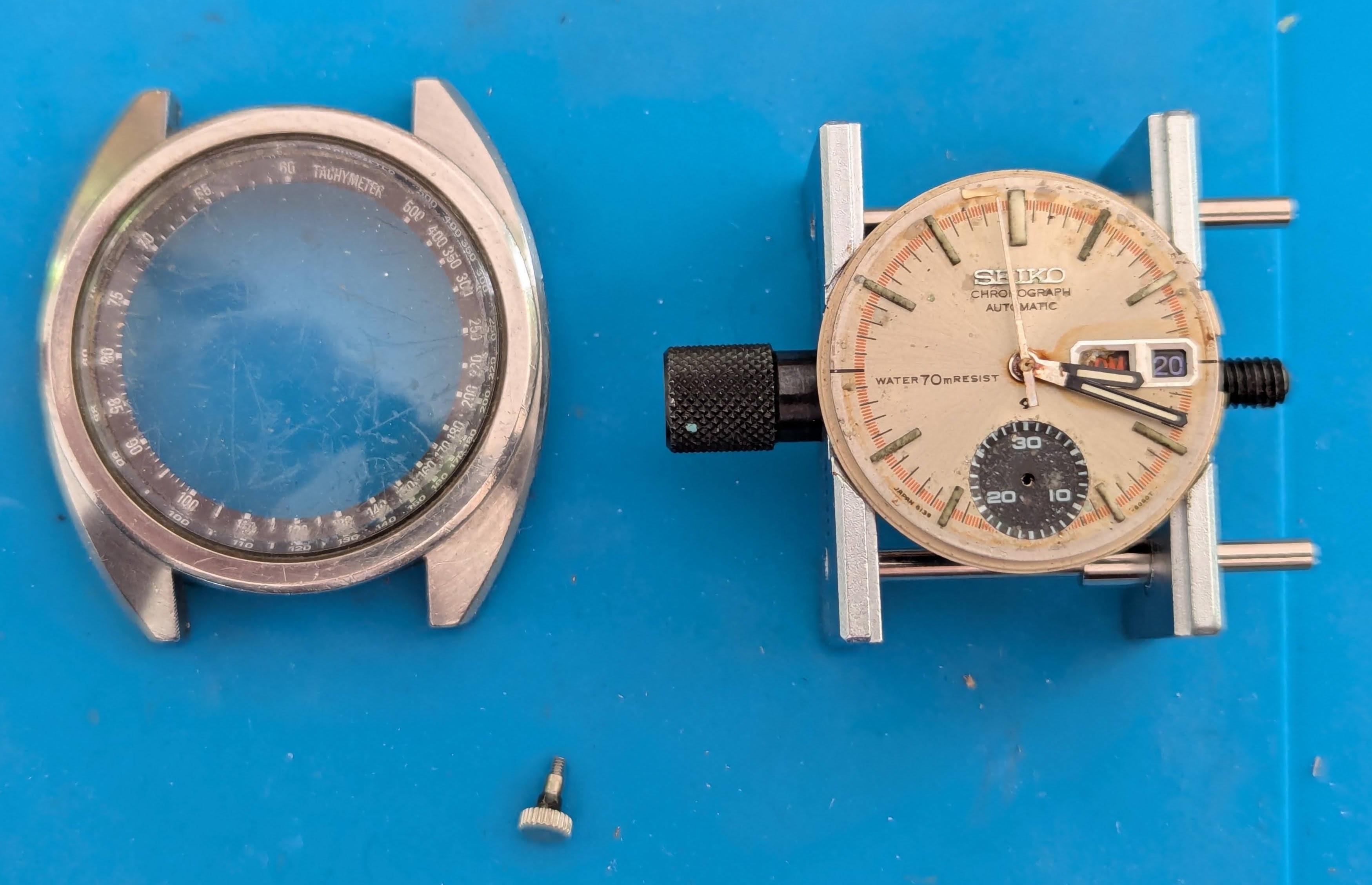

This is the watch from the fron:
I doubt that I can remove the mineral glass from the front. Even if, how would I get beyond the dial then?
I'd forgotten these dials are held in with dial screws so as you say that's a no.
As @Nucejoe said the only way forward is to start disassembly but make sure you let the power down before going too far.

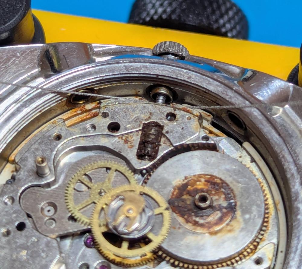

I was now able to remove the parts layer over the winding stem. The corrosion looks pretty massive:PXL_20250329_121531216.thumb.jpg.7f0df79379d7c7bc62911a89fe6a561e.jpg
I then applied a citric acid solution multiple times to the winding stem and its surroundings, and I was able to remove some of the rust:
Nevertheless the window stem still does not move and cannot be removed.
 Try removing  bezel and the winding crown. See if you can slide out the movement with stem attached, plus remvoning the case tube helps.
 Otherwise I just cut the stem, remove dial and hands ,dismantle as many parts I can , soak in Coca Cola , which doesn't hurt metals, but softens what you see as rust.

22 hours ago, AndyGSi said:
Looks like the only way is to remove the bezel and access the keyless works from the dial side.
I looked at several videos about disassembling Seiko 6139s, and from that it is not clear to me how I could remove the dial from the front.

Ok, I tried it and it worked!
I performed the following steps:
  • sawed through stem with diamond cutting wire, then I was able to remove the movement from the case
  • disassembled the hands and the dial
  • dipped the movement for 24h in Coca Cola
  • rinsed in isopropyl alcohol
  • ultrasonic cleaner with watch cleaning solution and then with distilled water
  • dipped in benzine
  • provisional drying
After that I was able to disassemble almost everything from the movement, except the winding stem and two part of the keyless works.
Some pictures from the process:
Ready for sawing through the stem:
After sawing the stem the movement was removed from the case:
Removed the dial. What came out looked pretty horrifying to me 🙂 The week day disk was crumbling and is totally destroyed:
The dial front and back:
PXL_20250413_121843148.thumb.jpg.da4c3acfe7626b02173d5849396c663e.jpgPXL_20250413_121853425.thumb.jpg.d0060a6aac61876eb5973c998ab46f3b.jpg
The only parts remaining in the ground plate are for the moment the winding stem with gears and two parts of the keyless works:
The winding stem does still cannot be removed. I will probably have to saw through the remaing part as well.
