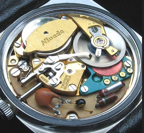

while they look almost identical at least to the casual  observer I don't think this is a 9154 which is why attached the technical up above for 9150. But to be thorough I will attach the technical for the 9154 and some images I  found on the Internet so 9150 as for contacts for the coil assembly with one home attached to a screw.
than the 9154 only has three contacts
the 9154 as a different coil arrangement were now it only has three terminals none of which are attached to the screw. So the image down below of this watch is a 9150. Although not the same all of the cleaning procedures testing etc. will all be identical other than the coil resistances current consumption will probably be a little bit different.
