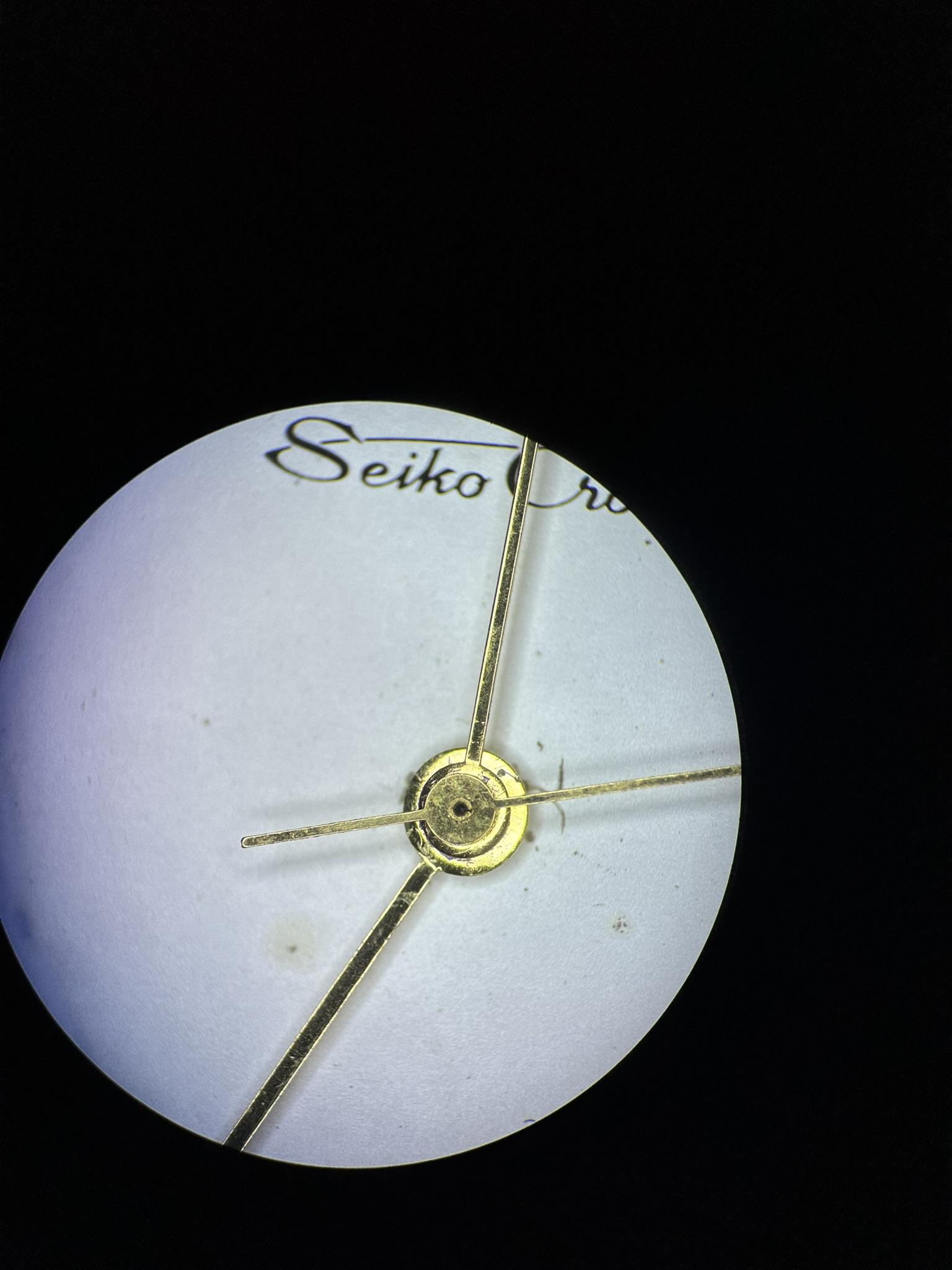

I recently bought this Seiko Crown on a trip to Japan. And I absolutely love the looks of it. But after buying it I noticed that the hour hand is bent to the side.
I’d like to straighten it but am afraid it will snap of. I’m quite new to watchmaking so I thought I would ask the gathered expertise here before doing something foolish. What do you think?

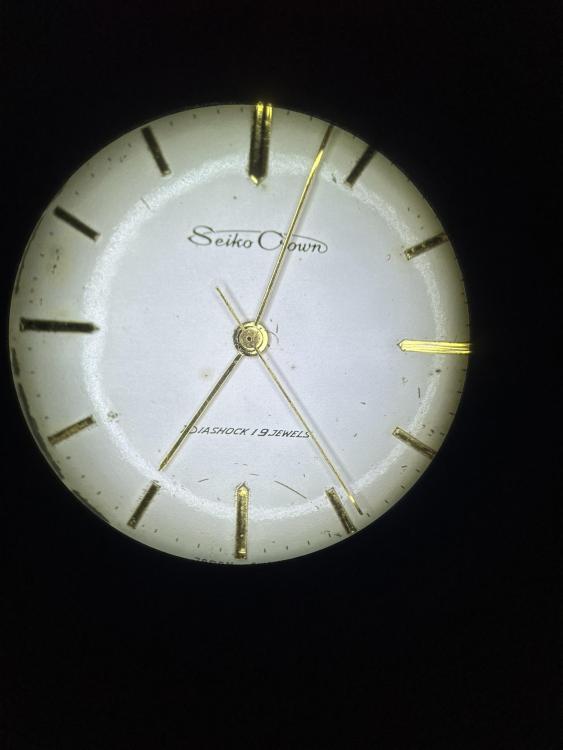

many of them have dauphine hands but others have your needle hands. I suspect they’re original..
Needle hands come with pointed dial markers and are still not as thin as the OPs.

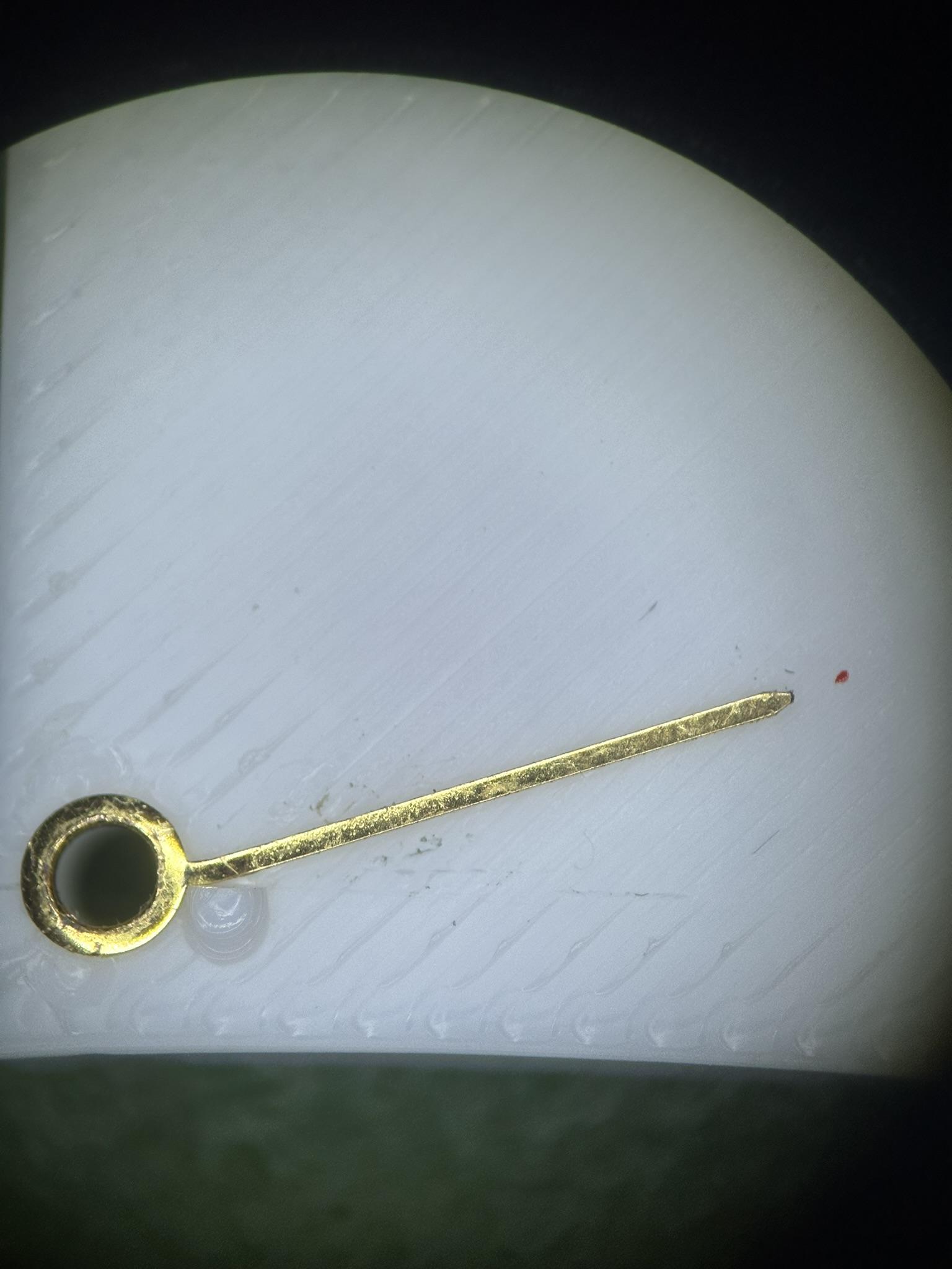

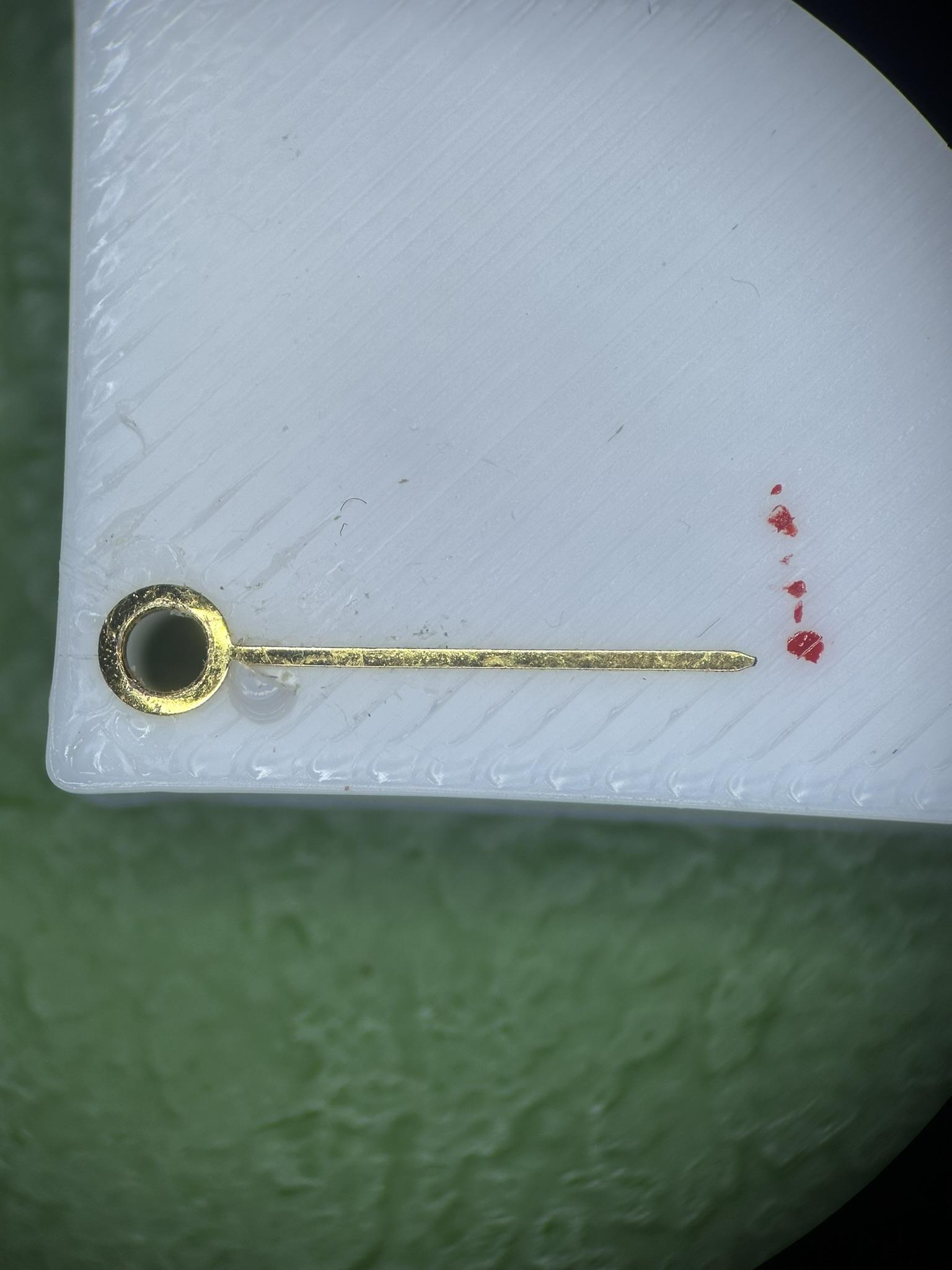

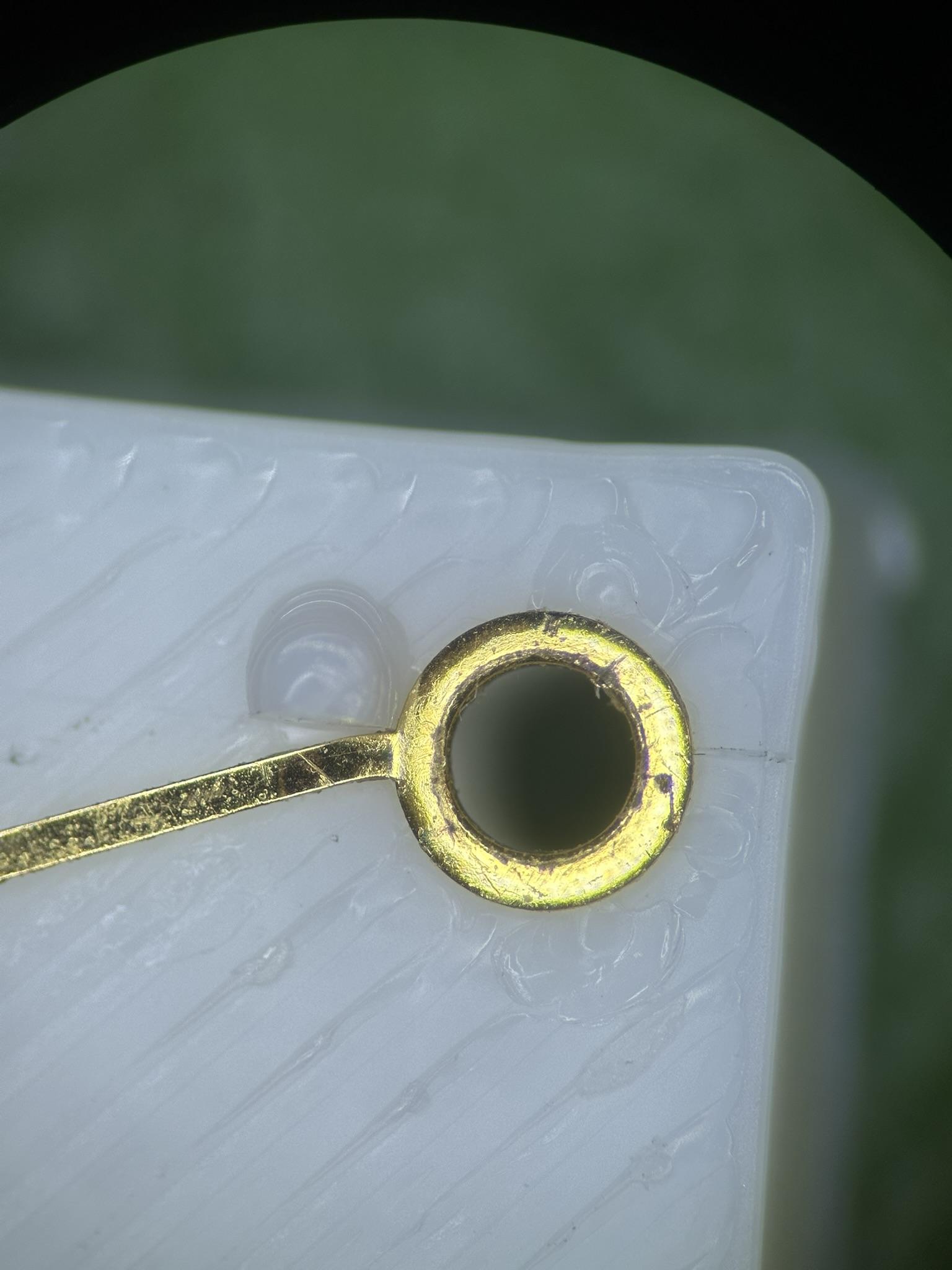

As rehajm said straighten it carefully. The tricky bit will be keeping the head still while manipulating the hand back to its original position. Don't be tempted to stick anything in the hole to grip it , you'll risk deforming or enlarging it. Find the best fitting hole in a staking block and clamp it down with something like a lollipop stick under finger pressure. If you can warm the position where it's bent that would make it a little more malleable. Not a flame, for a heat source I use a plug in wax melt warmer. Just some rubbing action at the point of the bend with a tiny piece of soft leather will introduce some heat to it. Then tease it slowly back with a piece of pegwoog, nudging it back a bit at a time, don't go for it in one.
The metal will adapt more readily to small adjustments ( bend and then relax )  rather than a big one that will surpass its shear point.
