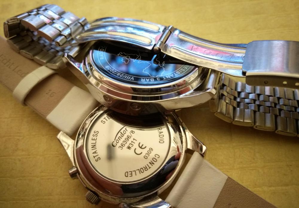

radio controlled wristwatch with minegal glass snapon back, impossible not to break glass back
