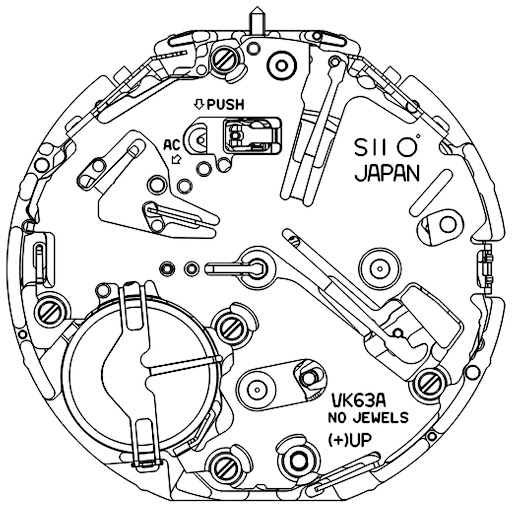

There seems to be a way to "short" the thing to what they call an AC Reset... Makes a bit of sense, only problem is that i have  to firstly re-assemble the movement.
This would be the case on a chronograph movement but the Ronda 515 doesn't have an AC contact.
Here's an example of a Seiko movement with the AC Reset.
