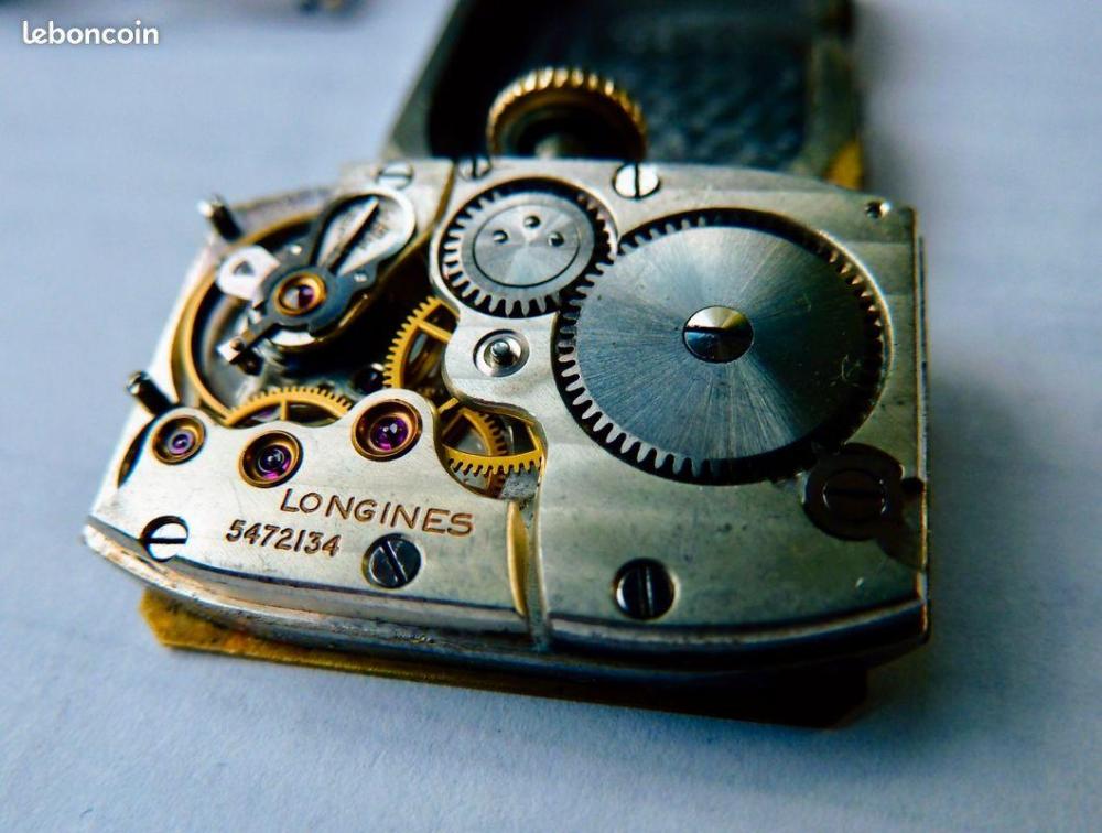

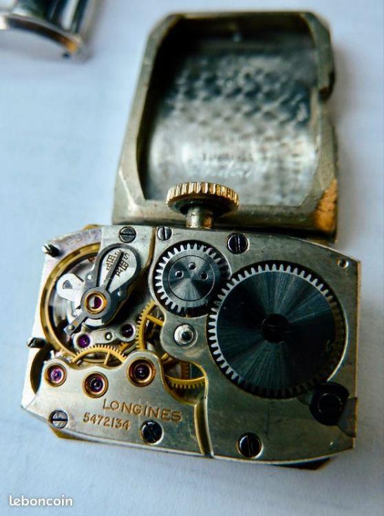

Hi all of you,
I had an opportunity to buy a vintage watch early in the morning. It is supposed to be a Longines with a 25.17 movement. As there are some buyers who react very quickly when they see a new watch on that website, I had to make my mind at once. I made some researched immediately, and then I decided to get that watch. After that, I made some additional research, and I think it might be a real Longines.
Would you have the same opinion as you look at the pictures attached?
Does that mean it's a fake? I had a look on SERIAL-NUMBER-DECODER.CO.UK which confirms that the serial number 5472134 refers to 1936, but the website indicates that "I have estimated dates for years where I couldn't find any information so please consider this a guide only, it should be within a couple of years either way".
I had a try with another website which indicates 1937 and a third one which indicates 1936 (approximately).
May I still hope that it's a real Longines? If not ... I've been to quick in my decision🥴
It may just not be a 25.17 movement but I don't know enough about Longines to what came later.
Edit
Just found this which dates to 1935 so maybe the 25.17 was made before 1939 as stated on Ranfft.
https://www.joseph-watches.com/all-products/longines-cal-25-17-stainless-steel-1930s/
Re Edit
Done i little more searching and to me it looks like Ranfft is wrong
but can't find what actual date these were first produced.

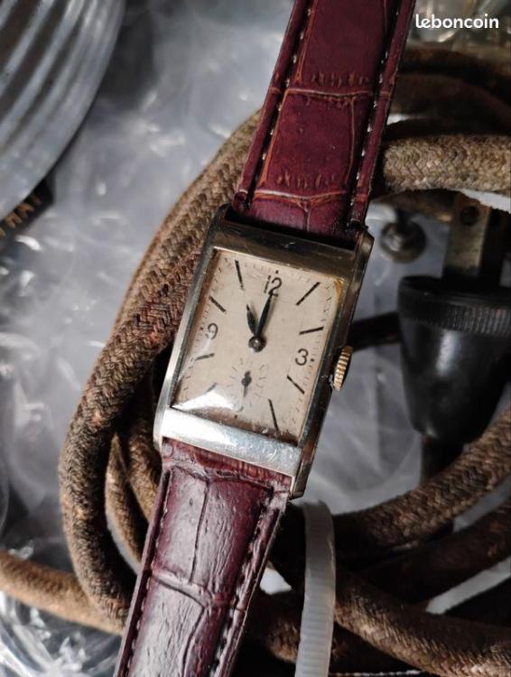

Looking at other examples my thoughts would be it's a genuine movement but the dial
and case both look wrong so I suppose it all comes down to what you paid for it.
Edited by AndyGSi
Longines have a service where you can send the serial number and they will tell you the date and name of the agent the watch was sent to.
I'm not sure about the case, but I would expect "Longines" on the dial
Edited by mikepilk
I beleive Its a Longines, couple of variants to this calib were made,  one with flat and several  with overcoil H/S, overcoils were furthure modified, thus new designations.
 TG reveals it's  worth, when serviced.

The thing is you have to provide Longines with a serial number AND a reference number when you fill the form. I have the first one on the movement, but I can't see the other one, which sould look like L.xxxxxxxxxx. I mentionned the number inside the case and I sent the mail. Wait and see...
