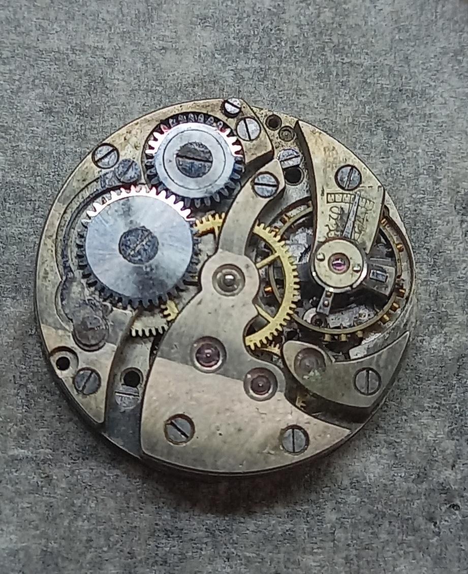

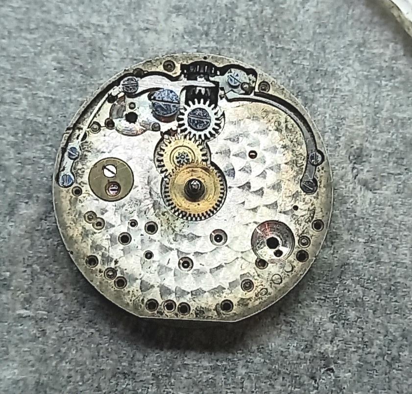

So, I have spent a number of hours now trying to find out what this movement is. I can't find any identification marks but these are things I believe to be true.
1. I'd put it as 20th Century, around 1920-1930 but it could be pre WW1
2. It's a pocket watch movement and the case is not original
3. It is 15 jewels, Swiss lever with a flat hairspring (i.e. it is not Breguet)
4. I don't believe this dial belongs to the watch as the feet have been cut off (looking more and more like a fake trench watch)
5. My guess is the movement is Swiss. This is based on the train bridge shape and the overall design. It has characteristics of W&D or Aegler but I think it is something else.

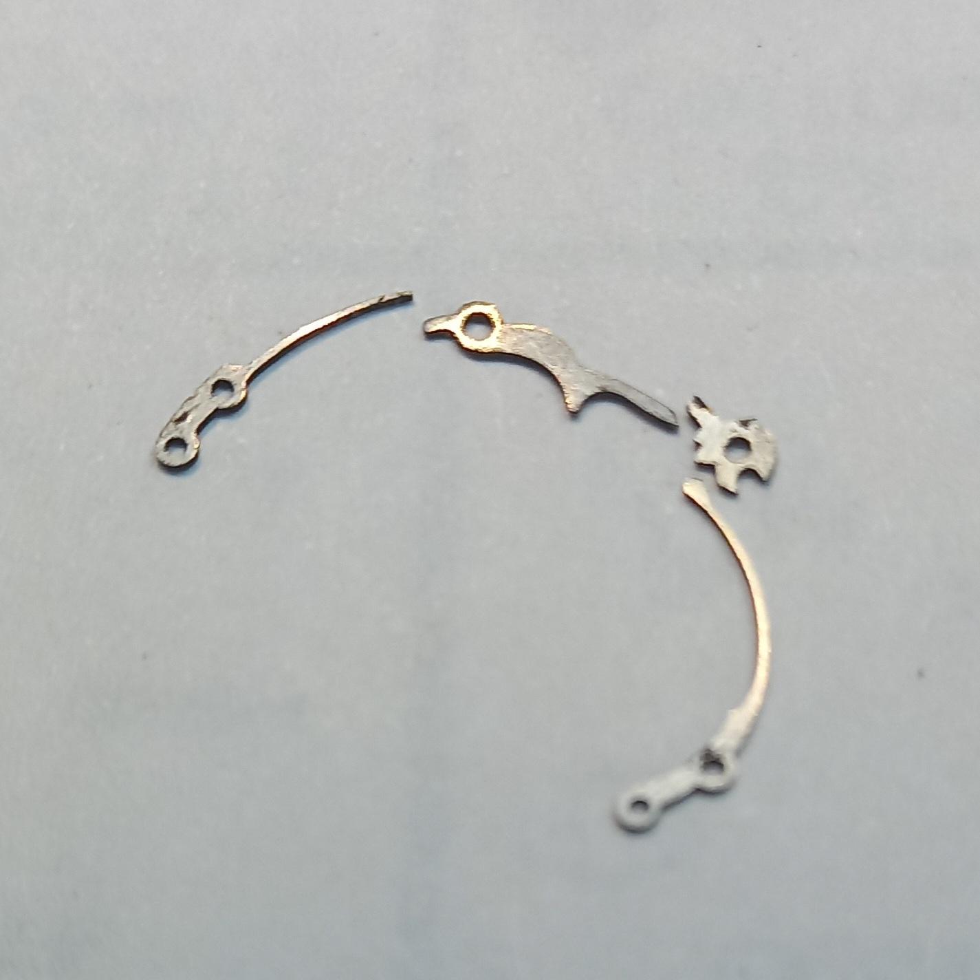

While we’re waiting for the keyless I will take a moment to admire that click spring….👍🏻 A Schild and Arogno did them like that for their trenchies…could it be?
Edited by rehajm
Langendorf has clicks that look exactly like this too, and used the same bridge layout but I don't see a movement that has both this bridge layout and this click.
