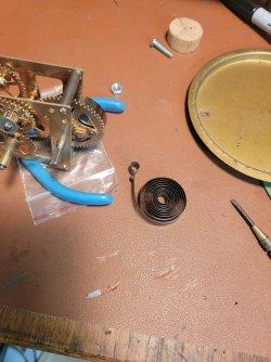

I posted about this on NAWCC but thought I would give the clock folks over something to see.

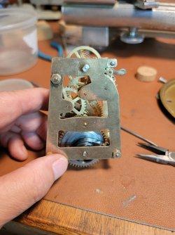

This clock came in a beautiful marble case, but the movement is a cheesy open-spring pin-lever design.
I cleaned it (the efficient way), and it would not run at all.  I realized that the spring was giving almost no power to the train.  I was sure it was a weak mainspring.
Last year, I donated to the local watch and clock museum by buying everything that came up for auction at the local guild meeting.  I dropped $450 for a good cause.  Part of the haul was a bag of mainsprings for clocks.  LOL...what will I ever do with them.  Today, I fished out a mongo spring that would fit in this clock.  The balance wheel took off like a rocket.  I had to collect it in the yard next door 🙂 .  Well, I decided it was too strong, so I dug through the bag again and found something more appropriate.  The clock is running and keeping time so far.
2 hours ago, oldhippy said:
I can see the first photos with the spring do not have the correct size as the width is too narrow to start with. The case looks as if it could be French and the movement I would say is German. What is the dial like.
I thought the spring was too narrow as well. I installed a bigger one, but was concerned about overpowering. I will send a Pic of the dial in a bit
I think you nailed it.  French!
Here is one on ebay.  Though the movement is not visible, everything else matches up.  It is an 8-day clock, so the little spring I installed will not work.  I will put the big one back in.
