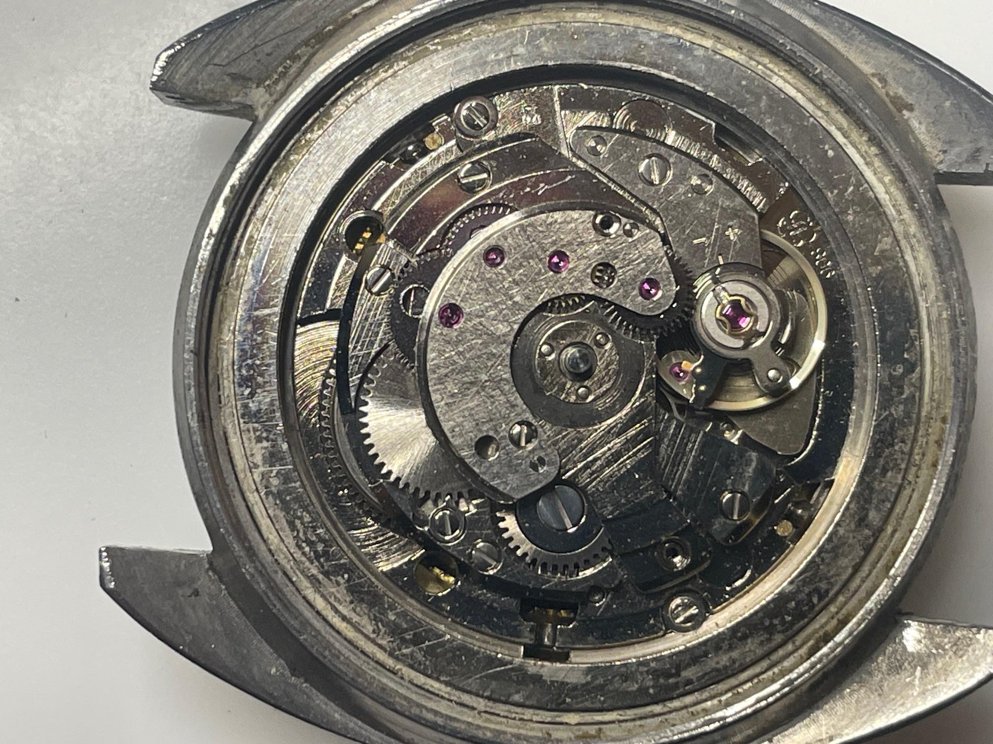

I recently got a watch from ebay that looked interesting, with the day & date at the 6 o'clock position. In the photos the crystal appeared to have some deep scratches, but not so bad they couldn't be removed.
However, when I got it - they are cracks. Has anyone had any success repairing such damage?
I'm going to try some dichloromethane acrylic solvent, if there are no better ideas? I know it will mark the surfaces - but if it can penetrate and allow the cracks to seal, re-finishing the surfaces is not too bad. Or does anyone know a supplier of these shaped crystals??
It looks pretty good other than the crystal; though the back was incredibly tight and somewhat scratched from a previous owners attempts to remove it, once that was removed it's got a nice clean, running FHF908 25 jewel movement with three service marks inside the back. The case is solid stainless steel so no plating to worry about, it should clean up well.
The service marks appear to be: 68128, H/R 12/75, 7106 - are those 1968, 1975 & 06 or 71?? - or possibly the 78128 was the sellers marking? I've no idea what they really mean?
I am going to have to drill out the end of one of the strap pins - both pins were bent & mangled, one broke trying to remove it.
So, a new and interesting problem - the movement ring is corroded in place.
It looks like it has a lip that forms half of the groove for the (missing) back seal ring, and that area it tarnished or has some form of sediment all the way around. The movement will loosen from the ring easily enough, but can't go any where due to the dial, as long as the ring is in place.
There is nothing I can see to grip or pry the ring out without touching the movement?
It does look to run pretty well though!
There is a definite line and slightly uneven step in the middle of the seal groove, with the ring almost perfectly flush at one side and slightly raised at the other - I can't see it being part of the case?
The movement is small enough that is could be a front loader, though I don't know about the dial - but I can't imagine how the crystal could be fitted and sealed from the front? A lip and seal seem more likely?
I can't see a bezel at the front, so the dial must come out the back, so the movement ring must come out. It's odd that there are no cut-outs in it to allow you to pry/lift it out.
I would put some WD40 along the joint and leave it overnight.
It make no sense for it to have such a large diameter screw-on back and have the movement come out front ways. I'm of the opinion that this ring sits to a lip on the case inner and the clamps pull the movement back to its position. The clamps are holding the ring, pulling the ring.....you are trying to take the ring, the movement and the dial all together....it's probably jamming .

The type of case screw suggests it comes out of the front.
Normally it does, but it doesn't look like the movement would fit through the front.
Had a quick Google and found a few Sandoz with that movement and similar screws, but the movement rings had cut-outs so they could be grabbed.  I wonder if that movement ring has been fitted inverted?
Edited by mikepilk
Got it!
I put a tiny amount of evaporust around the seal ring using a thin wire and left it ten minutes or so. I could see it wicking in to the gap in places, so went around it with micro swabs - and it pulled a load of crud out.
The ring then moved quite easily and could lift it out by prying alternate sides.
