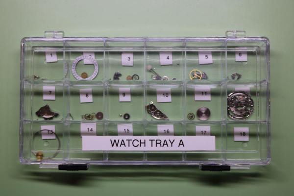

You may of heard of me referring to my 'parts tray'. I just want to share with you an idea I had which may help someone else who is new to the hobby and is about to start the TZWS course. To avoid me getting screws etc mixed up with other similar sized screws I bought a tray from a craft shop with more compartments in it that a usual watchmakers parts tray. I then numbered all of the individual compartments of the tray, Then every time I complete a step of the course and remove a part I make a note next to that step of the instructions with the number of the compartment I have placed that part in, Then when it comes to reassembling I know exactly where every part is and I know that I have got the correct screw. (I didn't explain that very well but if you look at the picture below you will hopefully get the idea)

BTW, that system with the bigger tray and all, I find it very good! You can almost go backwards on the tray to put together the movement...pictures would be only the icing of the cake, almost overkill. Very nice! The difference in screws is something you will eventually figure out but somewhere in WRT there is a chart that might help. I'll try and find the link later.
You should be very proud right now!  I've found that it's a given that you will loose parts into the great watch part black hole.  My first timezone movement I lost no parts, but stripped the left handed screw thread.  My second timezone I lost 3 including the arbor that bobm12 mentioned in is post.  I found it a few weeks later AFTER I got a replacement from otto frie.  Then I went about 4 watches without loosing anything, and one day a click spring.  The last part I lost is a jewel spring on a Zodiac GMT Aerospace, I'm currently working on.  Luckily, I had a spare AS 1701 movement with the exact spring.
As far as your tray.  That is awesome and I'm not going on the lookout in my area for one!  Especially since I often get in the middle of dis-assembly / assembly and can't get back to it for sometimes weeks.  Thanks for the tip.
