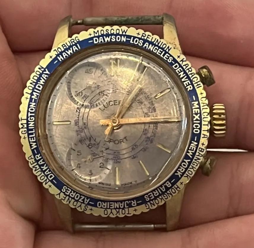

Couldn't resist this very inexpensive Lucerne Sport chronograph. It was worth the money just to satisfy my curiosity to what's inside. Seller sez:
Quote
Subdials move as they should, ticks when shaken with good motion for about 5-10 seconds
Looks worth the gamble. Looking forward to seeing what you got.

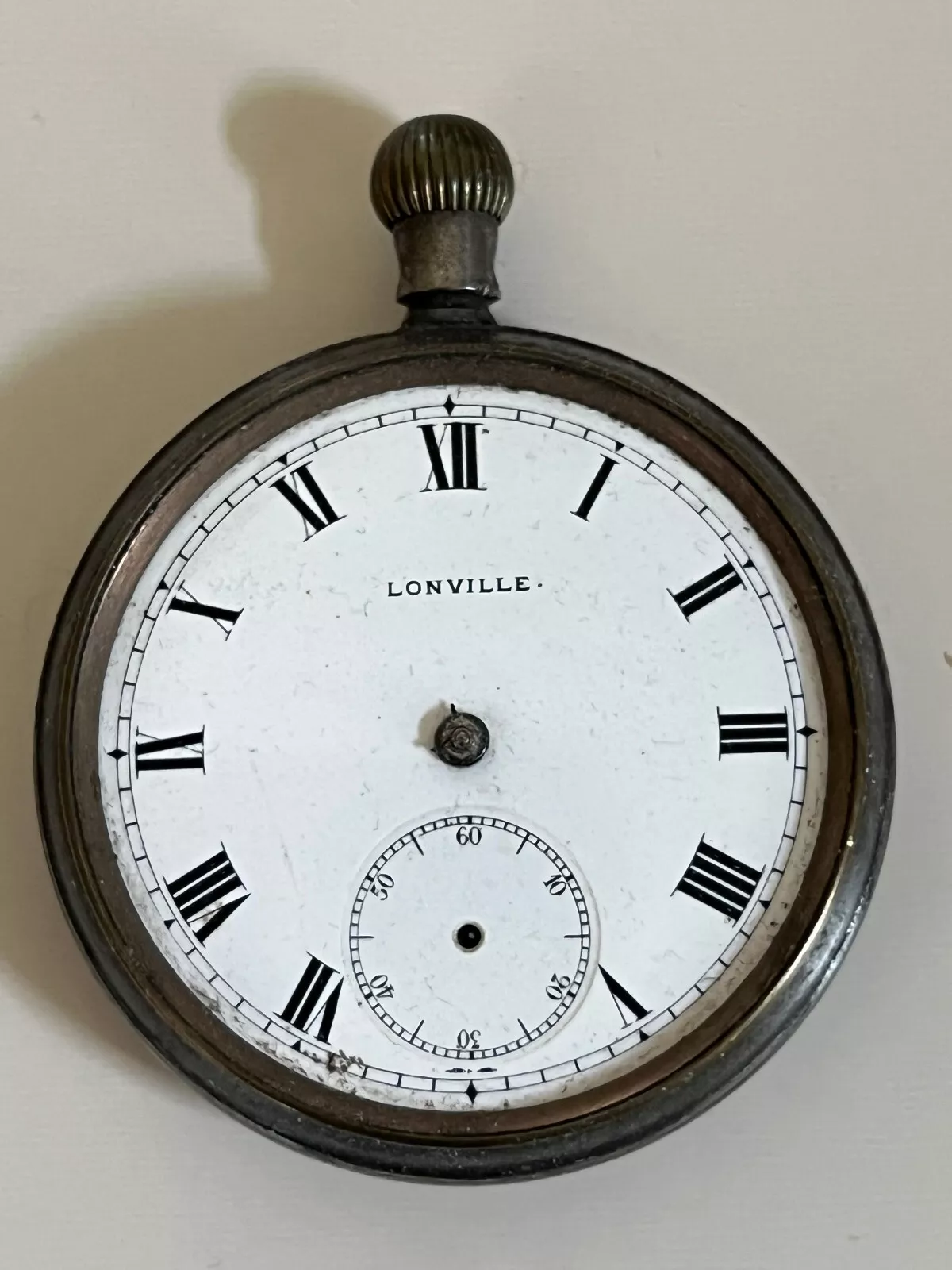

Here's my latest gamble. A Lonville pocket watch in a gunmetal case. I too have absolutely no idea what lies inside.
Possibly a Langendorf. Possibly a 7 jewel cylinder movement. Possibly a small lump of coal inside and a note to Santa Clause.
Time will tell.
Lonville watches seem to still be around (or perhaps they have been brought back to life).
https://lonville.com/
I've seen similar Lonville watches with a Langendorf movement. And in the USA there were brands Lonville and also Stratford which had six jewel Langendorf movements, presumably to lower import costs. The lower balance cap on those is polished steel set in brass instead of a ruby jewel. The plates were very rough, with lots machine swarf and jagged milling, and the plating very thin & corrosion-prone. You may have some fun!

This is the  trace from the Lonville. Its not a work of art, but bear in mind I've done nothing to it except wind it.
It does indeed "need a hand" ..or three, and a crystal, and a proper service, but it certainly looks like it wants to live.
9 minutes ago, mbwatch said:
But what's INSIDE it??
I thought you'd never ask.
It is sporting this rather nifty 5 jewel Swiss lever number.
I'm guessing its from the early 20th century, which means it is probably more than 100 years old.
Five jewels is crazy. Are neither the lower balance hole nor cap jeweled? I assume it's upper balance & cap, pallets, & impulse jewel.
I'm saying 5 jewels, because that is the minimum it is likely to be, but it *may* be seven. I haven't explored it any further.
There is a good chance however that the lower balance hole is a bushing, with perhaps a steel cap.
It might, of course be a jewel and cap jewel.
I'll find out when I get a chance to strip and clean it.
What makes me suspect that it is only five jewels is the fact that I have found similar Lonville (Langendorf) seven jewel movement pictures online, but they are stamped 7 Jewel like this example. My suspicion is that if it were 7 jewel, it would say so.
Lonville was part of the Langendorf Watch Company, a well respected Swiss watch making company.
They traded for exactly 100 years from 1873. They used several brand names including Lanco, Larex and Lancyl.

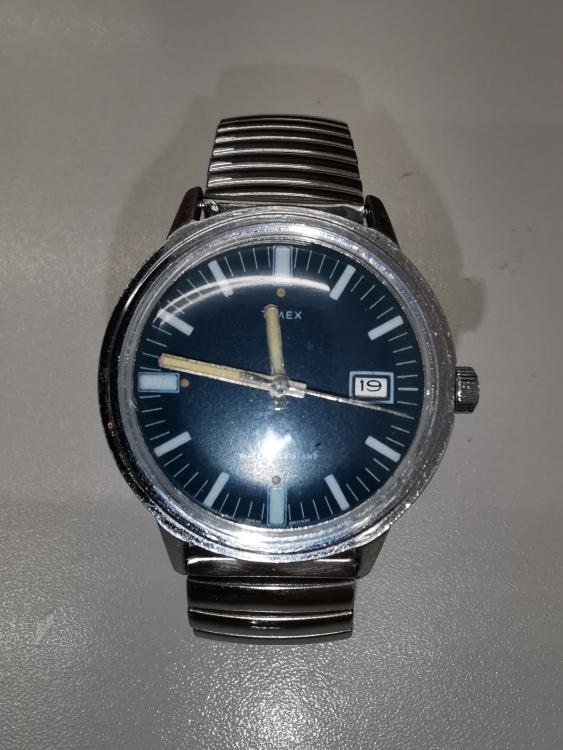

33 minutes ago, AndyGSi said:
but still don't know what the 'Marlin' refers too?
Can you see a dial code? Catalogs would classify almost every men's water resistant, manual wind model as a Marlin.
38 minutes ago, mbwatch said:
I don't know where to find a UK 1972 catalog; the dial does not match any of the 1972 Marlins in this US catalog but Timex sprinkled their dial designs over a lot of years https://heritage1854.com/1972-catalog-reference.
Thanks for the lead which has helped me understand Timex details a lot more.
I now realise the first 6 digits are the model and last 4 digits are the movement and year or manufacture.
Ah sorry I assumed this was already known. It can be the last 5 too, for the later manual movements 104,105,106 that show up in the later 1970's.
