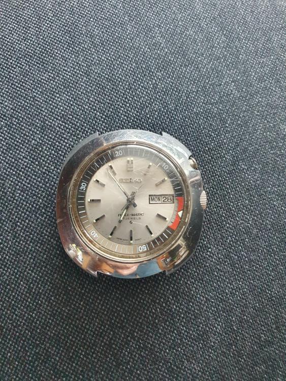

8 hours ago, AndyGSi said:
Are they both 7625-8233
One is an 8230, the other 8233 - the difference being a change of wording on the dial from sportsmatic/diashock to automatic/waterproof. '66 and '69 I think.

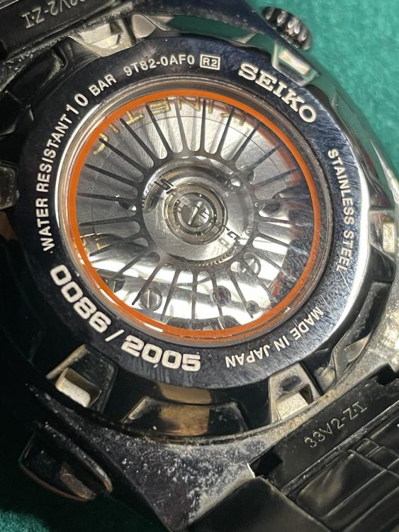

And this - given to me by an old friend, who I'd happened to show one of the old watches I'd restored.
He is an Apple fan and told me he's never going to wear it again, so he wanted someone interested in watches to have it! It's complete with everything - box, paperwork, case, guarantee and receipt!
It needs a bit of a cosmetic clean but is otherwise near mint, just slight wear on the raised bezel around the small dials.
It has a 9T82 movement which is apparently "Grand Seiko" grade - and (officially) unserviceable except by Seiko Japan. The capacitor battery is a bit tired and it only lasts about a week rather than a month, but not too bad.
The chronometer is purely mechanical and has a tenth second dial, with the hand rotating once per second; the minutes dial has two hand for hours and minutes.
There a photos of one being fully rebuilt in a thread here; the capacitor change requires dis-assembly of the chronograph!
Servicing this is beyond my present skill level, as a single damaged part means it's wrecked. It will have to go to Seiko once that's unavoidable.
https://forumamontres.forumactif.com/t263764-remplacement-batterie-sur-une-seiko-9t82
ps. The dirt on the back was not obvious in normal room lighting...

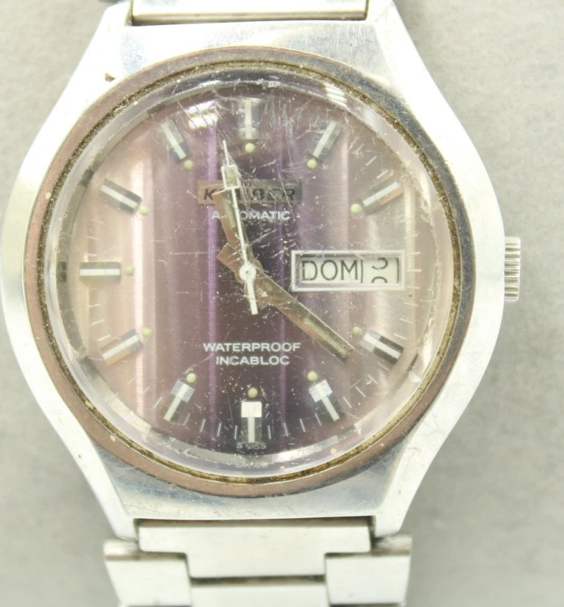

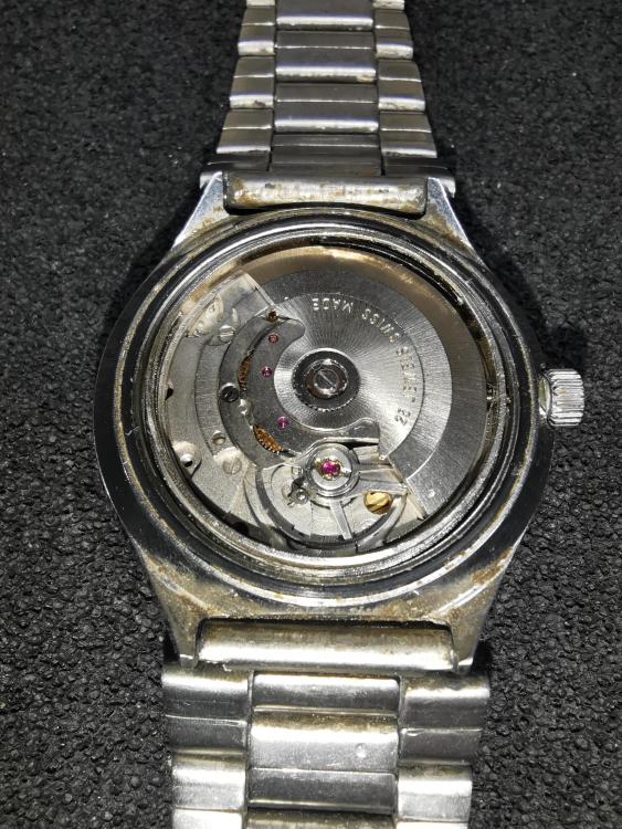

On 3/31/2025 at 8:06 PM, AndyGSi said:
Just bought this and wondered has anyone heard of Klabier or would like to take a guess at what Automatic movement it has?
Arrived this morning with an ETA 2789 movement that has some life but needs to be serviced.
Also has a problem with slipping when trying to set the hands clockwise so another one in the project cupboard.
Edited by AndyGSi
