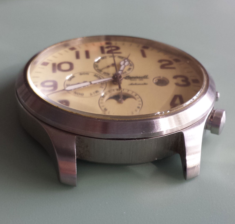

I am struggling to find a way to remove the movement on this large Ingersoll watch from its case. Cannot seem to find any screws that pin the movement to the case.
Tried to remove the steel spacer, it is un-movable even with pliers.
Does it mean that that I have to come from the glass? If through the glass, do I pry on the small opening on the bezel (see the second picture attached)?
Appreciate any helps. Thanks.
Yes. Looking at the pictures is most certainly has to have the bezel removed in order for the movement to come out. Pry off the bezel being VERY careful not to slip and scratch the dial. Then you will see that the dial and movement will come out through the front.
If you can, take some more pics when you are done and post them up here.
The movement (SeaGull TY2867) of this Ingersoll watch (IN1602) has been successfully taken out of the case.
The movement comes out from the front glass. Therefore the bezel and glass must first be removed.
See attached picture.
