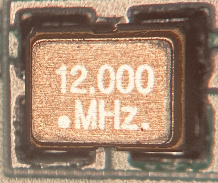

CM108 come as different variants (e.g. ...B and ...AH). One uses a 12MHz quartz, the other (cheaper) uses an on-chip RC oscillator.
All recent chinese USB soundcards (with case) seem to come without own quartz and they are more or less useless for our goal. I tested several of them.  Better ones show small rate variations, others ridiculous high rate variations. None is appropriate for precision tests.
Those naked boards have the quartz visible, what is good, and still have one until ...

13 hours ago, xyzzy said:
There is a difference.  With this device, there are two clocks.  One is in the device, it samples the audio.  For a computer, you are done here, one clock.  But with the USB device, the audio must be sent over USB.  USB is digital, there is a clock here too.  But this clock is in the computer.
Both clocks must agree: every second, 48000 audio samples.  But are two different clocks going to run at exactly the same rate?  No, they are not.  So stuff must be done about this.
And that stuff to deal with these two clocks that must be the same but aren't, it can affect timing things via audio at a rate measurable in s/d.
Fine.  We are measuring tick tocks, not Def Leppard (or Beethoven...choose your medicine).  If you are making the point that analog audio directly into the PC has better SINAD, nobody is going to argue with you.  This chip has horrible SINAD out of the box.
