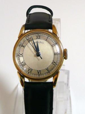

Watchitis struck while trawling through eBay yesterday. I spotted a beautiful wrist watch which satisfies my lusts on two counts:
(a) it's 1940
(b) it's a Hamilton
So... I saw, I sniped, I won. I'll post a better movement pic when it gets here. For the moment:
Beautiful Watch! And, I love that dial Will! I'll have to keep this design in mind when I send off my next dial to be refinished!
Thats a very nice watch Will,  you have a very good eye for watches,  you will have to stop buying for 6 to 12 months in order to give others a chance.  :thumbsu:
I have to agree with Don and Roger, it's a really nice timepiece!

Well, it arrived today and I'm over the moon. It's a beautiful little watch in superb condition - especially considering it was made in 1940. I've photographed the movement in all its glory. Note the hack - which works perfectly.
