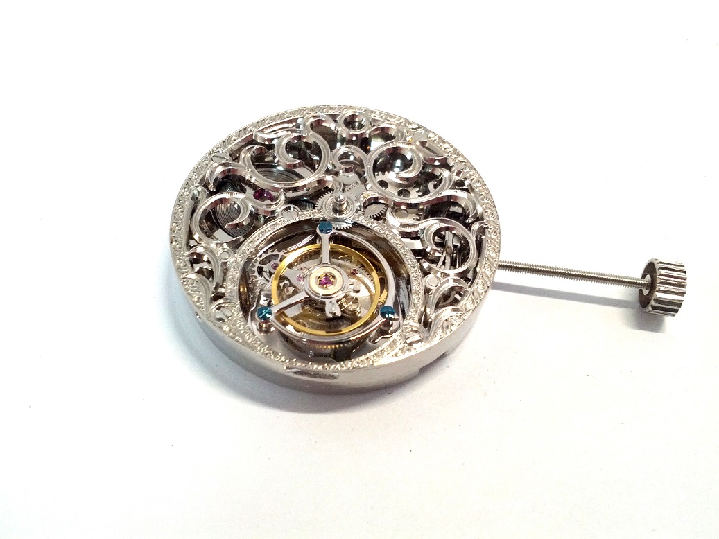

This is a very nice looking Skeleton movement that features a 1 minute "Flying" tourbillon escapement. It seems to be well made and for just $329US I think it's pretty good Value!

I'm not a huge fan of Skeleton movements myself, but this movement was the best option since the manufacturer does not supply dials. So, I figured that I could case the movement easier with out a dial.....

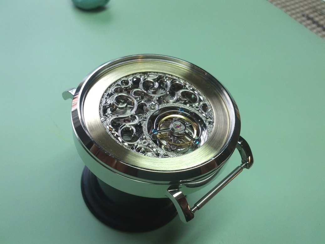

Well, I'm making a dial anyway! At least an outer dial ring to adapt it to one of my cases. Even though this movement has mounting points for dial feet, I'm making the dial to be "Friction Fit". This way, I can have almost all of the movement visible and not hiding behind the dial.

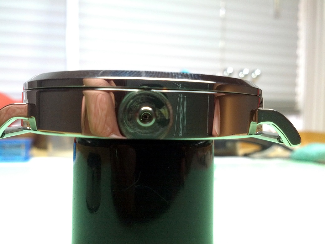

The movement is extremely thick and has the stem is located well towards the bottom of the movement. This is an awkward location for the stem with regards to mounting it in a unrelated case. I have to use a oversized case with enough room to adjust the location of the movement so that the stem lines up with the existing crown. Then I have to "relieve" the lip that the dial sits against to allow for the movement to be positioned in the exact location for the stem to line up with the crown.

I finished milling the dial and modifying the case to accept the movement....
Since the movement is Silver and the case is polished, I'm thinking of having the skeleton dial painted a flat gray or silver and have some fancy Arabic numerals printed in Navy/Royal Blue to match the Blue Breguet hands I plan on using.
I took a pic through the stem tube to show that the stem will now line up with the crown. I had to turn the dial seat down about 1mm so that the new movement would line up!
I still have to turn a ring for the back of the watch because the tourbillon movement is much smaller than the ETA 6497/98 movement that this case was intended for...
