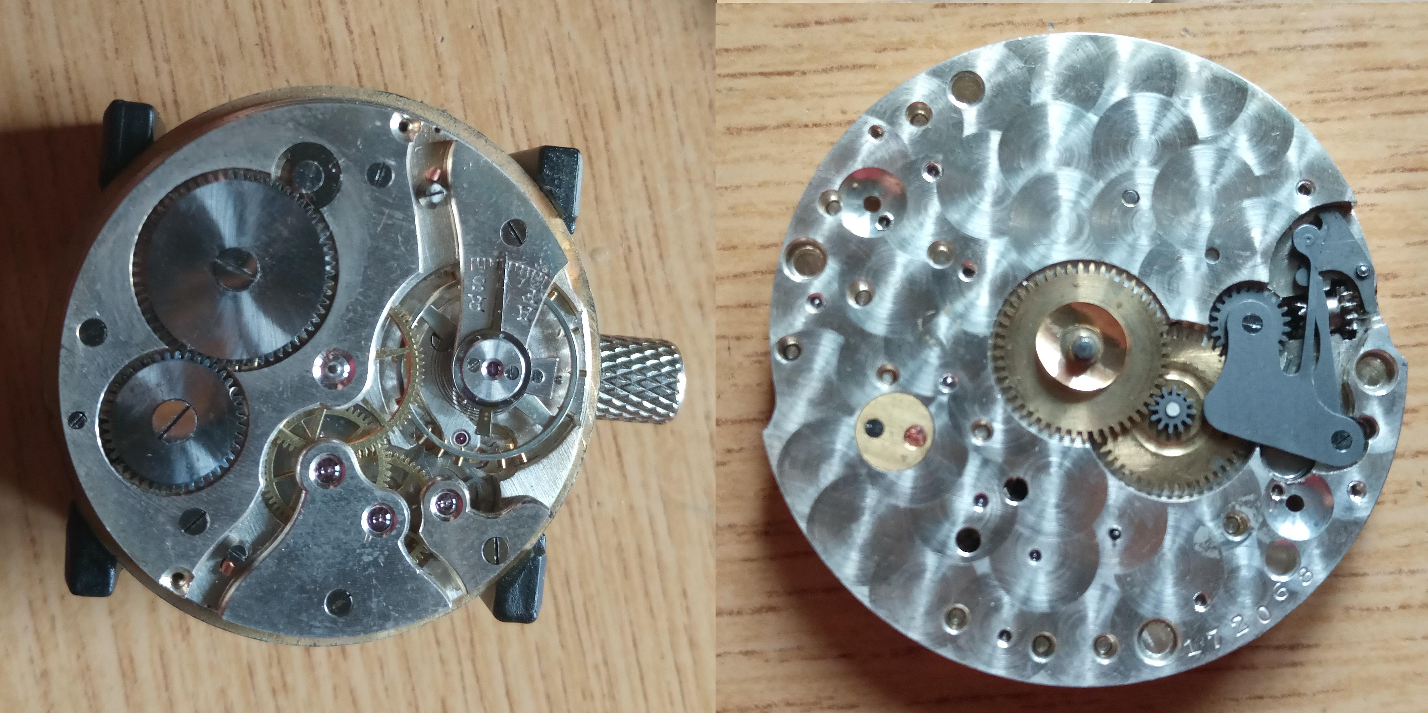

H=6.5MM Is to high and H=4.6MM Is to low the old one is H=5.1mm don't seem to have one  I'm stumpt sir

This is the watch

This is the watch
Well gentleman the story has a happy ending, I got the bit of the screw outt thanks for all the help,it unscrews to the left,your a great bunch of guys, I am very happy now,see thep pictures

How did you got the tiny bit out?
Btw, if you look to the right of the ranfft listing, you see a bunch of movements in that family. You can buy one of those and stick it in your movement if you struggle to find one of your model.
Check out Jules Borel watch parts database. They have a listing of all the parts and their interchange so in theory, you could buy one of those movements and swap parts.
Edit: I realized JohnR basically said the same thing higher up in the threads. Although Jules Borel is free to use for anyone.
