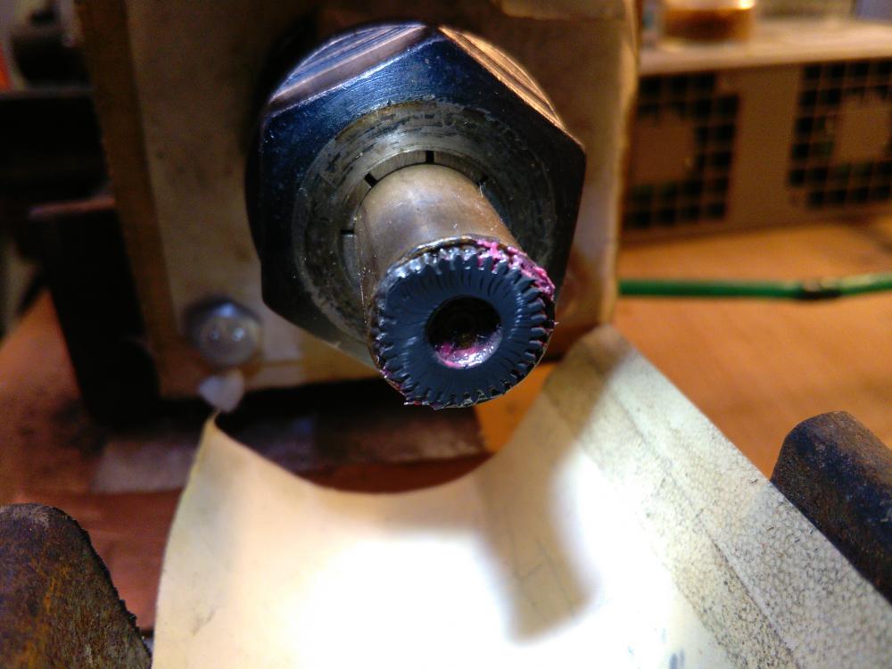

First try on a simple washer. It was not flat so flattened a bit on a whetstone, hence the radial scratches.
I was using chromium powder (Cr2O3) in oil. It has some fine grain. The snailing pattern is definately there but i need more coar.se paste and need to try grinder with different diameters and speeds.

Winding wheel on the wax chuck after grinding the pattern. It has the paste on it, but here one can clearly see the lines grinded in the material.
Washed with paint solvent:
Here is the retaining washer after finished grinding:
And in the movement with a blued screw :)
From a distance:
Tomorrow i will make a two stage pattern on the  ratchet wheel.
Looking good eh? :)
But lets take a closer look! Notice the part close to the middle was not grinded. I was not grinding long/deep enough. The grinder did not touch this part of the wheel. I missed this before started grinding the external circle.
I could start the grinding again but it will do in this watch, since the wheel is mounted with a plate hiding that part.
