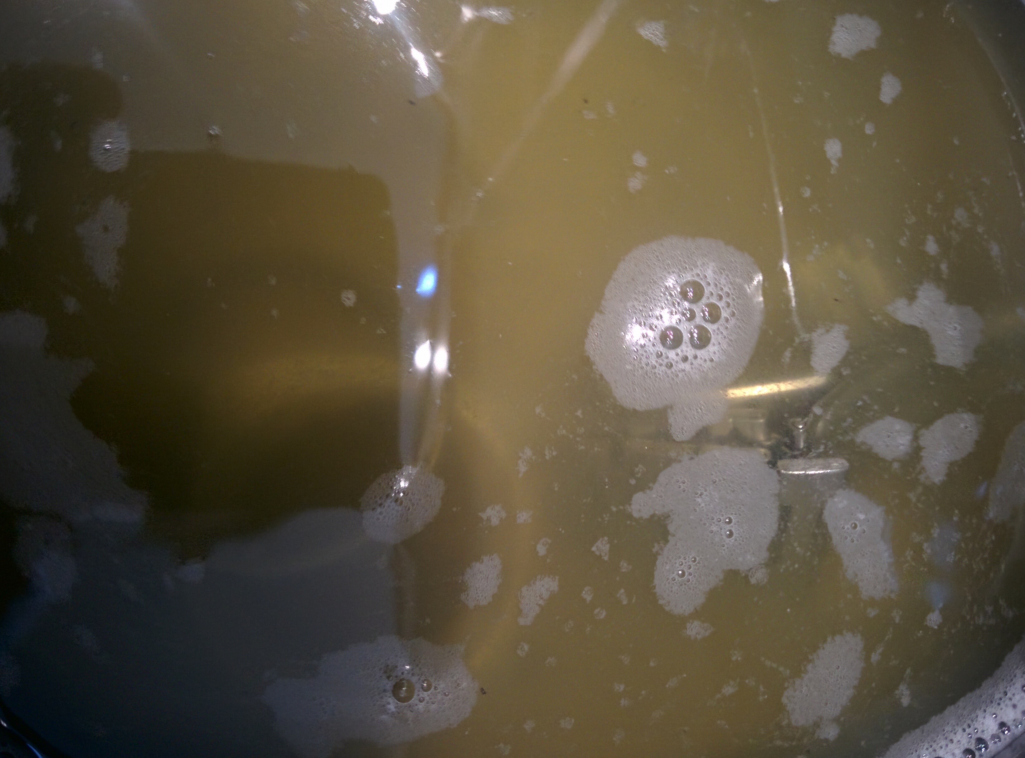

Hot water and a bit of dish soap works good for me- the hotter the water the better.  If there is any exposed brass I'll add a small amount of vinegar to just to shine it up.
that water is nasty.
i've taken to boiling my watch cases. there's no doubt about anything NOT living on the case when i'm done with it. an old toothbrush and detergent cleans up anything that is stubborn.
