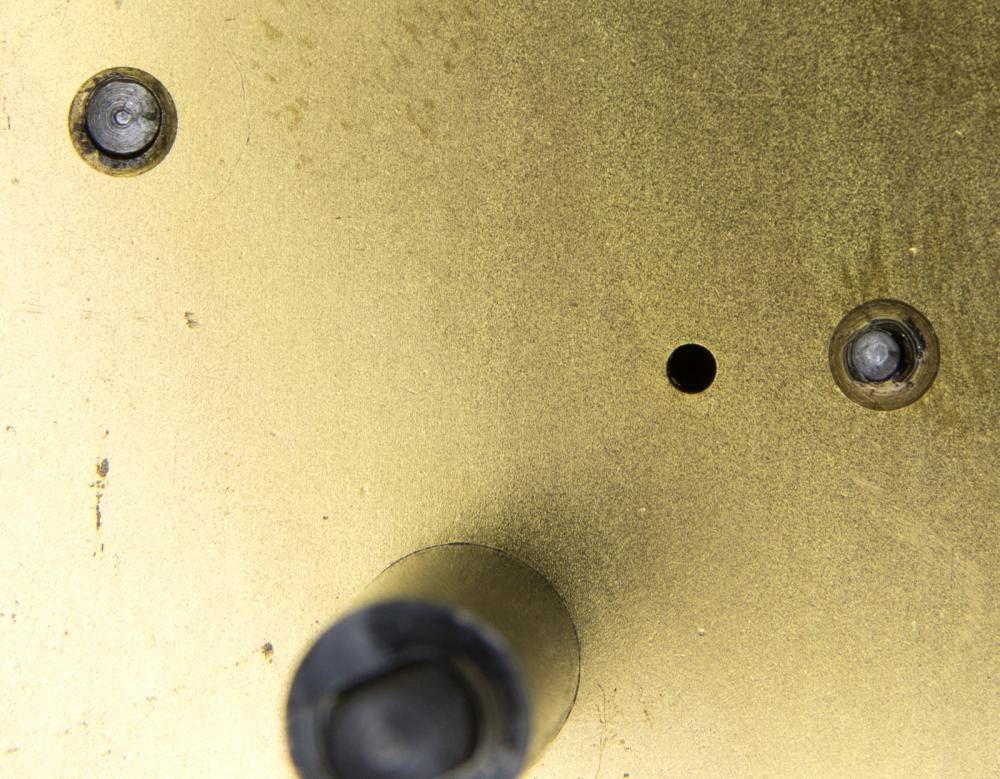

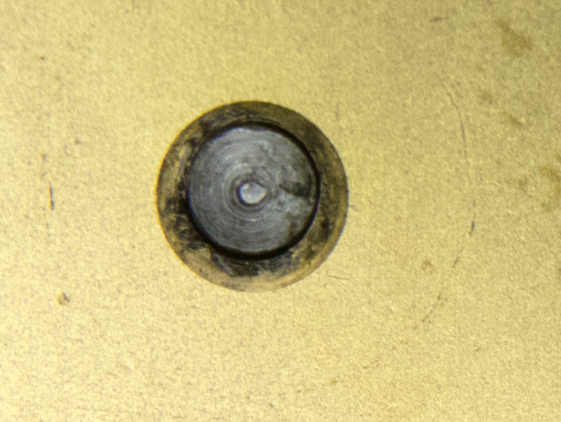

Again, thank you all for your contributions. As promised, I took a few pictures of the teeth of the barrel wheel and two pivot holes from wheels B and C.
There is a major play. I'd say up to 0.3mm or even more. When I move the barrel wheel, I can the axles see clearly move back and forth.
I do have a lathe and some brass. Would it work to turn a bushing of double diameter of the pivot, drill the pivot hole to the bushing diameter and press it in?
@oldhippy Do you think the gear is stuck due to the play in the pivots? Do you think that the highly worn barrel wheel prevents the gear from turning?
Thanks for your support.
The tops of the teeth from that barrel have worn right off due to the wear in the holes. This would not normally be as bad as this if it had been hard brass. Because the barrel teeth have lost there tops it is possible that by re-bushing the wheel next to the barrel it might not engage, the depth will certainly be wrong, it is also possible the pivots have worn. Have you compared both barrels to see how much of the teeth have worn off, it might need a new barrel. Wear like this will cause the whole of the strike side to bind together and prevent power getting through. To sort this out because of the worn teeth you will certainly need a clock depthing tool, then you will have to make the runners to hold a barrel, they only normaly come with runners for wheels that hold pivots.

Also if it's a cheap movement it may be possible to close the pivot holes with a staking set, messy and not a neat repair. With the wear to the barrel teeth as well and probable wear to the pivot I think success is unlikely.
Closing pivot holes in many old clocks was common practice, people lived in small villages and hamlets didn't have clock repairers but more likely they had a village black smith, that is the way they would close up a hole. I've seen some really nasty work undertaken that has damaged some lovely clocks. Some what can only be described as cowboys still do it.

Thank you all for your contributions. After @oldhippy mentioned, that I should compare it to the other barrel I really saw the mess. I will take pictures tonite. The bell barrel is fully intact as far as I can judge it. My idea is to switch the barrels to se at least if the clock is running again.
There is a company that still does the Schatz clocks in Germany, which I will contact and ask for spares. If I could get one barrel and the two plates I guess the job could be done.
Question
Again, what do you think of the idea of turning new brass bearings for the two pivots that are severely damaged? Then drill the existing pivot open (4mm maybe), and press in the new bearing. I have a small lathe (Proxxon PD 230) so I would be able to do that.
