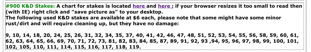

I somehow lost the punch for tightening cannon pinions for my staking set .  I thought I could just buy a replacement from K&D , Ebay , or other sources . But I have come up empty handed in finding a source for these individual parts . Any info is appreciated . Thanks , Louis

Uncle Larry's had this to offer :
1]... I think I need the # 14 peening punch..
2 ]...Not sure if the punch and stumps will fit my staking set , but it looks promising..
Cousins has this punch that I could modify to work . Shape it like a screwdriver..
Your set is likely 4mm. That became the standard after there had been 3mm and then some combination 4mm anvil with 3mm stake or something like that.
If you do have the 4mm set then you can buy any accessories that fit the Bergeon.
OFrei does offer NOS accessories at least for the Seitz tool, maybe the also have k&d?

I should have mentioned which set I had from the start . I have a Moseley Inversion Staking set manufactured by C & E Marshall Co.  I just measured the diameter of a couple of stakes and they were 4.5 mm . Is that an odd size or should I look for the 4mm that you mentioned ?
Thanks , Louis
The standard - if there is such a thing, perhaps most common is a better term - size for stakes in staking tools is 4.7mm. I'm not sure if there is a common size for the anvils in staking sets.
I think jguitron is referring to jewelling set sizes as Seitz have previously changed from 4mm to 3mm anvils (or vice versa, I can't remember). You can buy specific Bergeon cannon pinion tools (31001) for jewelling sets at Cousins UK and probably elsewhere.

Found the source I had been looking for. Interestingly I didn't find any specific info on the mm of the stakes and stumps. Here's a pic where there's specific reference to your staking tool:
Here's an illustration of the tightening of a cannon pinion:
My suggestion is that you look at any of he major retailers (Otto Frei, Cas-Ker, Borel, Cousins, etc) and purchase accessories for the Bergeron staking tool. It should fit well. If not you can always return the pieces.
Merry Christmas and happy staking!
The issue to be aware of is it is very,very easy to go to far with the methods suggested. Always have a piece of brass/tube inside the cannon before any taps/squeezes to help to avoid this.
If your staking tool has a micro adjustment screw then that is fine. However if not then if you can find one on the bay my preferred method is to use the Seitz jeweling tool that has a canon pinion stake. When used it puts the squeeze in a very precise and controlled way
