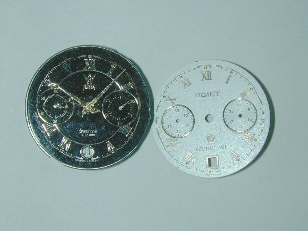

I just won another Poljot 3133, a Sturmanskie at that... and also this one is not working... Guess I will have plenty of work to do!
I am getting the fix on these...
Pictures from the seller are pretty good and the condition is, apparently, pretty good, judging from them. I only hope the problem is easy to resolve...
25 minutes ago, frenchie said:
Looks good... except for the hairspring that looks a little bit bent out of shape.
Yes you are right, and this is not the only issue apparently. I also noticed that the dial looks "strange"... Hope I can find pictures of an original, untouched Sturmanskie to compare.
According to some research I made and forum posts I found on watchuseek, there should be nothing bad about the dial nor the entire watch I bought. Actually, it appears to be one of the earliest models, from the first half of the 80s. On watchuseek.com I found the graph below. The Sturmanskie black and white logo, like the one I got, is no.7
I also attached another image of an identical watch, also found on the same thread over at watchuseek.com
Looking at that balance bridge screw, I don't think you will have been the first one to have been under the bridge before, it seems a bit proud but I have never worked on one of these and maybe it's meant to look like that.
Cheers, Vic
9 hours ago, Geo said:
Is that a hacking lever sitting on the top edge of the balance wheel?  If it is, no wonder it's not running.
Don't think that's a hacking lever, looks more like the rather badly deformed terminal curve of the H/S between the stud and the regulator.
Quite common damage when someone who doesn't know what they are doing plays with the regulator, moves it all the way to the fastest position so that the regulator goes beyond the dogleg to the terminal curve, then moves it back again. The dogleg gets jammed between the regulator pins ans as a result, it gets dragged round causing the H/S to buckle out between the regulator and the stud, pulling the rest of the H/S out of true and stopping the watch.
Provided it's not been too badly b*ggered it's a relatively easy fix and the watch is back to running condition.

It does look a bit proud to me too, Vich. These pictures are the sellers, I still did not receive the watch myself, so please wait till I update this post with my findings.

I will, but just from the seller pictures I can spot some problems here that are beyond the service....

This is also my line of thought. I analyzed the pictures of the seller, and it does appear to be exactly like you wrote. Hope we are not both wrong on this, which seems a pretty easy fix to be honest.
As I mentioned in one of my replies, there are other issues to this watch, apart the bet HS or just the need for a nice clean and service.
Check the picture here enclosed. Is it me, or this looks like a bad redial? If so, apparently I must be more careful with my purchases, since this would be the second time....
Clearly from the pictures attached, the seconds and minutes markers ring is offset in relation to the hour markers...
