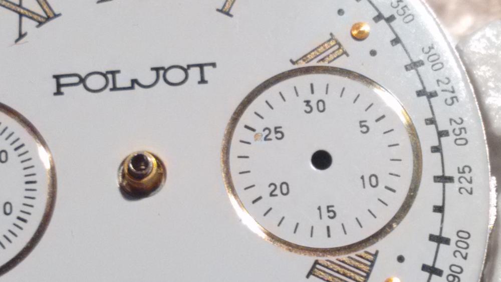

So yesterday I set myself up in checking the third Poljot 3133 I had received, this one only for the spare operating lever 8140 and spring 8335 that I needed for the Admiral watch.. And apart the fact the balance wheel assembly is completely missing, there are some other issues as well.... Check the pic... That is the minute runner wheel. Rust ate away the upper part that goes through the dial and onto which you should fix the minute runner hand.
AMD i nave to admit it has got me more than I thought...

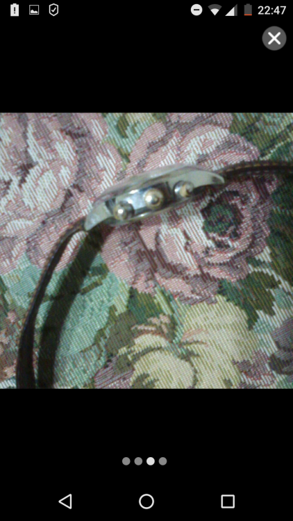

I will receive in the next couple of days another Poljot 3133 Chronograph in civil version, identical to the last one shown in my last posts. I made some screenshots with the mobile phone of the seller's images, so forgive the quality.
And the  fourth Poljot 3133 "Civil" arrived today, badly packaged inside a simple bubble envelope, bit still intact. Ironically, it sports a Seiko brown leather band.... Anyways it works fine and keeps excellent time from what I could see. No need to service this one, prolly only a light polish on the glass. Here it is side by side with the bigger brother, the Sturmanskie:
