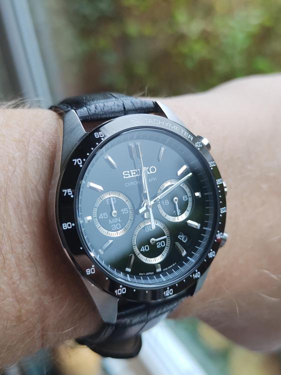

Seiko Spirit Chronograph SBTR021
Gifted to me by friend in Hong Kong. Bought in Tokyo by her on a trip to Japan. It's JDM only and I really love the look. Great value watch I believe with 10 ATM water resistance and Seiko 8T63 mechaquartz movement. My first chronograph and it's really growing on me.

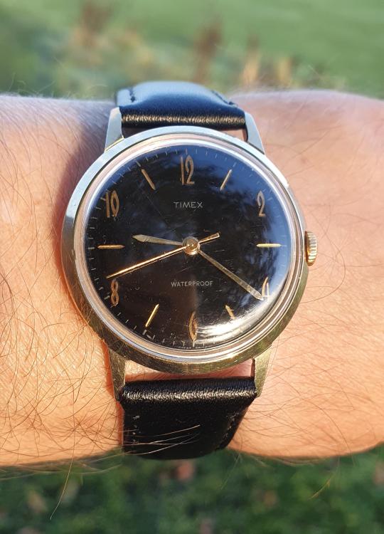

It's a glorious autumn morning here in Lancashire, out with the doggo, Maximus Lupus, and to assist with my life endeavours of punctuality, I present this rather fine and classy looking 1967 Timex marlin.20241026_092052.thumb.jpg.eab86b17729f4e1cbe0678f28b1f70a4.jpg

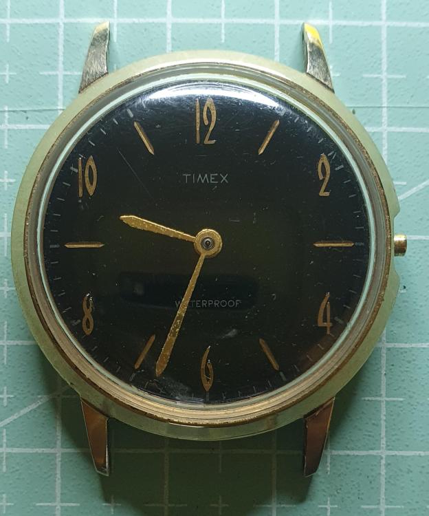

So this is only the second Timex I have ever worked on, so I'd thought to try an experiment, actually it's more of a brazen cheat and shoddy corner cutting but experiment sounds way better. I expect we all do a bit of research when working on something different, and with Timex movements this dunk and swish approach seemed to be acceptable, although I appreciate it's more for the movements that are rivited, so thought I'd give it a go.
I gave the movement far more than a dunk and swish, stripped off all the external components, everything soaked in isopropanol overnight, scrubbed all reachable areas with a brush then two twenty minute stints, in isopropanol, on a 40 degree setting in the ultrasonic. Well it looked the part after all that, re assembled,oiled, given full wind and ..... well it ran, but very poorly, kind of like a fuel starved austin allegro. Released the spring tension and that was enough to tell me to start again and do it properly, the spring didn't unwind smoothly at all, speeding then slowing, that spring had to come out. Once stripped, also now got the opportunity to properly inspect the components, found the pins on the pallet not nice and smooth but pitted with a rough looking surface.
I acquired, some years ago, a large box full of movements components and scraps, primarily as a source of screws. I had no idea until recently that a lot of the bits were from Timex movements, well that was fortunate, decent replacement pallet, setting lever and screw, crown and stem, all now sorted, the only thing I had to pinch from another watch was the second hand.
Now the movement running much better and an acceptable if somewhat untidy readout on the timegrapher, amplitude could do with improvement but suspect just need to allow the oil to work around the escape. The case cleaned up very well and the crystal, which is glass on this one, not too badly scratched.
Very comfortable on the wrist, I'll give it a good weeks outing and see how it peforms.

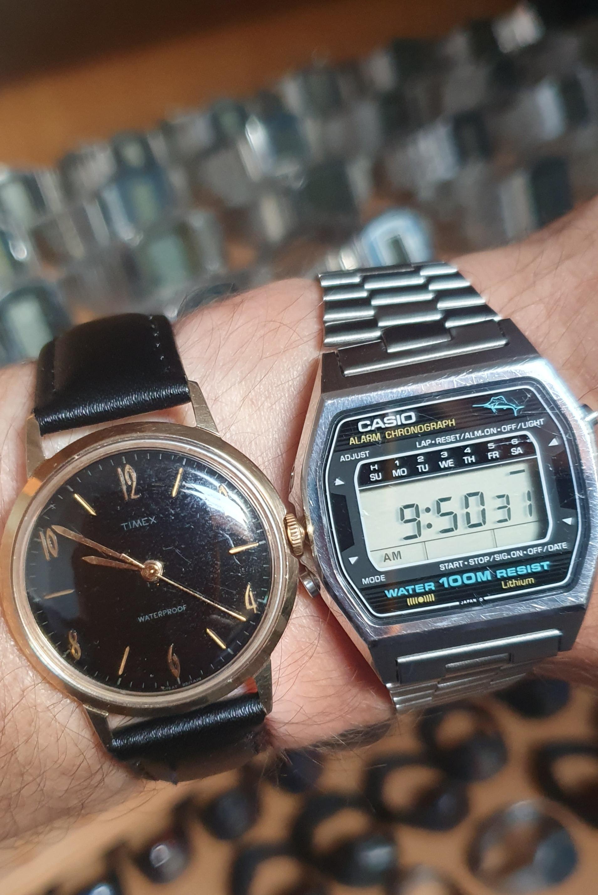

And of course, given the opportunity I'm compelled to give you a side by side pucture of marlins, so for any digital fans, here's a treat, the rare and extremely hard to find W550.20241026_095031.thumb.jpg.e8e23b421175afe4ef8dd31a1f8c7e57.jpg
And just one more closing thought, shouldn't a waterproof Timex from Dundee be the Timex mackerel, or the Timex mullet. I know it's not quite as appealing as the Timex marlin, but there aint no marlins off our shores.

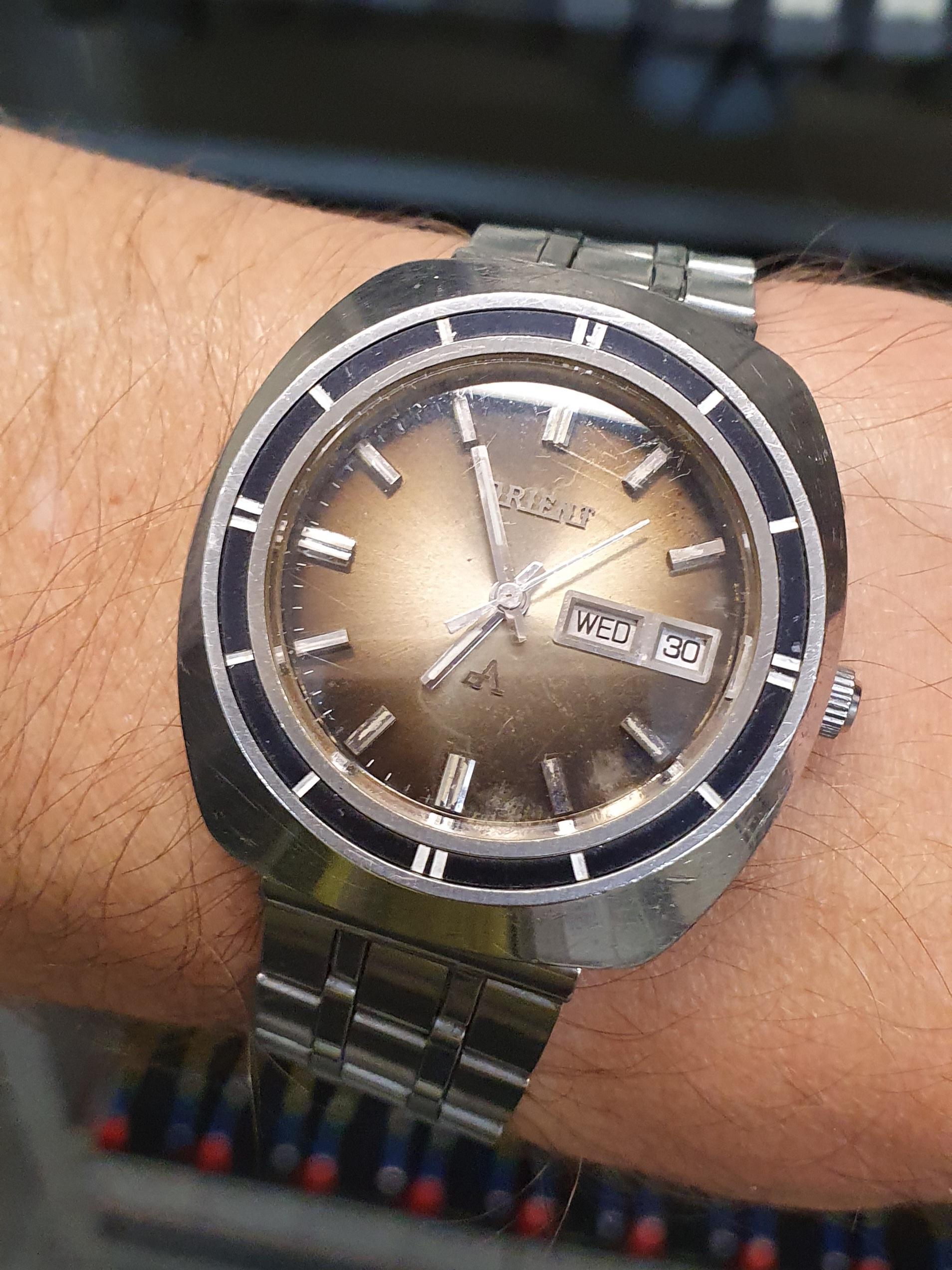

So I thought I'd go back to where it all started for me with mechanical watches. This Orient chronoace with the 21 jewel 42940 movement.20241030_065552.thumb.jpg.fc600b742b26eb25b709e5dd1fb59cee.jpg20241030_070059.thumb.jpg.fed0ffbf19f46e6c6cc3731ed41bf19e.jpg
Probably not the wisest choice for a first movement, but it was available, came with a lot of digitals. This movement was rusty! If I ever come by a watch as bad as this was again, it won't be getting sorted, I'll be looking for a donor. But as a keen new starter, soldiered on, slowly assembled as replacement components arrived, and eventually ended up with a working watch, I was pleased.
I should probably strip and service again now that I've got a lot more experience under my belt, but it's running fine. It did dawn on me though whilst I was getting this up and running again that it's never had a ride on the timegrapher. Amplitude was ok, just ok, running way too fast, throttled down accordingly and the beat error 0.1! I can only assume that was good before the rust set in and miraculously I didn't mess it up.
The rust damage had creeped around onto the dial, clearly visible are the areas that I learned that watch dials don't like being cleaned.
My first success, I wear with pride.
