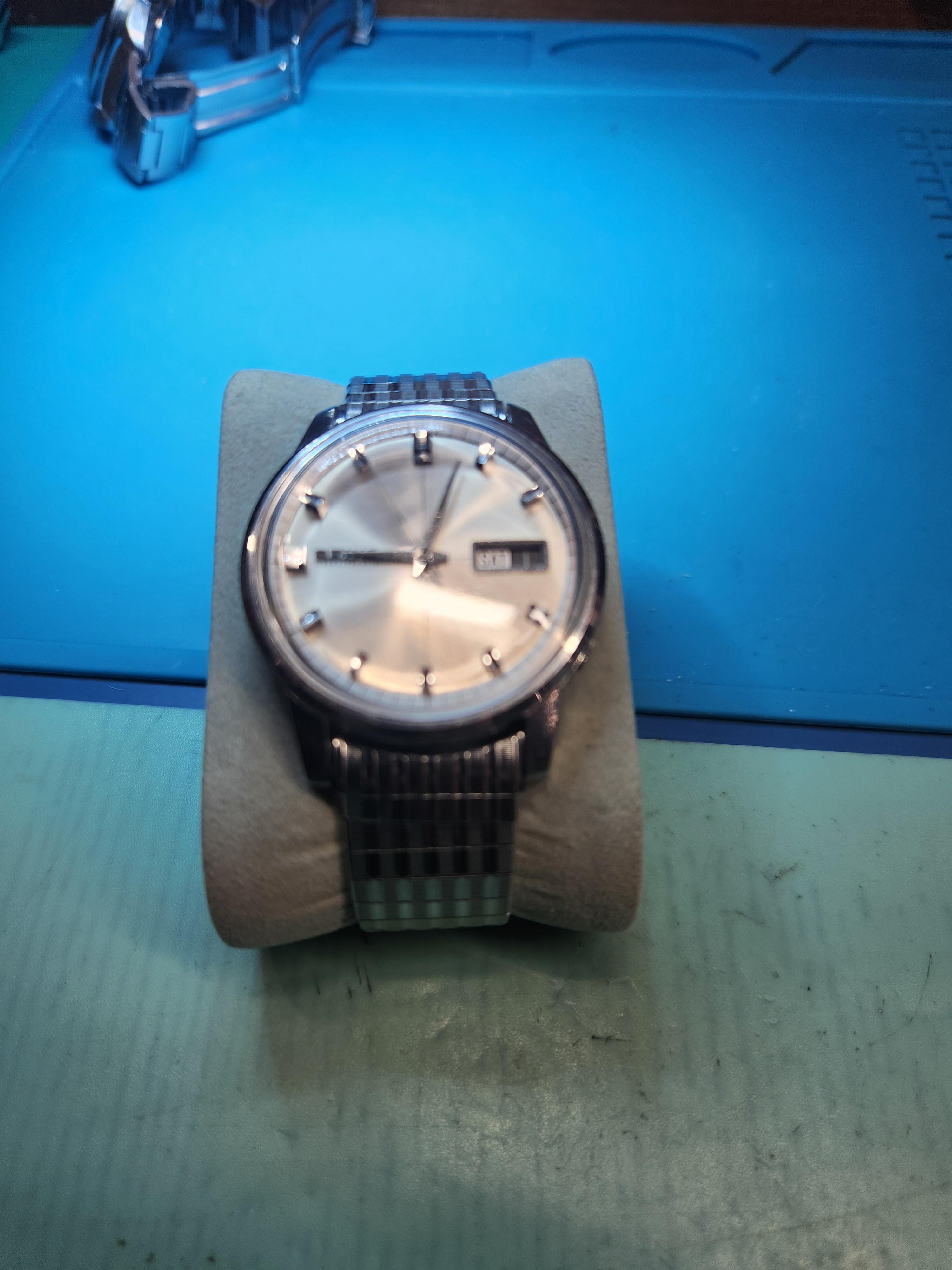

Finished this watch last night, I'm guessing mid 70's20241112_074004.thumb.jpg.4e6d73ffd03463583ff74fc0c5d60cae.jpg
So it's a 17 jewel Corvair, I've not worked on this brand before, looking at other Corvair watches, they all seem to have Swiss Made on the dials, but this one has Fr Ebauche on the dial. So no surprise then to find a FE 104 2-A movement within.20241111_193801.thumb.jpg.d0f440285a7782335030061fb7cc25d1.jpg
Again, never worked on an FE movement so all good experience, all pretty straight forward, although 16 of the 17 jewels all in the normal places, but to my knowledge, I've not seen one here before:20241109_110222.thumb.jpg.2a244a470c566ce8ce0c0eb2529ba09a.jpg
I will say though, the day date change really is excellent on this movement. With no quick set I was expecting hard work getting it set, but with careful back and forward hand setting it was actually quite quick and easy.
The only real issue I had with this movement was the hairspring, ran fine with very little wind, but with full wind the spring coils colliding killing the momentum. So a bit of manipulation and eventually running well on full wind. I admit, hairspring manipulation not one of my strong points so some good practice and experience gained here, more needed though.

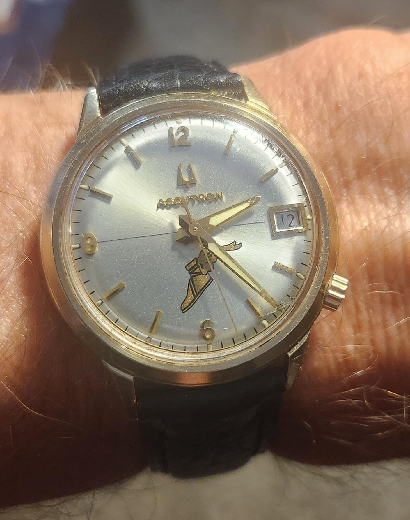

I showed this one as part of a lot in the 10:10 club thread. Was not working and one a speidel flex bracelet
 A 218 1 from 1975. Presentation piece from Goodyear. Could use a crystal. Sourced an accucell. Put on a decent band. It was a bugger to get going. Will need a full service but could feel the buzz but just would not move. Finally after reading the chapter and going back 2 or 3 times to the book realized it was probably just gunked up. Can't find one dip so used a slight bit of carburetor cleaner and a fine oiler to clean the debris off the pawl stones and micro adjust them on the index wheel
 20241112_1423262.thumb.jpg.1a72b09a24dbdc34abc0b013c092ffca.jpgDSCN62652.thumb.JPG.1583b94b2dd3f81f7235e47372ac7685.JPG
Since I got it running about 4 hours ago it has not lost or gain 1 second. It is as smooth a sweep second hand I have ever seen in person. Very mesmerizing...

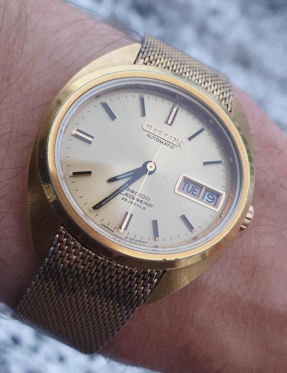

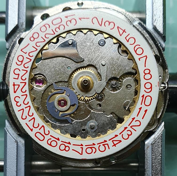

For the last couple of days, I've been giving this big cat some exercise20241119_073432.thumb.jpg.e0ff5f29dcec69e492e1409bead3c679.jpg
Citizen Leopard, 1972 with the 28 jewel 7230 movement full of springs.
I've had this for quite a while and must be over a year ago it was serviced and repaired. The rotor weight was adrift on one rivet and that all tightened up nicely. When I finished it, was running excellently, the cannon pinion a little on the loose side but coping well with the day date change so left it alone. I won't attempt to tighten these unless absolutely necessary, I'm still on the lookout for one for a different watch that I over tightened. A replacement for this movement I would imagine would also be hard to find, and it's coping with the day date change.
Until recently, I never got to wear this after the service, when I did want to, and went to set it up, discovered it had developed an issue where the hands would lock up when passing through the midnight change over. By this time, another watch all stripped down and taking up the bench, so this got sidelined.
Well I've eventually got round to it and I have eliminated the persistent niggle in the back of my mind to get this sorted. Very simple fix in the end, and a basic mistake on my behalf. Found the date ring retaining plate / quick set rocker spring (circled in picture below) was not fully home on the left hand stud causing the right hand side of the plate to dip down enough for the date ring teeth to catch on. Lucky escape for me, if I had tried to force it then the plastic day date cam would have been damaged, again, I reckon they won't be easy to find.20241120_101350.thumb.jpg.130d30723cfef9ece4733b295966df46.jpg

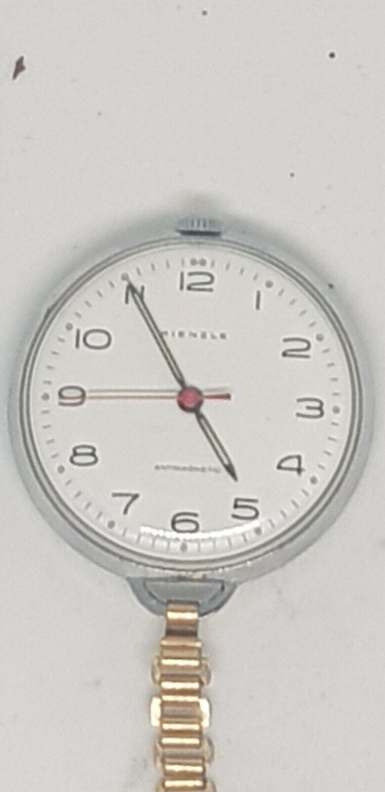

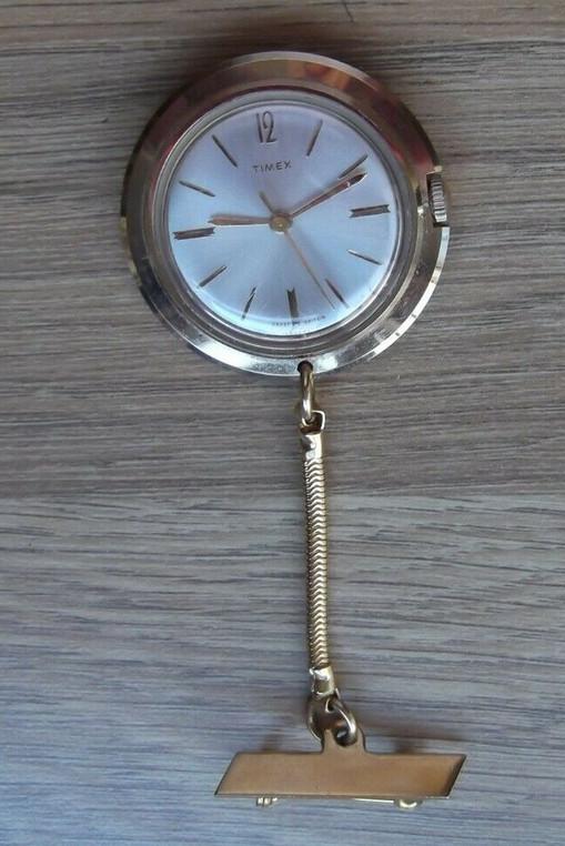

If both of the bottom lugs, or both of the top lugs are missing, that may be because someone was using it clipped to their lapel in the same manner as doctors or nurses watches.
These two are designed that way, but if you already have a watch , "converting it" by removing two lugs, and hanging it from a short leather strap piece is fairly simple.
Assuming the lugs didn't break off in normal wear, someone may have deliberately removed them to stop them from catching on their clothing if they wanted to  wear the watch this way.

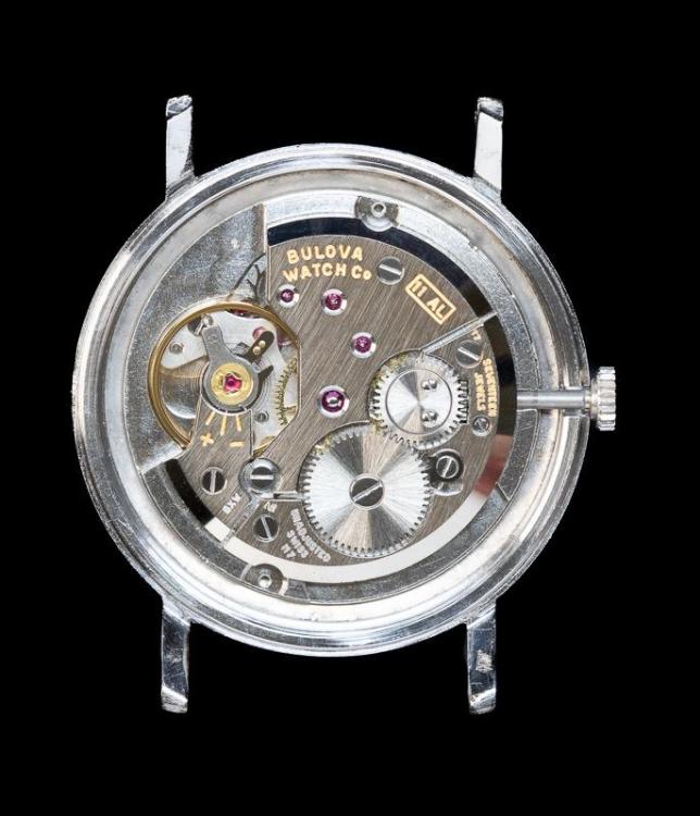

No one has posted in over a month, let's change that. Here is a nice example of the 1965 Bulova Diamond Excellency 'B' with a 17 jewel 11AL movement. I love the faceted crystal, the light play as it bounces off the facets and that diamond at 12 o'clock really adds some pizzazz.
