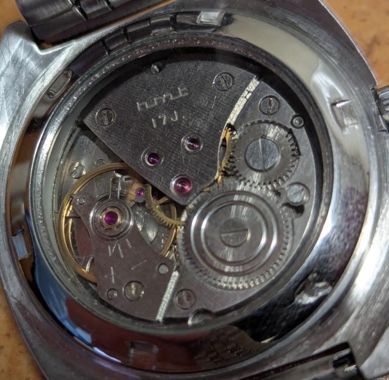

Wine-red HMT Kohinoor I got on a new bracelet for $25. The watch isn't supposed to be new, but it looks and performs like it is. It runs well enough that I am not going to bother servicing it, as had been desperately needed with my other 4 or 5 HMTs. For all I know the bracelet was molded out of tin foil but it was still in plastic, looks nice, and the package took under 2 weeks to get from India. They even upgraded it to a display caseback.

Lovely red iridescent dial Michael,  how are these movements to work on ? I've never tried one.
They have a few surprises. First, the ratchet wheel screw is left hand thread in addition to the crown wheel, but there is almost never a 3-slot screw to indicate that. You learn by breaking one. The mainspring is lefthand wound like a lot of Japanese movements (which ancestrally this is). The newer ones (as opposed to one from the 1960's or 70's) are made from extremely soft metals. The screws are like butter so it is very easy to twist the head off that ratchet wheel screw or to strip out other screws. The stems are also very soft. Twice I have tried to unscrew a crown and just twisted a stem in half.
And because of that, the watches can be in all kinds of crazy states. This one is pristine, but my others all had workarounds like shellacked hairspring studs, stripped or missing plate screws, the dials are often redials on other models, badly painted onto brass blanks having no dial feet, missing movement rings, missing case tubes, etc, etc, etc.
The "Parashock" system is nice. It has a hole jewel set into a tiny spiral spring, offering both lateral and axial protection, and then an end stone set in a thing with only two tabs. Drop in the hole jewel then insert one tab of the end stone and align the other with the slot, turn. It is the easiest of any type I have had to install and even managed not to break or lose any on one of my first watch services.
Interesting and challenging movements.
They're very simple and straightforward as long as you make no assumptions and take nothing for granted.

Sure - as far as I am aware, all manual wind HMT use the HMT 0231 which is based on the Citizen 0201. They bought the tooling from Citizen in the 1960s.
This example has the nicer ratchet and crown wheels. Most have plain unpolished, undecorated metal. I can't open the case back now but you can find other pictures of the 0231.
Looks like the Caravelle 11DP, which is also based on the 0231. Bulova was nice enough to indicate the left handed threads on the crown and ratchet wheels though. I really like working on this movement, very straight forward. The spring on the setting lever can be a little tricky but once you know how it's straight forward.

Interesting, thanks! Yes, it sure looks like a Citizen/Miyota and of course the Parashock jewels.
I only have the best experience of working on Citizen and Miyota movements. They are, as you put it, straightforward (for the most part), especially compared to Seiko's movements which I find to be pretty quirky.
Yes, that is an odd design on these movements. I really like working with the Parashock system though. Just be careful with the HMT movements, as they are the flimsiest metal.
