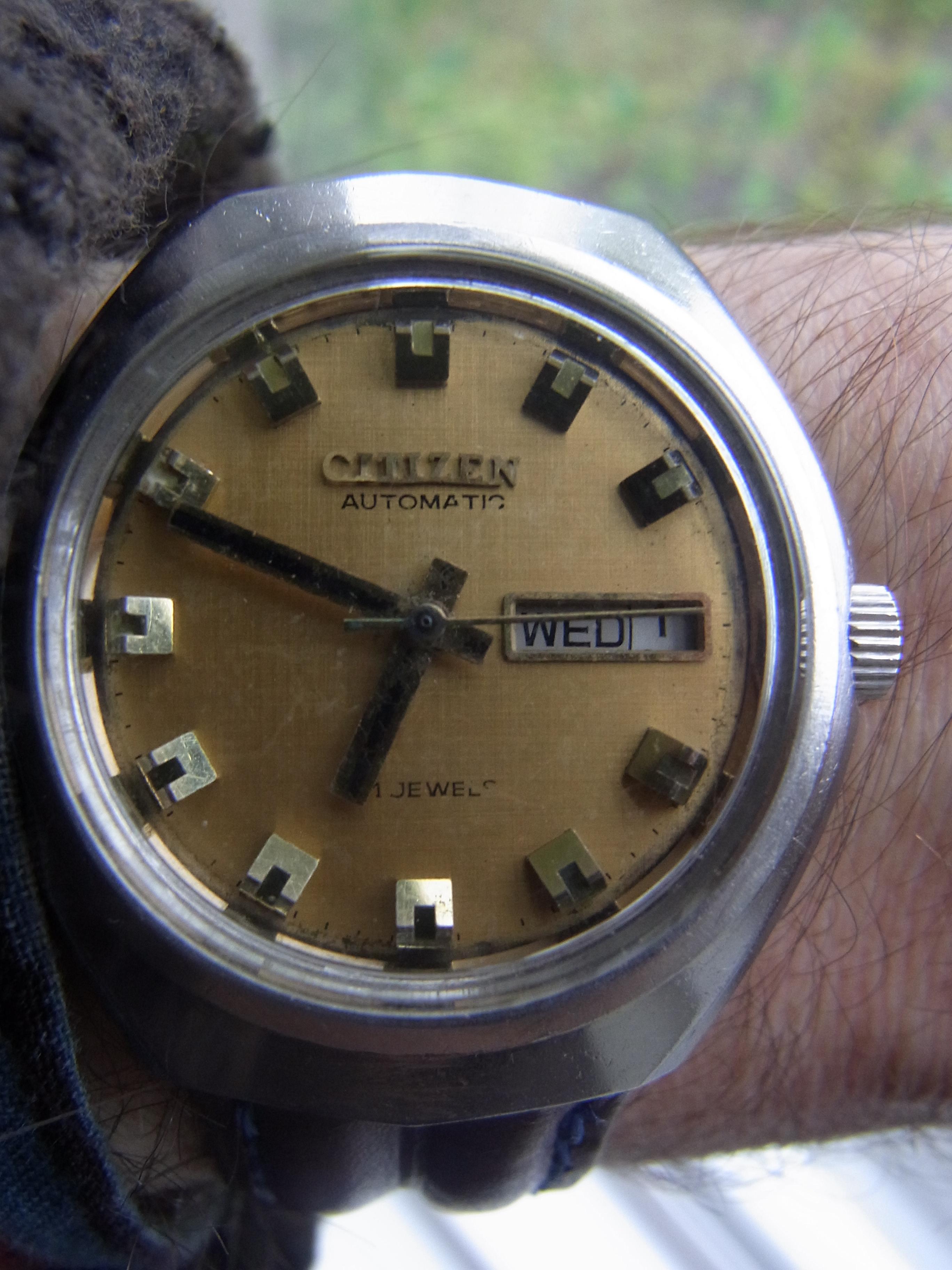

Today's watch, fresh from the healing bench is a Citizen 21 Jewel "Parawater" (so most probably from 1971). It arrived looking a little miserable, and struggling to tick.
I took a quick look at it shortly after it arrived, and got it going, but I wasn't 100% happy with it, so it received a little more TLC, and is going considerably better. I might be able to get the beat error down a fraction more, but since I decided to quit while I was ahead.
The date changer is also working correctly now too.
Now that it is running reasonably well, and has survived a day on my wrist without complaining, I'm might see if I can bring back a bit more of the original shine.

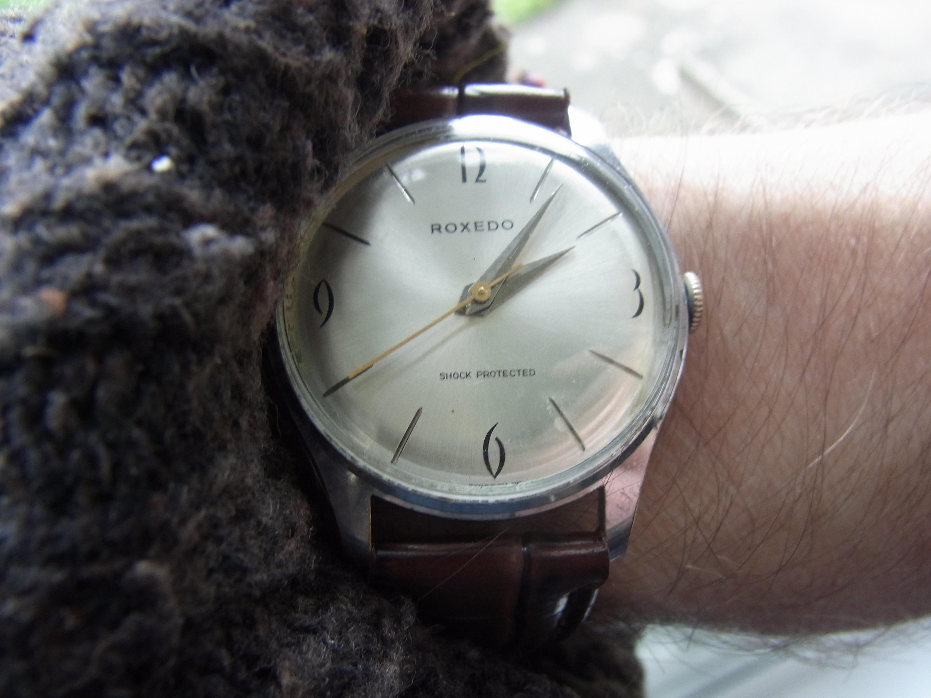

An old favorite, the Roxedo EB 8800 pin lever is back on my wrist today.
I like the simple uncluttered elegance of the design of this piece. It make a very readable, robust and comfortable daily wearer.

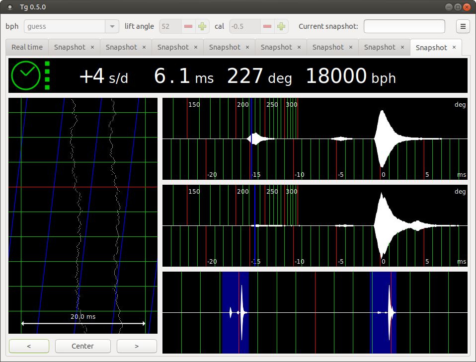

Just for fun, I stuck the Roxedo on the time grapher.
Bear in mind, this is a pin lever, which I replaced the balance and fork in,  back in November with one from a scrap movement. It also was cleaned and adjusted. There is no simple way to adjust the beat error, so back then, I just left it as it was, and set the rate, rather than risk fiddling with the hairspring.
This is how it looked when it arrived with the broken fork and dodgy balance.
Today all I did was  grab it wind it and stuck it on my wrist.
It is far from perfect, and certainly wouldn't win any prizes but for those doubters that say pin levers are rubbish, unreliable and don't last, this thing has been clacking away like an old alarm clock, probably since the 1970s or perhaps even the late 1960s, judging by the style, and is still keeping reasonable time.
I'm pretty happy with those numbers.
There is really nothing wrong with pin levers.They were built to satisfy a market segment. I think they suffer more from shoddy cases than anything else.Generally they were poorly sealed and allowed both water and dirt to enter. Which is a bad recipe for any watch regardless of construction..Lack of shock proofing was also a problem.
