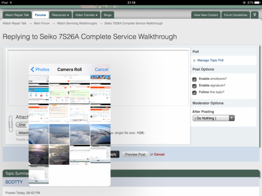

Maybe it is also a spring issue Scotty...for the pictures you need to use the "more reply options" and upload them. Then position the cursor where you want them and click the "add pictures".

I'm having trouble finalizing a post with pics on this topic.  HELP !!   :pulling-hair-out:
If you mean when yo are trying to attach a picture when replying.
(1) Click on the "More Reply Options" at the bottom right hand side.
(2) Click on "Chose File" button and a drop down menu will appear.
(3) Click on "Photo Library"
(4) Select image.
(5) Click on "Attach This File"
(6) Click on "Add To Post"
(7) Click on "Preview Post"
(8) The picture should appear.
(9) Finally click "Add Reply" and jobs done!
Hope this works..........  I dont believe it !!  I thought I did this before. Must have missed something. Thanks Geo. Anyway, if anyone notices something wrong with the h.s. let me know. Thanks !
