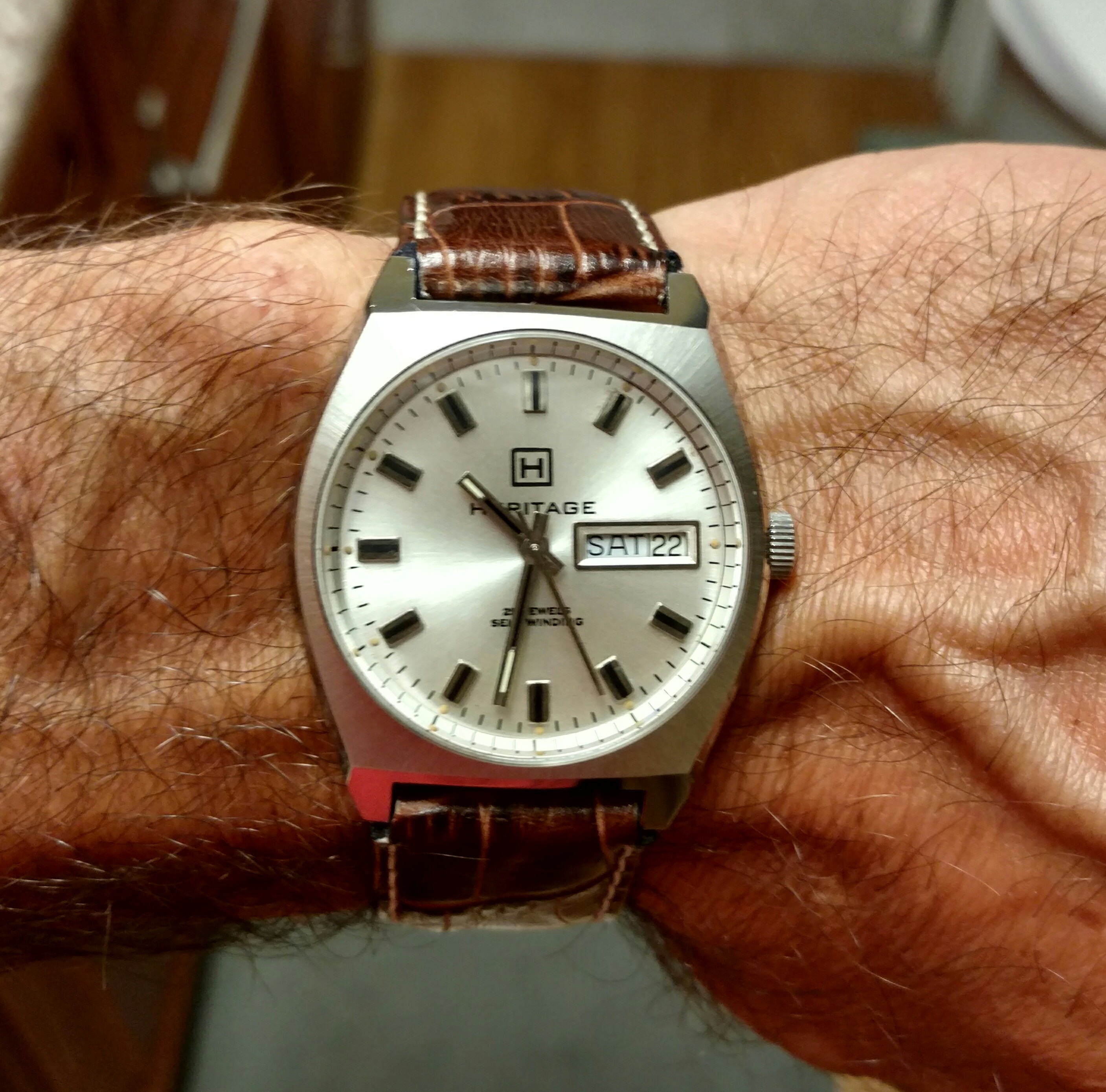

Here's a blast from the past! Well over the last two to three years I've figured out that people don't really care about my personal logo and are actually are kind of put off by it.
The watches that I've sold with my logo have routinely sold for less than watches that I print with maybe the manufacturer's name of the movement on the dial or just a blank dial. That's just a little disappointing but I understand why...
So I've spent the last few weeks trying to come up with something that would still tell my story but would not look such like a personalized dial which is someone's initials..
I settled on this one...
Heritage... To me this says a lot about my work. I use mostly vintage movements to produce watches and I like to think of these movements as having a history or "Heritage".
That's a shame about the sales results Don, I personally liked your logo.  The Heritage one doesn't really do it for me.  Have you done any kind of customer surveys see what folk think of Heritage?
I like the idea of the name of the movement in small letters above your initials with custom underneath.  That way folks would know exactly what the watch is  and that it was customised by you.
Heritage does't do it for either... it also reminds me of the Heritage Foundation (a US "conservative" "think" tank, ardent supporters of Donald...)
What if you made your logo a bit smaller, so that it's more discreet? I also like Geo's idea about the movement name.
Edited by frenchie
I have asked and received feedback from my best customers and it has been unanimously good...
I like the idea of using my djw logo adding the caliber number on the dial too, but that can get a bit crazy if the caliber has a long designation. And I'd have to create a different printing plate for every caliber... Just thinking out loud.<_<
We'll,  I did a test print on a vintage NOS watch... I think it works.. it's a little lower on the dial than I like but I think the scale is good.
Personally I like it a lot. Also I would leave the "Heritage" in it's present position just move the 22 jewels, self wind" lines down a touch. Can to fiddle with this using a "Indesign or Illustrator" type software.
