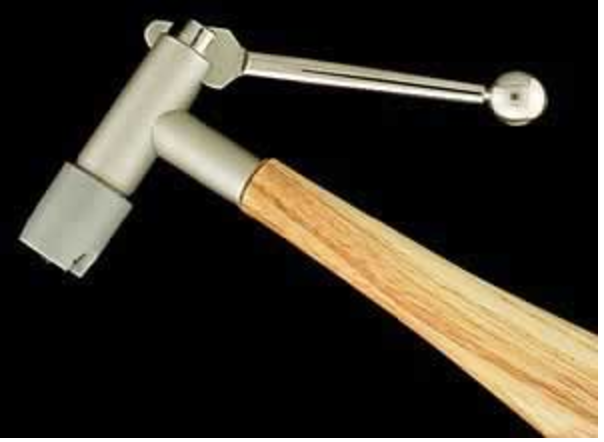

Did you try this type of cannon pinion remover ?

For Noirrac1j, yes I have a cannon pinion remover and that couldn't shift it.
