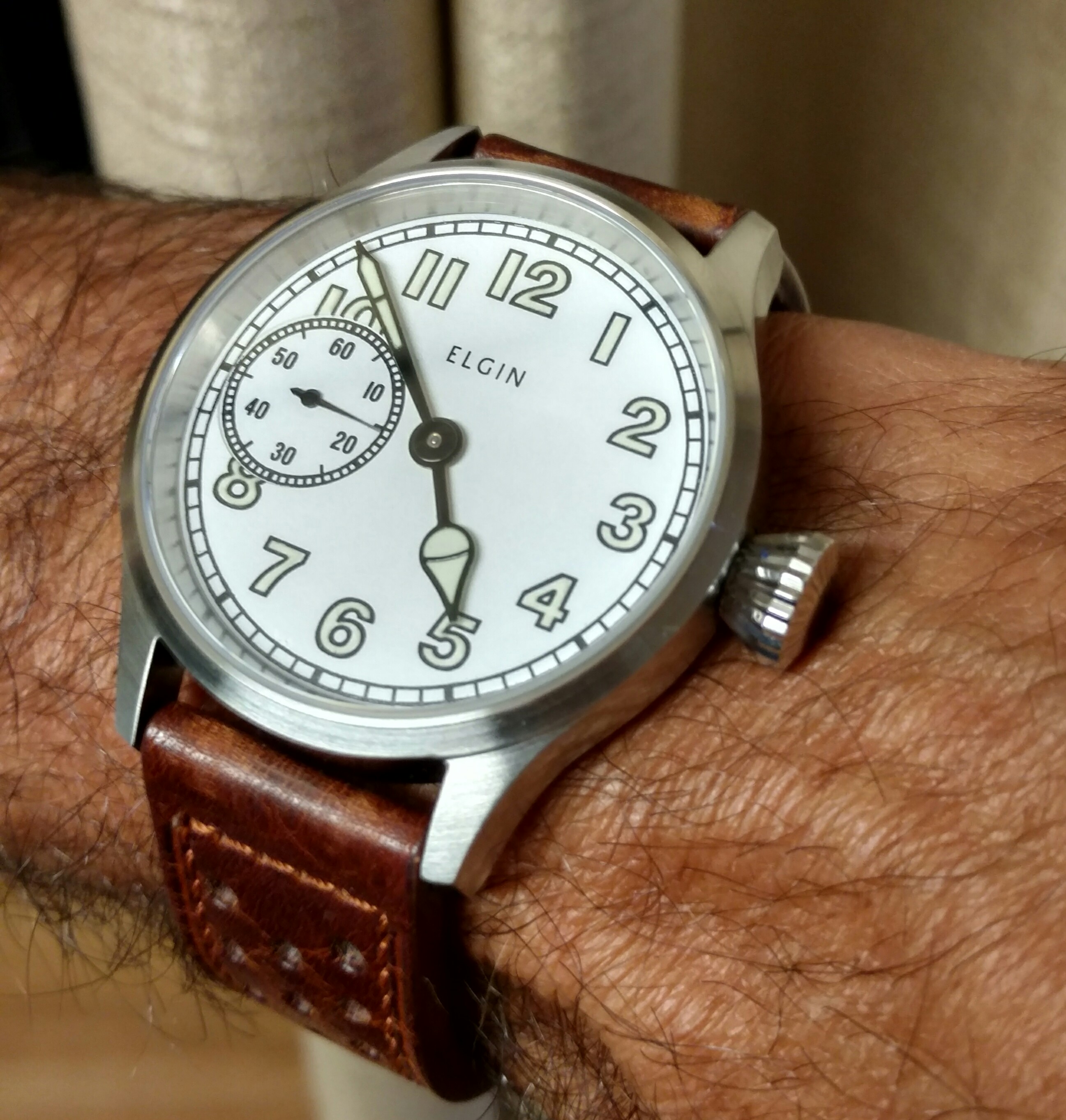

I'm very satisfied with how this dial turned out. I'm building and Elgin pocket watch conversion into wristwatch and wanted a vintage military dial look.

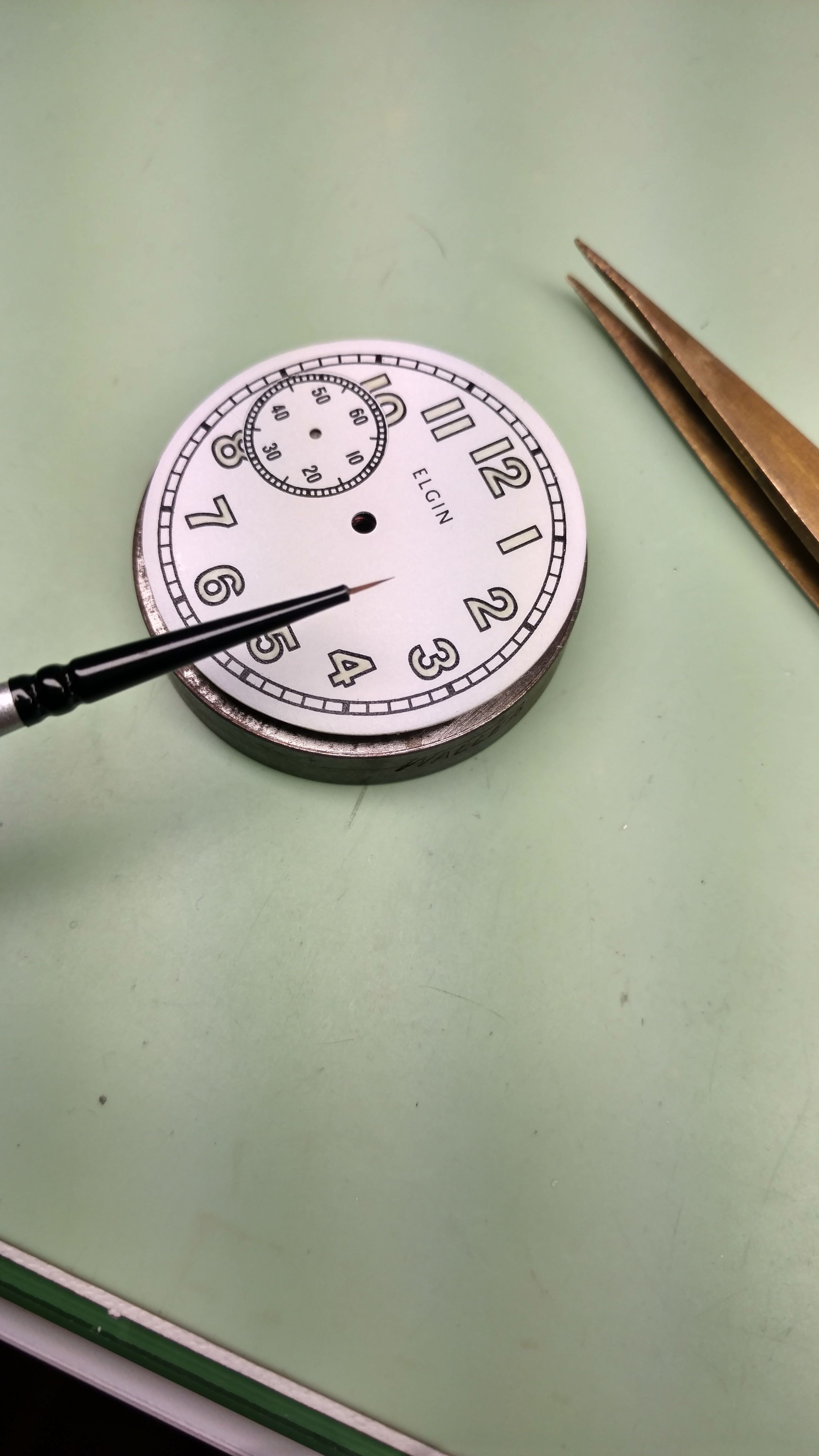

I had recently purchased a lume kit but hadn't had the chance to use it yet. I design the dial with bold outlined numerals for the purpose of filling with lume. It really turned out better than I ever hoped!
The first dial I did turned out very acceptable, except that I had another issue with it and had to start over. I learned quite a bit just from doing that one dial.
Once I had the printing plate made I repainted the original Elgin dial to a flat white. I then Inked the plate and printed the new dial. Once everything was dry I then slowly added the lume using a 100 - 0 paintbrush which is about the size of a watch Oiler. I went around the dial 4 times adding a layer little by little. I'm very surprised just how much Lume this process adds. The markers have a nice three-dimensional heft to them...

Very nice, If you ever feel like posting how you created the dial I would be interested in that too.
This is so nice job! Is the pad printer a DIY one?
In a few decades i will also be able to do this job :)
Next, You could also try to print the lume paint with the pad printer ;)
Beautiful in all aspects. I too am VERY curious as to how you've done it. Not that I would ever be able to do this haha...
I will try to put together a walk-through of the process of dial printing along with creating the plate itself. Honestly I spend more time on the computer designing the dial layout then it takes two create the actual plate or print the dial.:wacko:

It's nothing secret, but beside the printing "machine" itself, the need to use a precisely engraved plate places the job largely outside the domain of the average hobbyist and even professional watchmaker  I think that if you can find someone that makes the plate on your design, or are willing to spend pretty good money on a CNC machine that does that, you could be game. I don't know if 3D printing would do a good enough plate. Fact is, at the present time dial making/reprinting specialists are rare.
