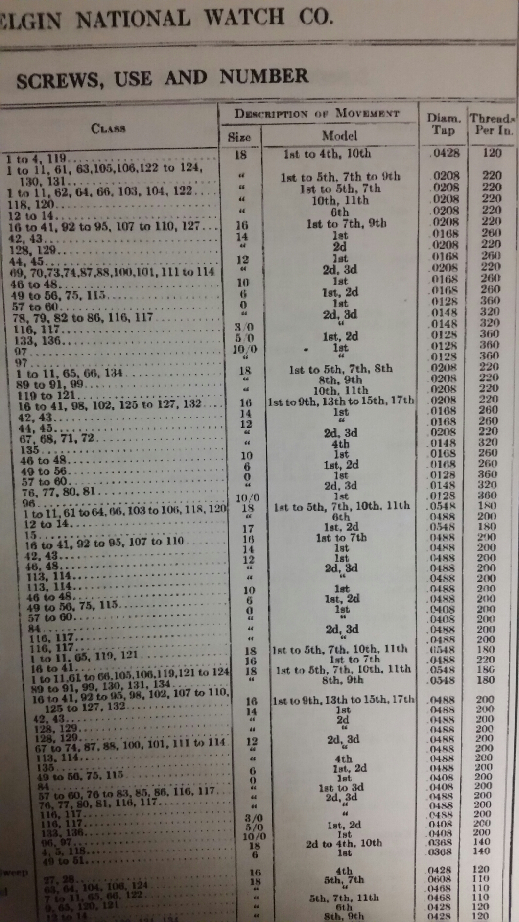

I just checked my Elgin catalog and there are 8 pages of screws. Just. Screws. I've attached a photo of just the first page, if you're interested I can post a link to the whole pdf file.
Thanks mate that would be great.....
Elgin and Watham made their own thread sizes for their pocket watches so you cant buy new taps and dies to fit their old watches. You need to find an old set off ebay when they turn up that are hotly contested.
Guessing the newer wristwatches made by the Swiss branded as Waltham and Elgin used metric threads
