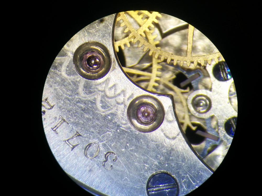

The watch winds, and I've verified that there are no blockages in the gear train (torque is getting to the escape wheel when the watch is wound). The hairspring and balance all seem ok, but the balance/escape wheel interaction doesn't seem correct and the watch does not tick. Watch is dry.

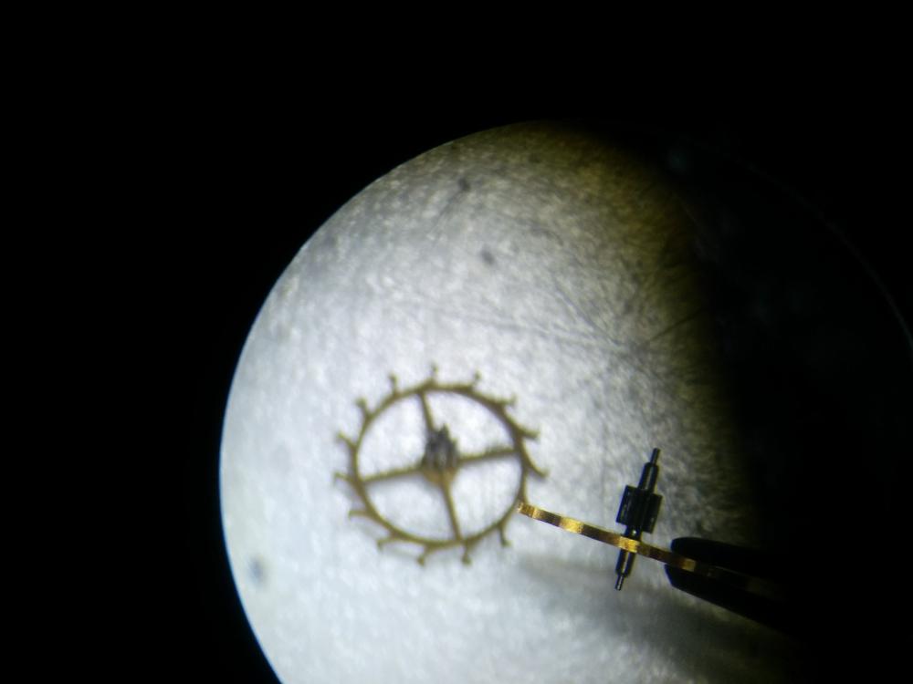

Initially on inspection I noticed that the escape wheel jewel was badly cracked, and thought that this was the reason the escape wheel wasn't operating properly. I obtained an identical movement from the same period with unbroken jewels and swapped the escape wheel bridge, but the escape wheel was still getting stuck.
IMG_20171007_141614.thumb.jpg.d91166bfe756b685e3c2f7355af97949.jpgIMG_20171007_150226.thumb.jpg.1a39477f1c07aa99af2981fb791c4abc.jpg

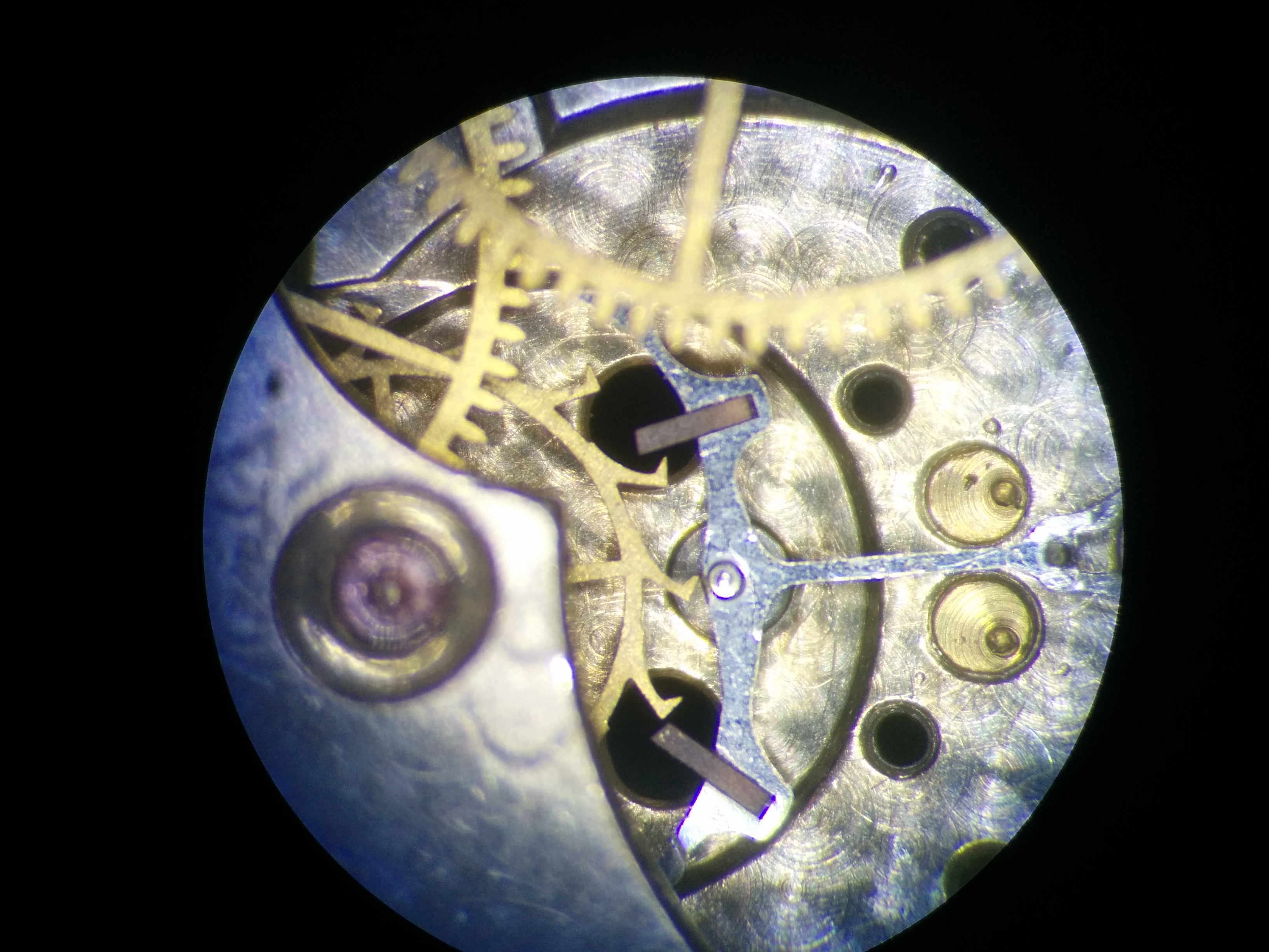

On further inspection I noticed that the escape wheel appears to be catching on the pallet fork in between the pallet jewels, as if the escape wheel and pallet fork axles are too close.

Looking at your pics it does seem that the pallets are too deep. But then why!!have you adjusted the guard pins. Anyway I have attached a web link that has animations of how the escapement should work.

While I can't know for sure if the escape wheel is original, comparing it side-by-side with the donor I don't see any differences that would lead me to believe the escape wheel is from a different movement.
Original on the left, donor on the right:

The escape wheel definitely seems to be engaging the middle of the pallet fork, even when the pallet fork bridge is installed. If I wait for the escape wheel to catch--with neither of the pallet jewels touching the escape wheel--and I move the pallet fork a bit, I can see it backdriving the escape wheel, so I know it's making contact somewhere. Through the pallet fork bridge jewel I can see an arm of the escape wheel that definitely looks like it's making contact with the middle of the pallet fork, so I'm pretty certain this is what's happening.

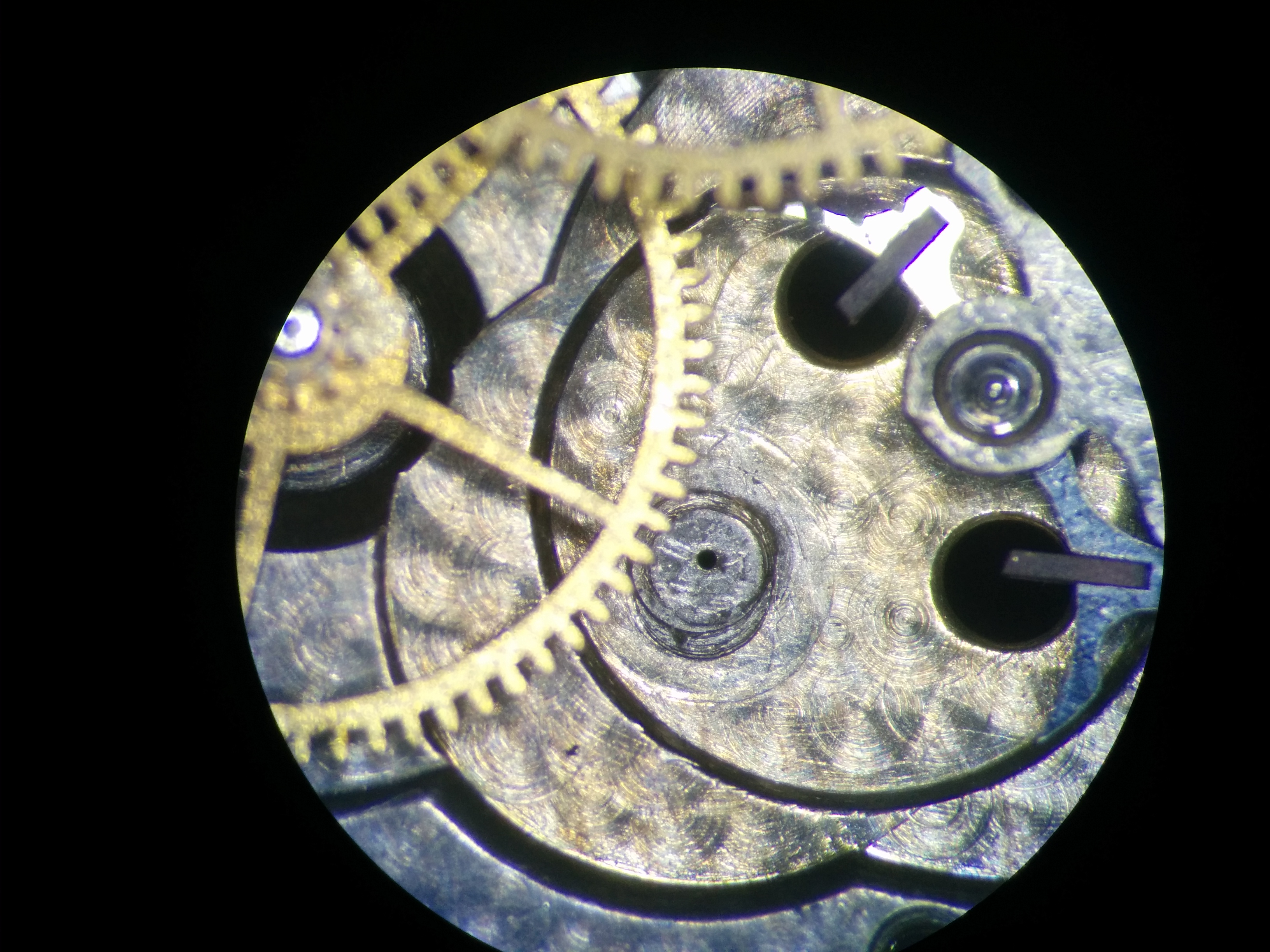

When I removed the escape wheel I noticed a set of witness marks around the lower pivot hole that are not present in the donor:
There are actually two sets: a bunch of very clear inner circular marks, and one or two light outer circular marks, maybe twice the diameter of the inner ones. Looks like maybe someone took a punch or staking tool to press down material that was binding? I really don't know, but the donor definitely does not have these marks, so someone had to futz with this one at some point in the past for some reason.
Filing down the middle of the pallet for seems like it would work, but I wanted to exhaust all other less-intrusive options first (which, I am admittedly running out of). What tools and setup would I use to do this? Is there a video somewhere showing this sort of operation?
Only other thing I can think of would be to adjust the guard pins, but I don't see how that would help....though I admit I'm not super clear on their purpose.

It looks like the pivot hole in the main plate is not jewelled. Is it possible that the witness marks you can see are due to a worn bearing that has been rebushed? In which case is the height of the bush correct? If it is too low then is it possible to raise the bush slightly using a jewelling press so that the fork clears the escape wheel teeth without compromising the relationship between the pallet jewels and the escape wheel teeth? Also check what this would do to end shake.

So this is the problem. The hole in the mainplate is not where it should be. It is shifted towards the pallet fork and from the second wheel. The problem here is not just stated in the OP, but the ascape wheel is not upright and the gear teeth are also far, maybe just engaging.
The solution is not that easy. You have to measure the proper hole distance from the pallet fork AND from the second wheel WITH a depthing tool. After that mount the mainplate on the lathe and drill a new hole. You can add a jewel or bushing thereafter.

There are many punch marks around that lower pivot hole so it is hard to see if the hole is out of position, slthough that feels like a good line of investigation?
Does the escape wheel sit upright in the movement? The upper pivot hole is jewelled and the jewel appears concentric with the recess in the bridge, so this should be a good guide. If the lower hole is offest and you don’t have a depthing tool, you may be able to plug it and re-establish the hole position in a pillar drill or on a lathe if you can clamp the mainplate in position, centre on the jewel, then remove the bridge without moving the mainplate before drilling through.
