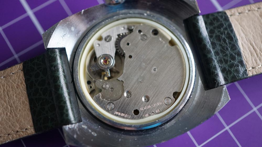

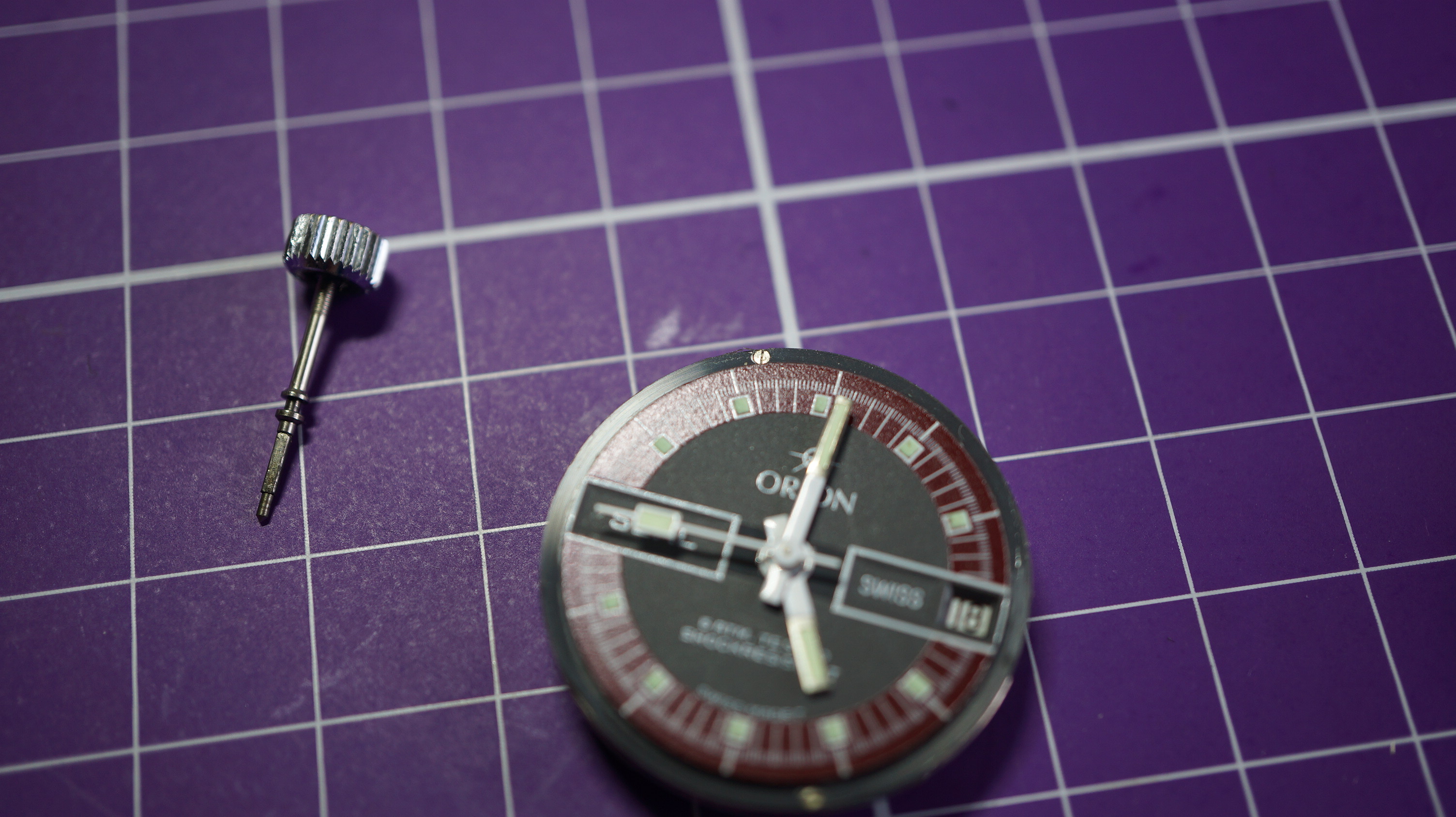

Have a pin lever movement that i can't figure out what it is?  Only 1 jewel. Broken hairspring stud and tangled up hairspring. Little other dial attachment them normal. More like a stopwatch? Has date function. DSC09150.thumb.JPG.7909964692e57198b1e58ad0db1b998d.JPGDSC09151.thumb.JPG.2fc94289fb3d339b1d49a33ffa0b73a9.JPG
Always amazed at pin levers its the sort of thing we used to run around the playground wearing as kids in the 70's cheap as chips yet they run for years.
The problem you will have is that calibre of Brac has no jewels to support the pivots and wear will almost certainly cause issues. Remarkably these pin levers still run but don't expect great consistency with the positional readings.
