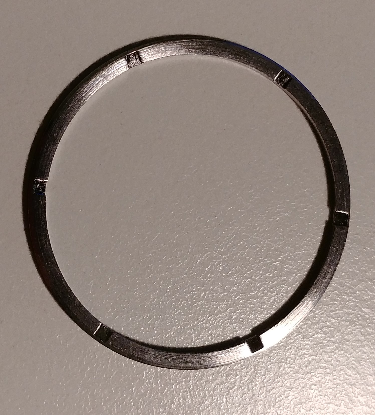

I would like it to fit a caseback ring like this one. It's hard to measure exactly, but the notches are about 1,50 mm. The elongated bits are square, so I might be able to modify them by filing off a small amount?
It certainly looks like they should work. The Horotec opener has not let me down as yet. I originally purchased it because I could not open a never opened  Rolex with a Chinese opener. However the Horotec just worked with hardly any effort. It also opens the largest Breitling's with no problems.

I usally open Vostok with my jaxa tool. And the smallest Bergeon bits. they never sit that hard. As that is part of the ything with this kind of diver. They have a very large gasket and caseback lid is like a compressor case. the deeper you go the harder the caseback should press on the gasket. For other watches i would like to have this kind of tool though.
I constantly use the Horotec and am also partial to Vostok so can confirm the case back jaws will not fit sufficiently to avoid slippage without some modification with a file.
