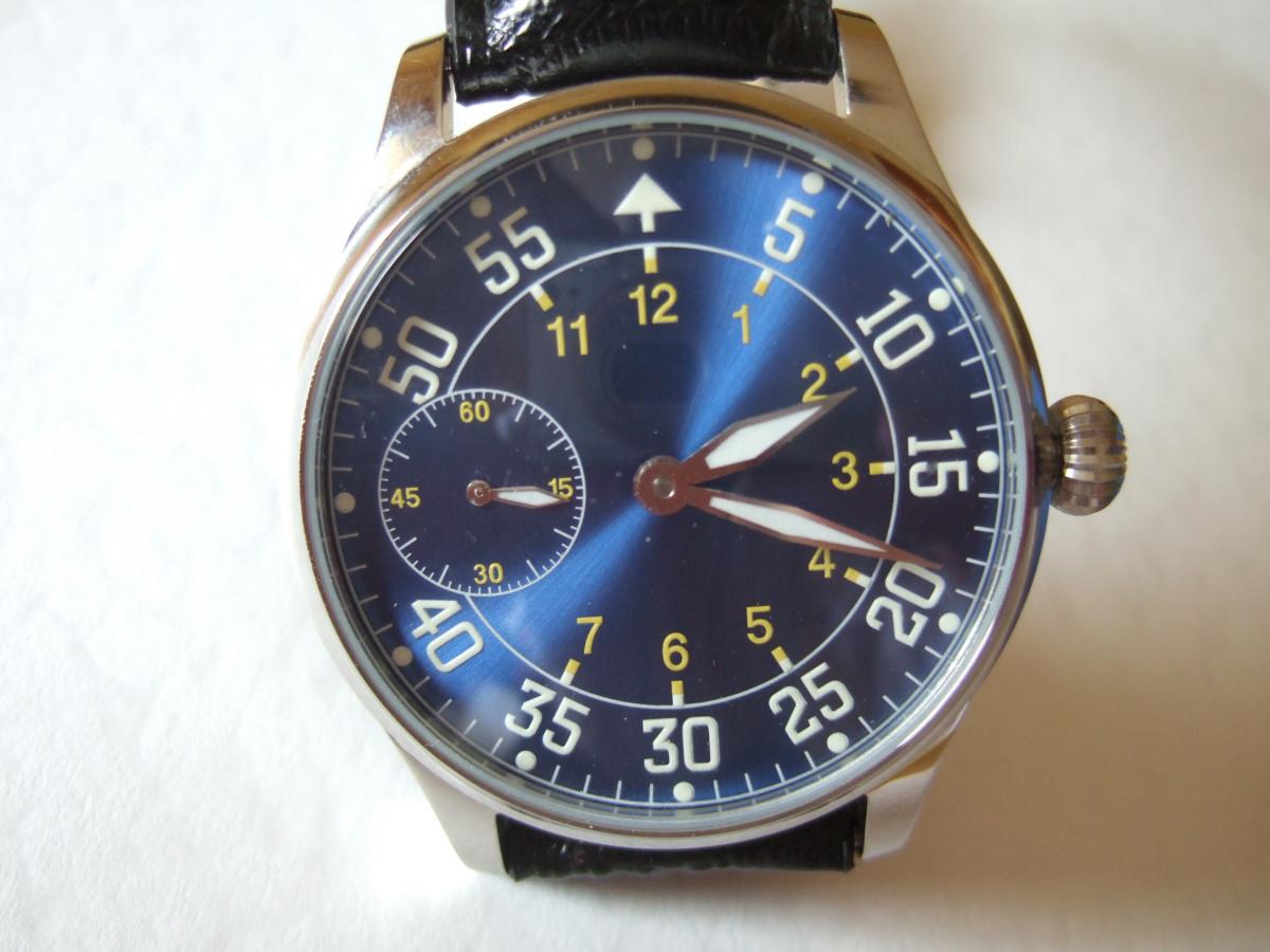

I did a similar project some time ago, but I was less adventurous than you and just bought complete movement, dial, hands, case and strap - all from Hong Kong. Here's the completed project:
Looks good Will. Is that a Chinese clone of Unitas?
Yup - a clone of a 6497 movement. About £45 compared with an ETA Swiss original, which would be around 4-5 times that, depending on where you shop.
