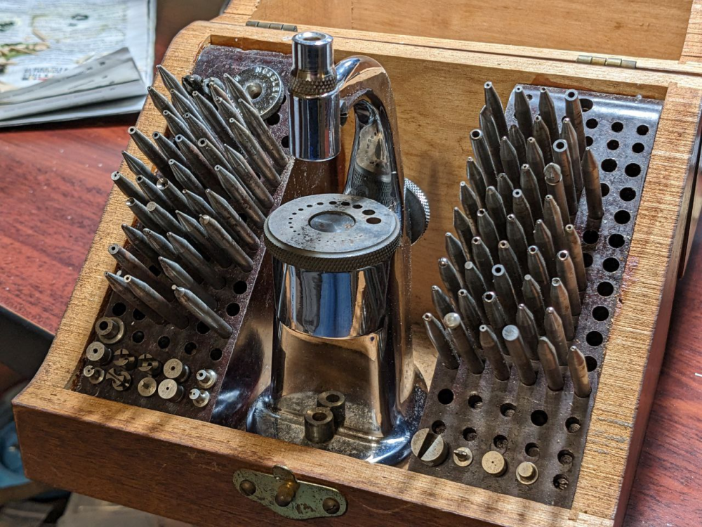

There appears to be some rust on the stakes. Easy fix. Clean them up with 1000 grit sandpaper.
What I do is chuck them on a drill motor an hold the sandpaper to the stake and spin! Don't chuck them too tight as to score them.
You could wrap some tape around them for protection.
was gonna try to take the whole thing apart and soak it and the stakes in evaporust and do a little light restoration.
9 minutes ago, Birbdad said:
evaporust
I don't know.  I would be very selective about what I put in evaporust.  I have never used it, but somewhere I saw a thread about caution.  Start with rubbing everything down using a cotton cloth soaked in wd40.  See what you get from that.  Do the stakes like I said earlier in this thread.  For the dia plate, I have done mild polishing with 2000 grit sandpaper, but frankly, that is not really necessary...it is only cosmetic.
Bottom, line...go slow.  You cannot undo what you do.
As others have said, be careful with Evaporust. I've had mixed results with it, and cosmetically parts don't look great after they've been sitting in it.
A fibreglass brush also works well on surface rust, followed by a high grit paper (I use up to 3000 grit), or fine wire wool.
Edited by SpringMangler
Emery cloth or emery sticks are best you can get different grit. If you have a lathe even better. After removing the rust wash out in petrol and wipe with a clean cloth. Make sure the stakes that have various holes in are clear and not clogged up.
I dropped my stakes in the ultrasonic with some evaporust. 6 minutes did no harm and got out all green dried out oil in the crevices. Some emory on the rustiest stumps- gone.
I’d concurr with soaking, however. The finish on parts I’ve soaked aren’t really the same afterwards…

Heya So the staking set arrived. The punches short of not having a full set and the thing itself appear to be in great condition and just need a bit of derusting. My concern however is that there's a good bit of play in the table on the thing yet the knob on the back does nothing and rotates a little less than 180 degrees.  I have a feeling this thing is so old there's probably stuff rusted and seized up on it and it just needs to be taken apart and derusted and oiled up in a few spots.  Here's a vid of the wobble on the table. https://www.dropbox.com/s/7k86sh2mcv0vdfo/PXL_20230401_024922606.mp4?dl=0 Turning the knob doesn't seem to do much of anything.  People more familiar with this, your input would be appreciated as i gotta leave this guy feedback or decide whether there's soemthing wrong with the thing. I assume it's an old tool that needs a little TLC.

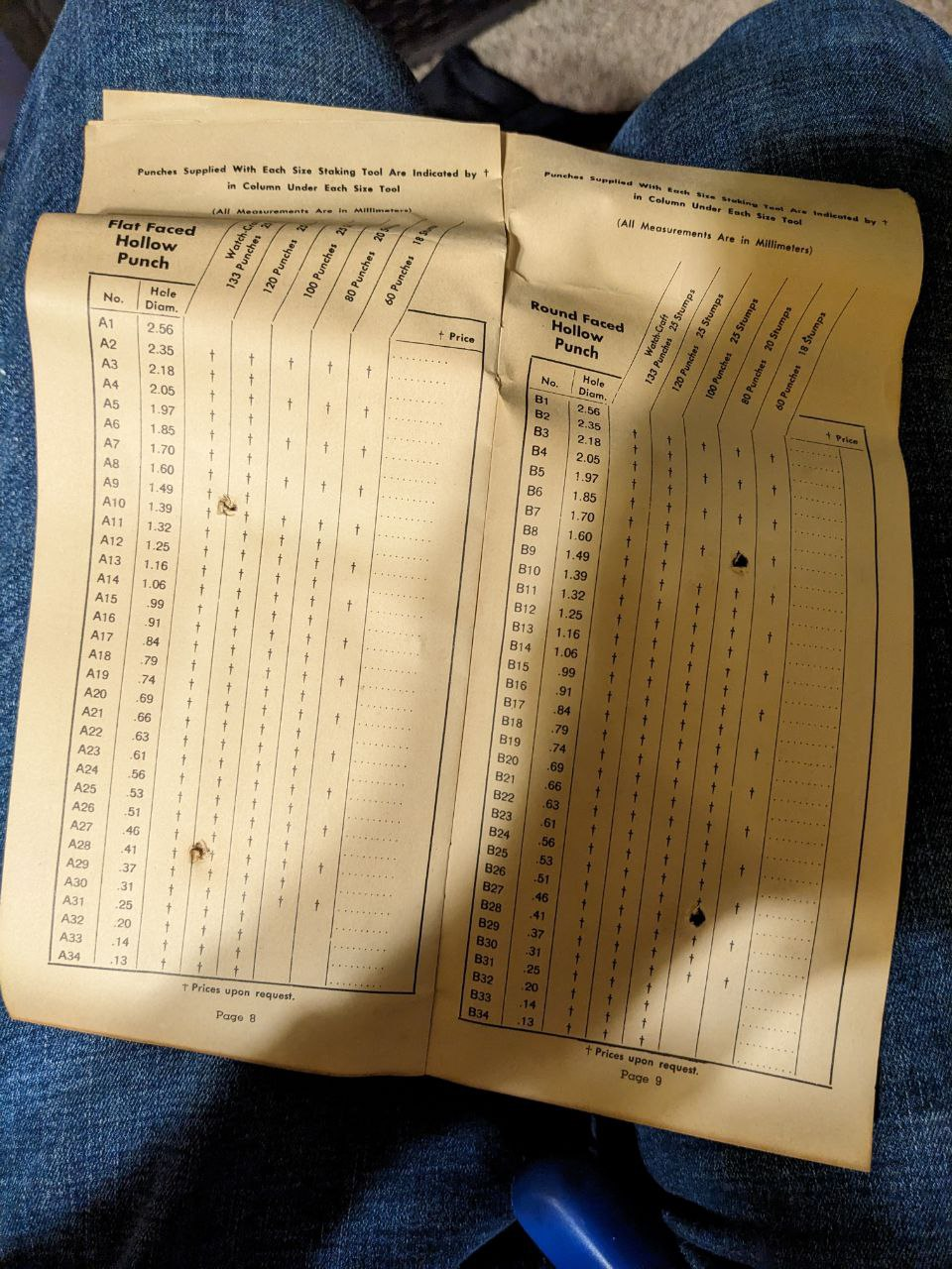

One neat little detail is that this came with the original booklet! It has a list of all the punches and the punches are all labeled so it should be real easy to complete this set and keep an eye out for deals on ebay.
