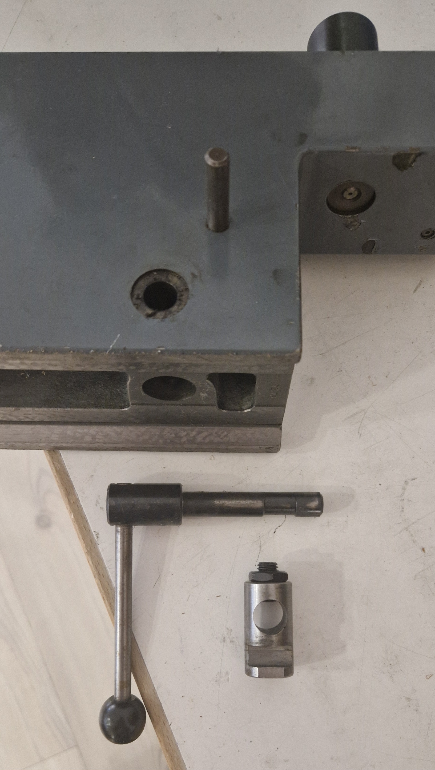

That it turns through an arc suggests an eccentric for sure. On many things that use an eccentric to clamp there is an adjustment; typically the part with the radial hole can either turn in relation to the piece getting clamped (the table here), screwing in or out, or, there will be a screw in the end of the shaft that the eccentric actually works on that can be screwed in or out. Once you get it apart it should be evident.
This is the eccentric clamp from my big lathe, with a screw for adjusting.
The second pic is from my small lathe, the "t" section is threaded and can screw closer or further from the hole, and is locked with an axial set screw.
These are eccentrics from lathes but the concept is the same. Not all eccentric setups have adjustment though; there you have to get creative...
