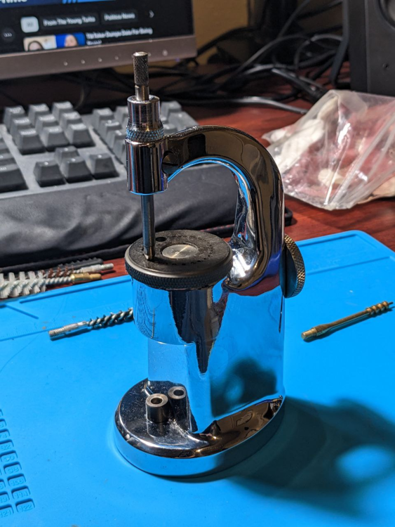

So, got the thing derusted and all put back together, thoroughly coated everything with breakfree which should keep it lubricated and inhibit rust for some time and i'm happy to say i have a perfectly working staking set!  People were very correct that yes, the evaporust on the top plate absolutely destroyed any semblance of a finish. I could pretty it up but eh, it's a tool. It's probably a century old and everything else looks great. Next i'll do the same treatment to the punches and start taking inventory. Very happy. I cannot wait to mess with it
So today i went to clean my stakes. Dipped them in evaporust for half a day, it got all the rust off and they looked fine if not pretty. LIke with other metal things i dont' want to rust i put them in the oven to dry them super quick so rust couldn't form and they came out COVERED in rust in just 15 minutes.
I would rather not mess with sandpaper as it would be so time consuming and i dont' want to reduce their diameter by even a little bit. ANy tips for how to dry them without rust forming so i can then cover them in some rust inhibiting oil?

Only guessing here but what fuel does your oven use.  If gas it produces a lot of water valour. Chemical reactions depend on temperature amongst other things, roughly for every 10C increase the reaction rate doubles.

I have cleaned many by chucking them in a drill motor and spinning while gripping wit 1000 grit sand paper.
I would wipe them down with a rag soaked in WD40, this will remove most of the rust and also provide a barrier to prevent the formation of new rust at the same time. WD40 should work as I assume the evaporust will have removed most of the old deeper rust and what formed after you used this is just a thin skin of surface rust. Worth a try.
It's an electric stove. I dry watch parts with a hairdryer to keep moving hot air going over them and iv'e never had rust....maybe i should try that.
Also they were touching each other, seems like those contact points got the most rust.
I'm hoping to avoid this. I Just don't want to reduce their width at all and tha twould be insanely time consuming with 80+ punches
1 minute ago, Waggy said:
I would wipe them down with a rag soaked in WD40, this will remove most of the rust and also provide a barrier to prevent the formation of new rust at the same time. WD40 should work as I assume the evaporust will have removed most of the old deeper rust and what formed after you used this is just a this skin of surface rust. Worth a try.
I'm using break free which is a good light oil and rust inhibator. That got most of the surface rust off but amazingly not all of it, Still some visible rust. I put them back in the evaporust for now.
I feel like there's gotta be an easy way to dry them  all without introducing new rust....You ahve to rinse of evaporust with water which of course runs the risk of just introducing new rust.
3 minutes ago, RichardHarris123 said:
Couldn't you just wipe with kitchen roll and oil straight away?
Would that get it dry enough? I thought for really high carbon steel it's gotta be moisture free basically. I could try i suppose
When they come out of the post evaporust water try dumping them in a tub of 90+% IPA. This should disperse the water and when you take them out the IPA will evaporate quickly.
Tom
hmm, the drug store sells 91% I could go pick some up if that's high enough. Good idea tho.
Tom
That's what I did with mine. Then wiped with Barricade wipes and for good measure I put a Bullfrog rust prevention strip on the inside of the case.
It is insane how fast these damn things rust. I pulled them out of the water to quickly dry them one by one and then oil them. By the time i got to the last 10 to oil they were already rusting up and had to go back into the evaporust which did a great job but still. I now got them inventoried, wd40'd and derusted finally.

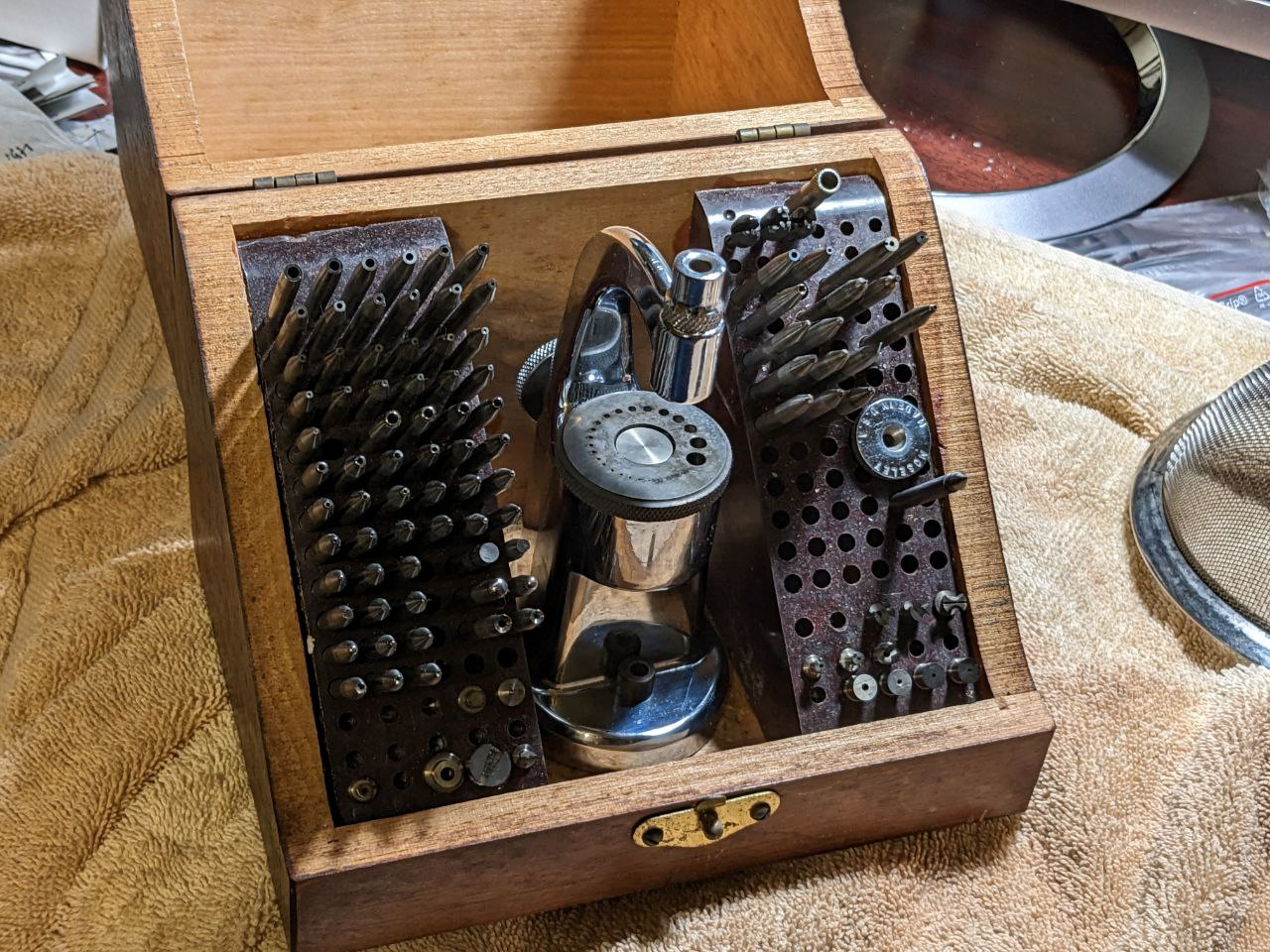

So this is what i got. THe only thing not listed in this documentation is the balance staff pullers of which i got 3 sizes and a weird disc which i assume i will figure out how to use at some point.
I would like to flesh out this set but i'm just wondering if theres a lot of these i just would never need and if there's some missing stuff i will absolutely need. It appears this is a complete set (minus one that broke) of one of marshall's smaller sets that wasn't totally complete. Wonder what people's thoughts are on the usefulness of what i got here?
Also i will scan the original documentation that came with this and post it here this week.

Why don't you use some anti rust paper? Just put it in the staking set. Why on earth did you put parts in an oven God only knows. You should have washed them out in petrol and dried them in fine sawdust,  blow all the sawdust away with a blower in the holes and brushed them of with a bench brush, then wiped them over in a clean oily  rag.  The rust remover you used I have never heard of it. The best way is to use a fine enemy stick or cloth in a lathe, removing rust and dirt this way will not alter the diameter of the punches, they will still fit well in the staking tool.
I do it for the same reason so many people dry watch parts and things that rust with extended moisture contact with a bit of heat. Usually if they're bone dry in a few minutes there's no time for rust to even form. I've never had rust collect on anything using this method till now.
It seems like theres probably an easier method then tracking down gasoline and sawdust.
Evaporust is very popular and it's pretty good on the right stuff. IT does remove rust and it's totally non toxic and safe for metal. I ended up having to dunk them in it a couple times as they would literally rust in minutes before i could even dry them or oil them. I then wiped them down with wd40 and all seems to be well.
Even did my first stake tool repair. Fixed the sloppy rotor to the vintage seiko i just repaired.
There's something sorta amazing about working on an old watchmakers probably 100 year old tool that he clearly took great care of.
Edited by Birbdad
